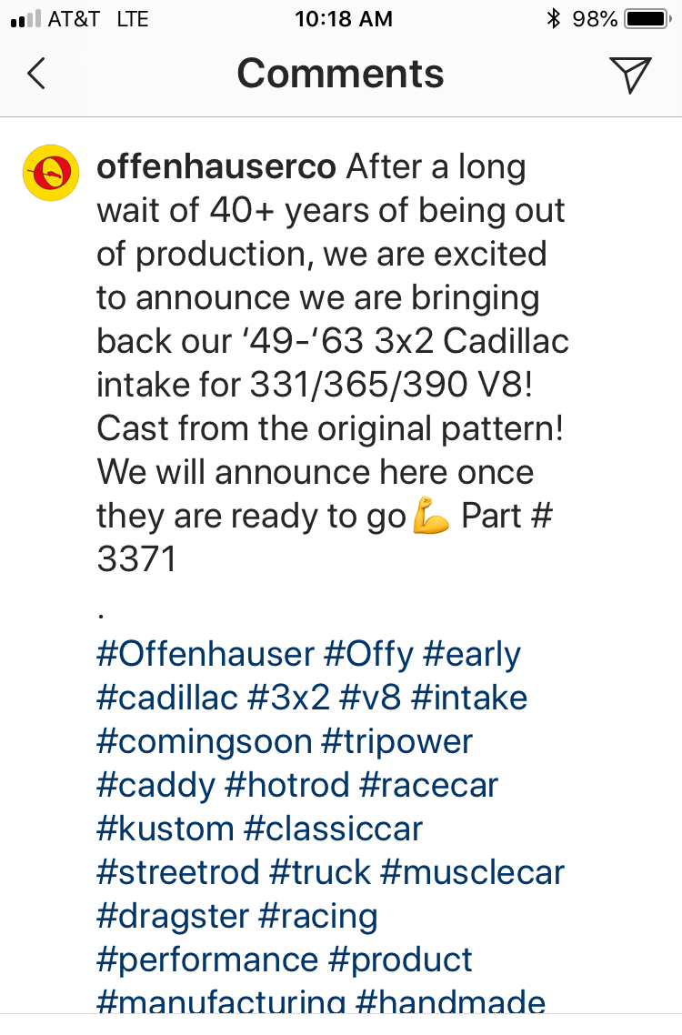

    E75C5185-190B-4E5E-B16A-5153CB53771D.jpeg Got some good news tonight from Offy.

    I saw that,,,,so stoked!

    That’s gonna kill the holy grail collectors and eBay profiteers.
    I’ve been holding off taking the 390 to the machine shop, because I thought they would never actually finish. I bet they are glad to go to production, just so I will shut up.

    I doubt it. I think the Offy is the best looking 3x2 ever made for any engine.
