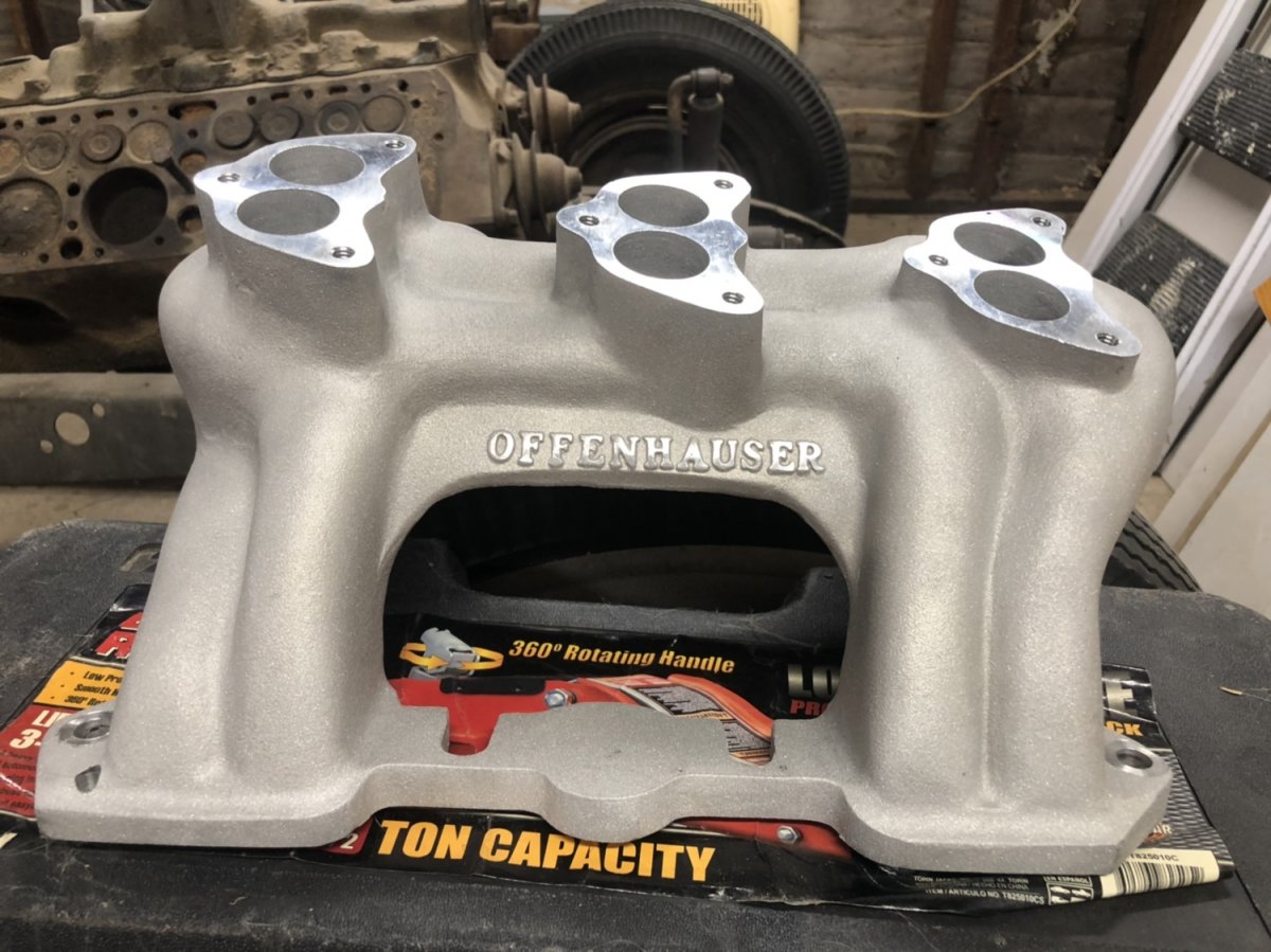

    Just got my new intake in the mail today from White Owl. I’m pretty excited so I thought I’d show off a bit. [emoji3] IMG_5366.JPG

    Looks like a nice casting.

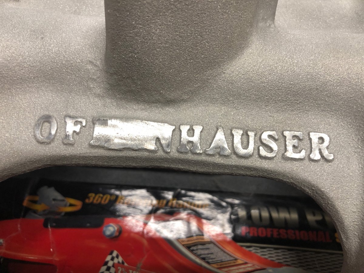

    The casting looks good. The only bummer is the messed up the offenhauser name on the other side and then ground part of the name. I might be able to turn it into just Offy IMG_0001.JPG

    Mines getting a full polish anyway. No free advertising

    Offy contacted me here on the H.A.M.B.
    and made good on the poor casting. It’s always a pleasure to deal with professional people who care about their products and their customers. I am impressed.
