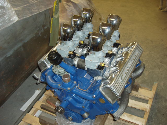

    Frames

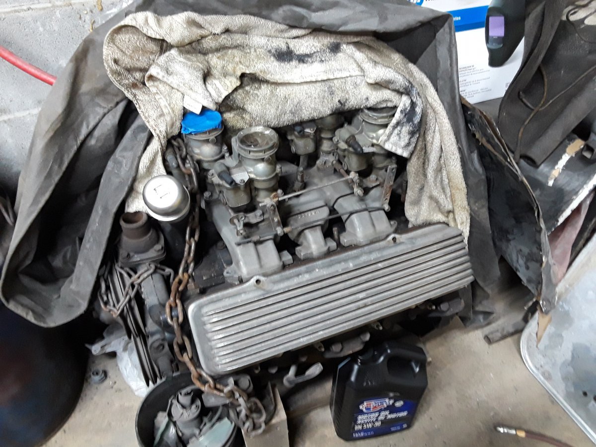

    just showing of my full race 3 CADILLAC ENGINES-V-8 WINTERS 004.JPG 65 going into a 32 roadster. I will be using an aluminum 3 plus 4th OD F150 trans.

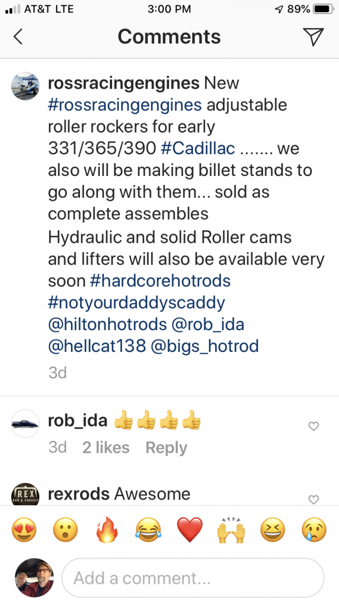

    They suggested going to an adjustable rocker, which I am doing anyway. I'll probably go to a custom length pushrod with a small oiling hole to help lube the pivot ball.

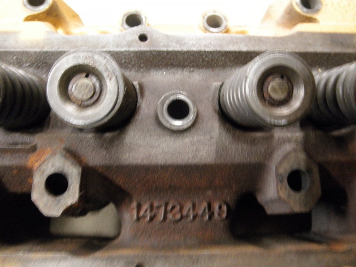

    Here's a question for you guys, what year do the rocker arm shaft pedestal mounts interchange? It appears 49-54, 55 is by itself, and 56-up are the main types. I see they look different, but would they interchange if it's all you had? It appears the rocker shaft itself is the same.

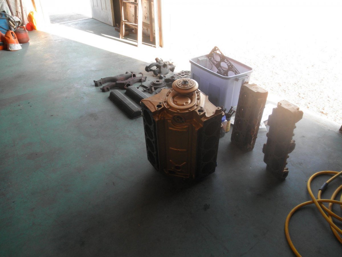

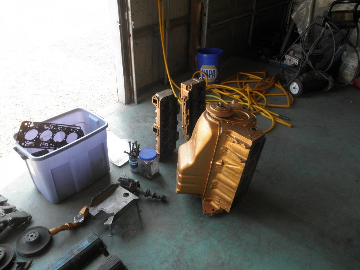

    I'm working on a 1955 331, when I was torquing the heads down I had one split in half. Of course from everything I've read it's one year only, but that doesn't necessarily mean that another year wouldn't work, maybe it just looks different.

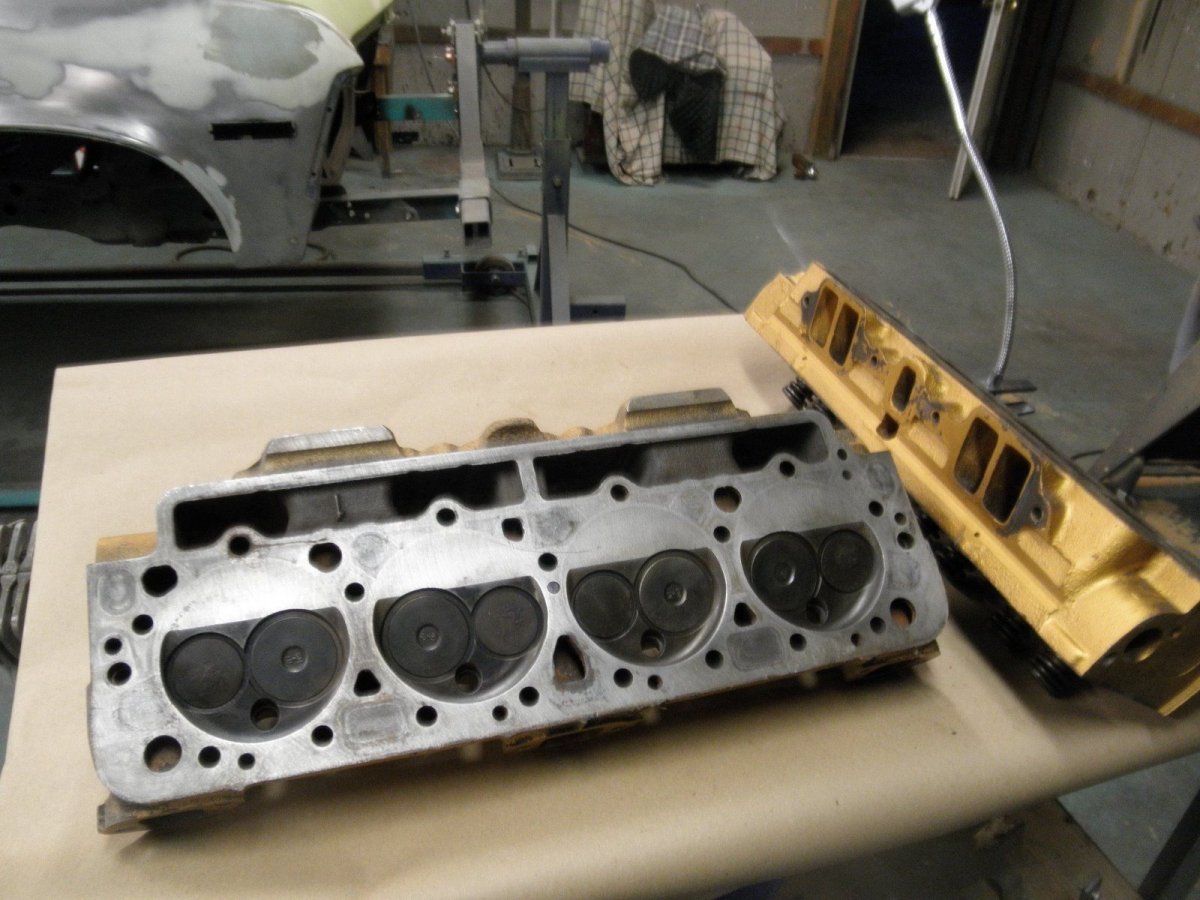

  15. Torkwrench
    Joined: Jan 28, 2005
    Posts: 2,770
    Torkwrench
    WOW!!!
    I've been collecting parts for my early Caddy, for quite awhile. Adjustable rockers are at the top of the list.
    Originally I was building an extended bell 331. However, a 390 showed up about a year ago, so now I have to find a different trans. adapter. Seem to remember seeing one that adapted a Chevy bell housing, starter and flywheel, but can't remember what the company was???
    loudbang, 31hotrodguy and warbird1 like this.
