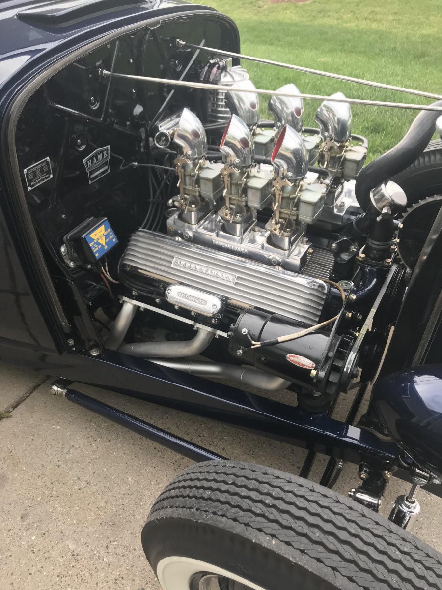

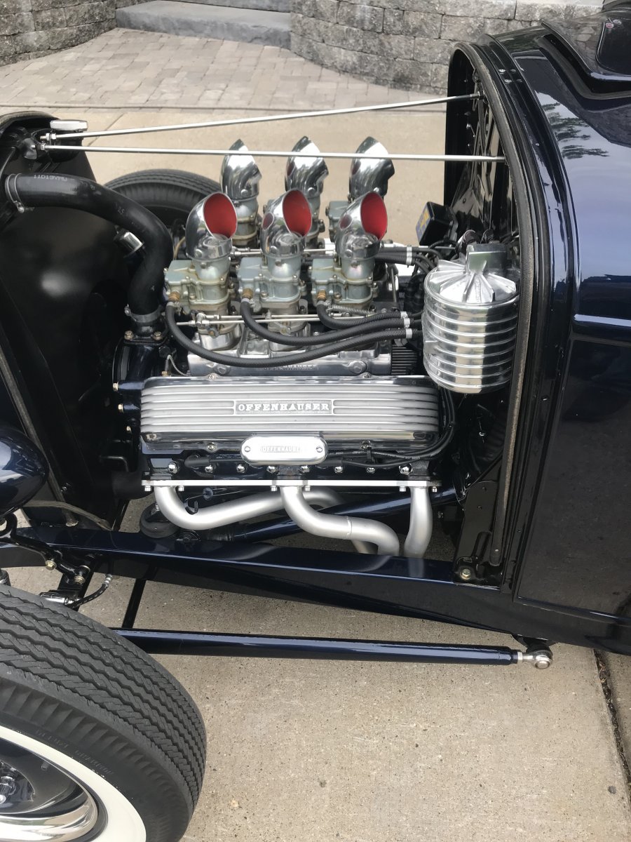

    hotrod_grmi
    D5DE0728-D2BE-4589-826E-94D2143AADB6.png 9919AB97-87E0-449F-ACDB-FF5FB19FE712.jpeg 1EC40E01-82F8-4316-982C-CAB1DF722B29.jpeg Asking what’s normal for oil pressure on a ’61 390. Since built, oil pressure warm is never over 25 psi at any rpm and cold on start up 15 psi at 1000rpm. Use 20-50 Brad Penn with WIX filter
    With 8200 miles on it now running in my deuce and don’t baby it, engine super runs strong, runs quite except for the sold lifter clatter. Should note this race inspired 390 +.060 engine dyno’d at 436hp @5200 rpm and 449ft/# torque @ 3900rpm. The oil pump was rebuilt with new components from Egge, stock 5 qt oil pan and pickup.
    Clearances: Mains 0.0024. Rods. 0.0021, Rod side clear .011-012. Crank end play .004.
    I am curious to know if by removing the oil filter adapter then tapping the block to accept remote oil lines to a Hildebrandt remote filter mounted on the firewall would have anything to do with the low pressure and was wondering if maybe a restrictor would help. Does anyone know if a restrictor should be used or not, then any others possible reasons why the 25 psi pressure. Have been told by others these engines normally carry 30 to 35 psi.

    Manual indicates 15 psi at idle, 30-35 at 30mph, relief valve opens at 35 psi. I have same motor with stock filter adapter, my cheapo oil pressure gauge never went above 25 either. Tried a different gauge got a higher reading, but not quite 35. I decided that the gauges were inaccurate, and both of their highest readings in reality were about 35 psi. Try another gauge?
