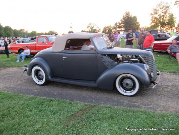

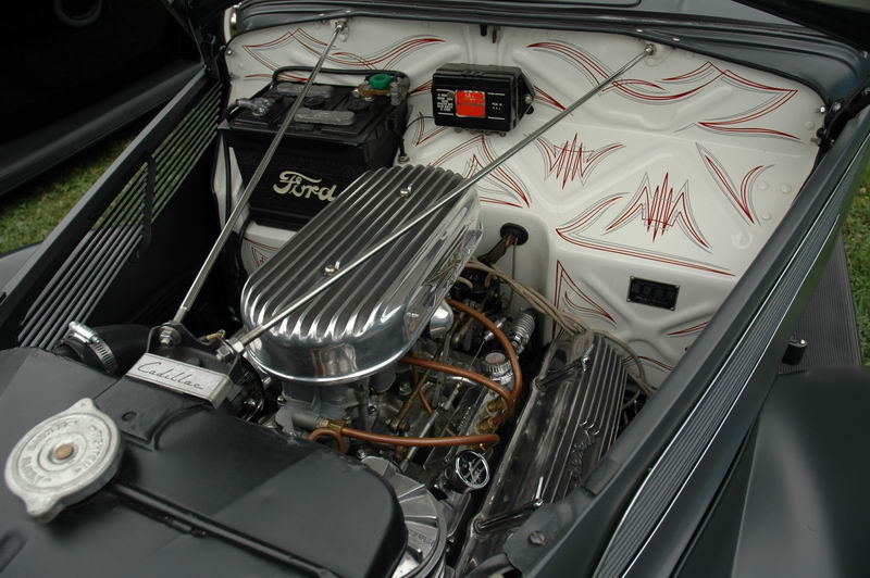

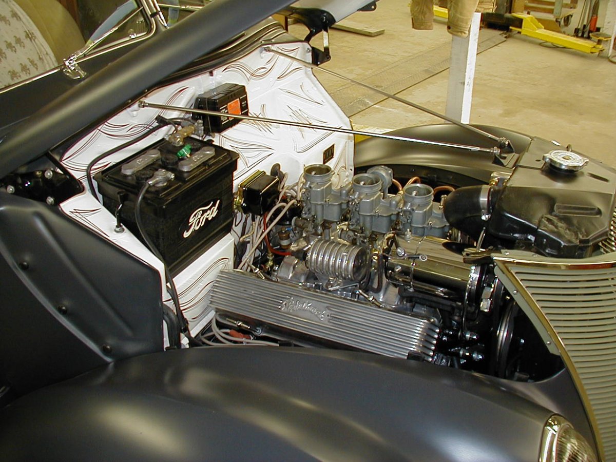

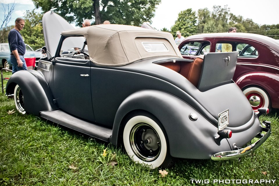

    37 At Old Timers.jpg 37 at mark\'s.jpg Cad in 37.JPG Engine at Ty-Rods.jpg Hello,
    Been running my 37Cabriolet with the 365 with Isky roller, Mallory Magspark, Crager 3 x 2, Edelbrock covers and
    a T-5 with 8" Ford. Drive the **** out of it with 23mpg on trips. Had to have Isky regrind the cam as I lost a lifter. Also Jahns pistons and isky adjustable arms. All parts are old original and were raced in a 40 coupe back in the day.
    Any questions as I have all the old specs.
    Skip

    I never knew cragar made a 3x2 manifold for a caddy, I would like to see a pic of that

    Sorry, I't a Edelbrock 3 X2. Polished clean back in the day. Anyone have a single Edelbrock valve cover for sale?
