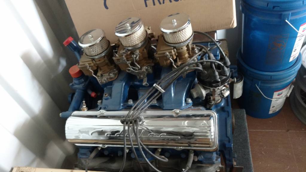

    Picked up some additional Caddy parts. I had a fresh 331 that I had picked up at a fire sale but I got wind of... and I had to have more cubic inches after following your thread. So additional parts pictured... IMG_20200406_132620235.jpeg
    It appears that the carburetors have the correct bases...got to look past the air cleaners. It has a DuCoil dizzy.

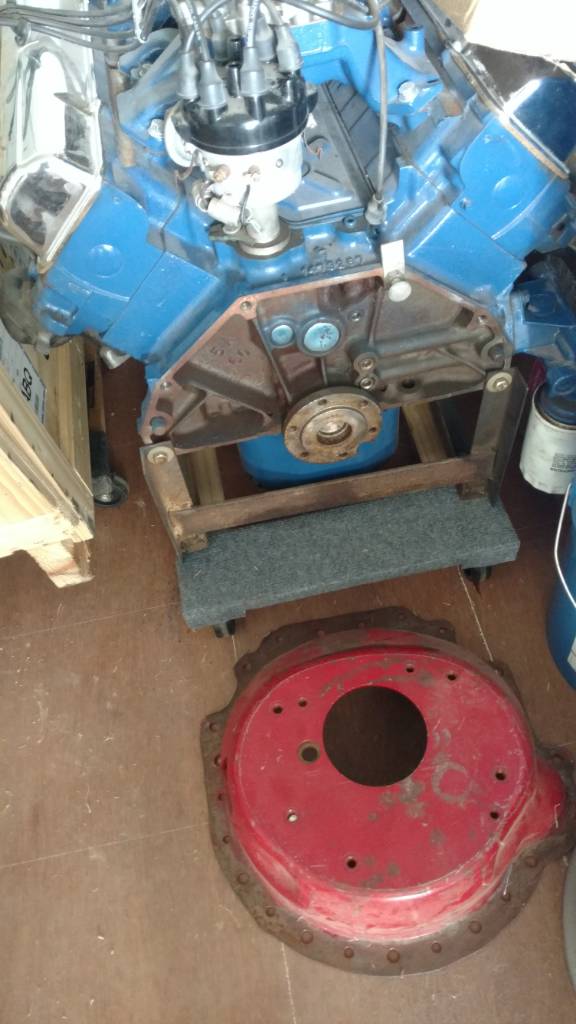

    It's a 61 block with the K on the motor number so it could have been a commercial set up as it has room in the crank for a pilot bearing. IMG_20200406_144238840.jpeg
    It also came with this....no marking as to maker but fits the back of the engine. No flywheel, I am in the market, I don't know the internal build but it is a zero hour rebuild and came from a racer who is now racing in the afterlife. Now I've got to find the car for the motor...I have a line on a cherry '33, 2 dr
