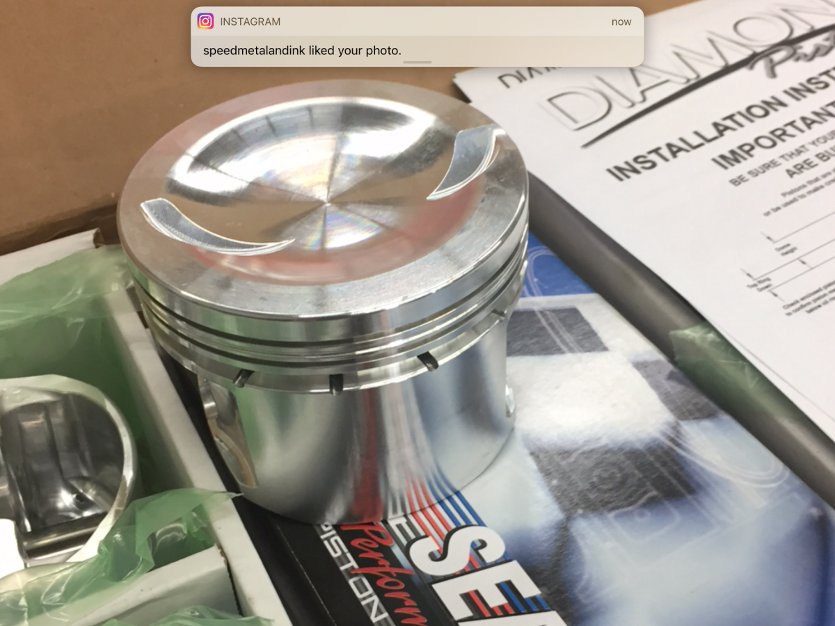

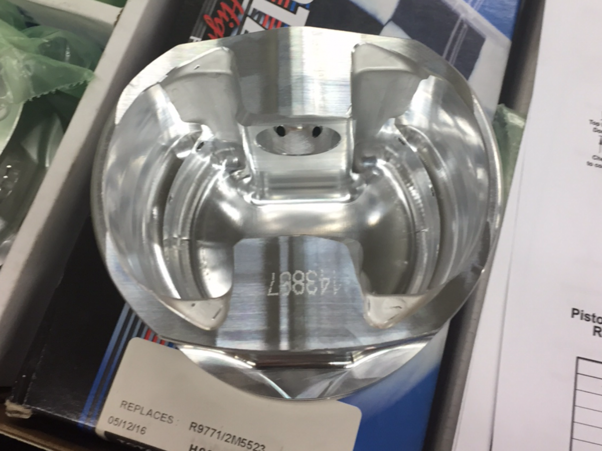

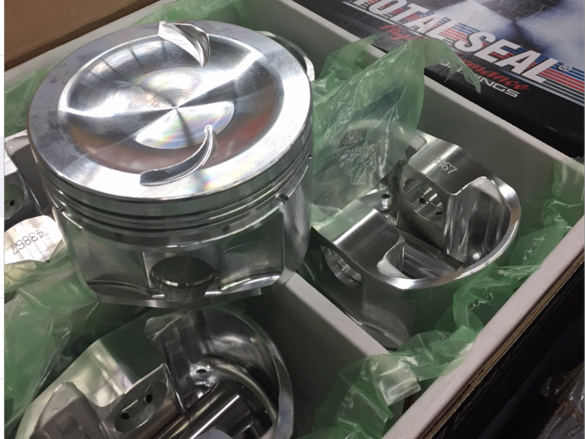

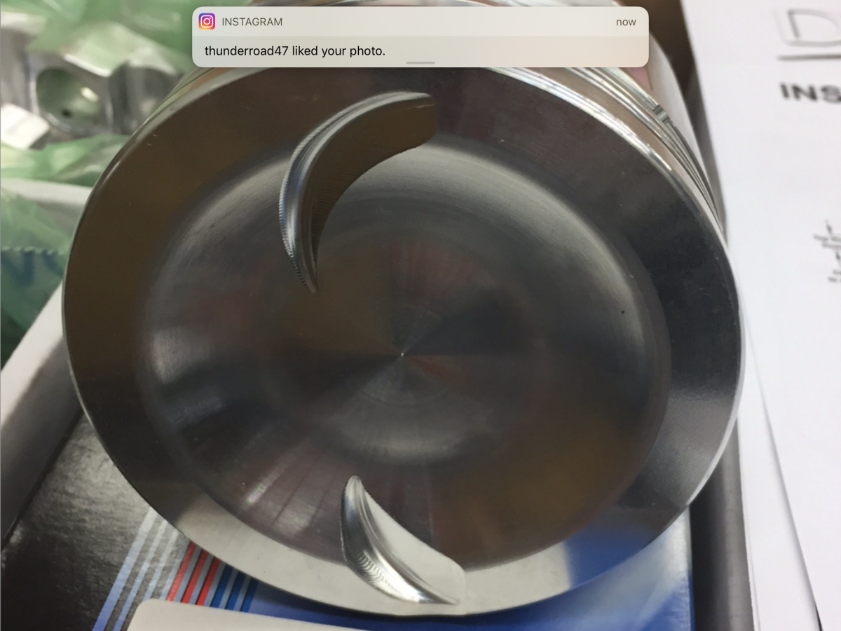

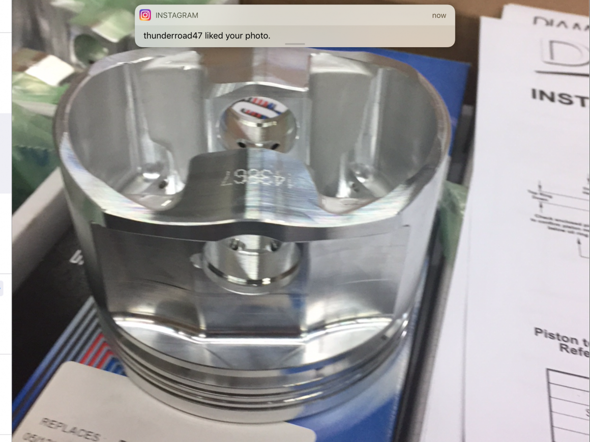

    127358CA-5F52-4902-9CA9-09C058E407E0.png 87CB86AF-6203-42E0-859B-418A7AE03FF7.png EFBBC3DF-C665-4BB4-B970-B2D74C81CA0A.png B7E4669E-656E-44B9-8675-EA7A6D190BE6.png 29B0EA79-01D1-4088-A531-499DBD602362.png Here are the Diamond Racing Forged pistons I had made for my 390.

  19. Roothawg
    Joined: Mar 14, 2001
    Posts: 25,960
    Roothawg
    You could sell at least 5.
  20. Roothawg
    Posts: 25,960
    Roothawg
    What was the final compression ratio? Wonder if they could use their previous specs and build more sets? Also, why offset grind the crank, make new pistons and use the stock rods? This puzzles me. If you had to make new pistons, why not take advantage of the increased stroke? In essence, did you just move the pin height up?
  21. hotrod_grmi
    Joined: Feb 3, 2008
    Posts: 160
    hotrod_grmi
    Has 9.6 cr, pin height was moved up. Had these pistons made for running a blower setup.
    31hotrodguy, loudbang and winduptoy like this.
  22. Roothawg
    Posts: 25,960
    Roothawg
    OK, gotcha.
