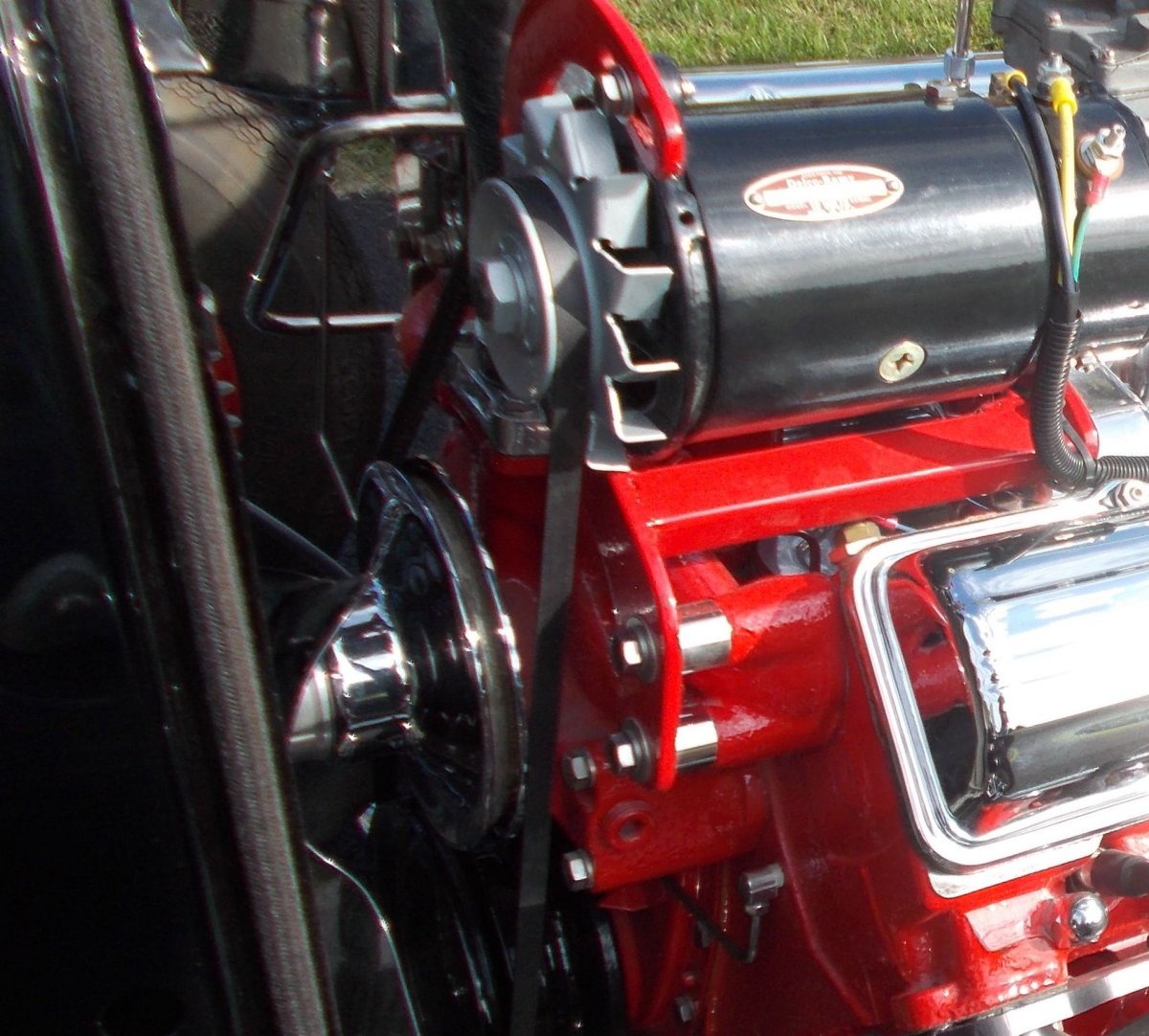

    Thought this might help someone. Long ago I looked on the HAMB for information on what water pump pulley to use on my '57 Cadillac engine. Found nothing. So I'll share what I found. genpull.jpg ECG-H is what I used. With this number easy to find. Ron
