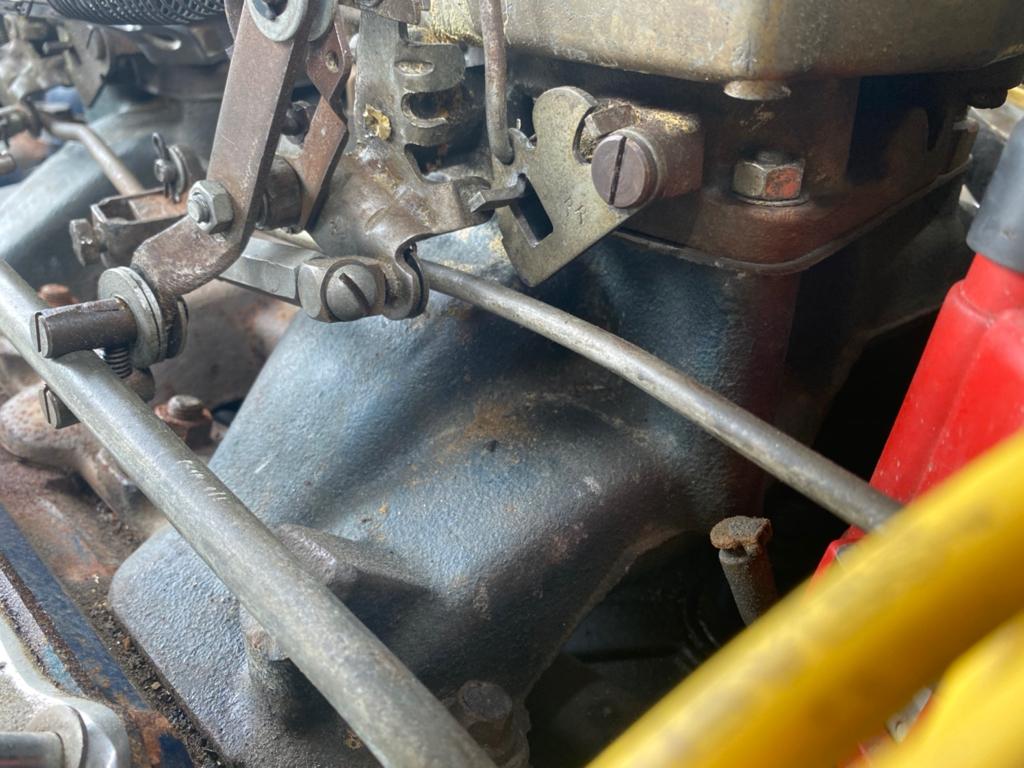

    They are not progressive. This is a stock linkage for the ‘56 Eldo Rochester 2x4. Just threaded rod. I popped in electric chokes from ebay, super cheap, they work great. I want to eventually switch to manual chokes, also available on the Bay. My engine bay does look like **** tho’ , I like Mad Max more than Chip Foose. You may want more polished stuff, of course.
    I got this dual quad set up on Ebay a few years ago for a few hundred bucks. Proper carbs and linkages, but the carbs were both frozen and missing pieces, including the chokes and other stuff. I grabbed a bunch of ****ty cores from the Bay, managed to wiggle the shafts free, and get this working really well. It happens to be Rochester rather than Carter. But I like Rochesters and messing around with tuning, it really brings the 390 to life. For real.

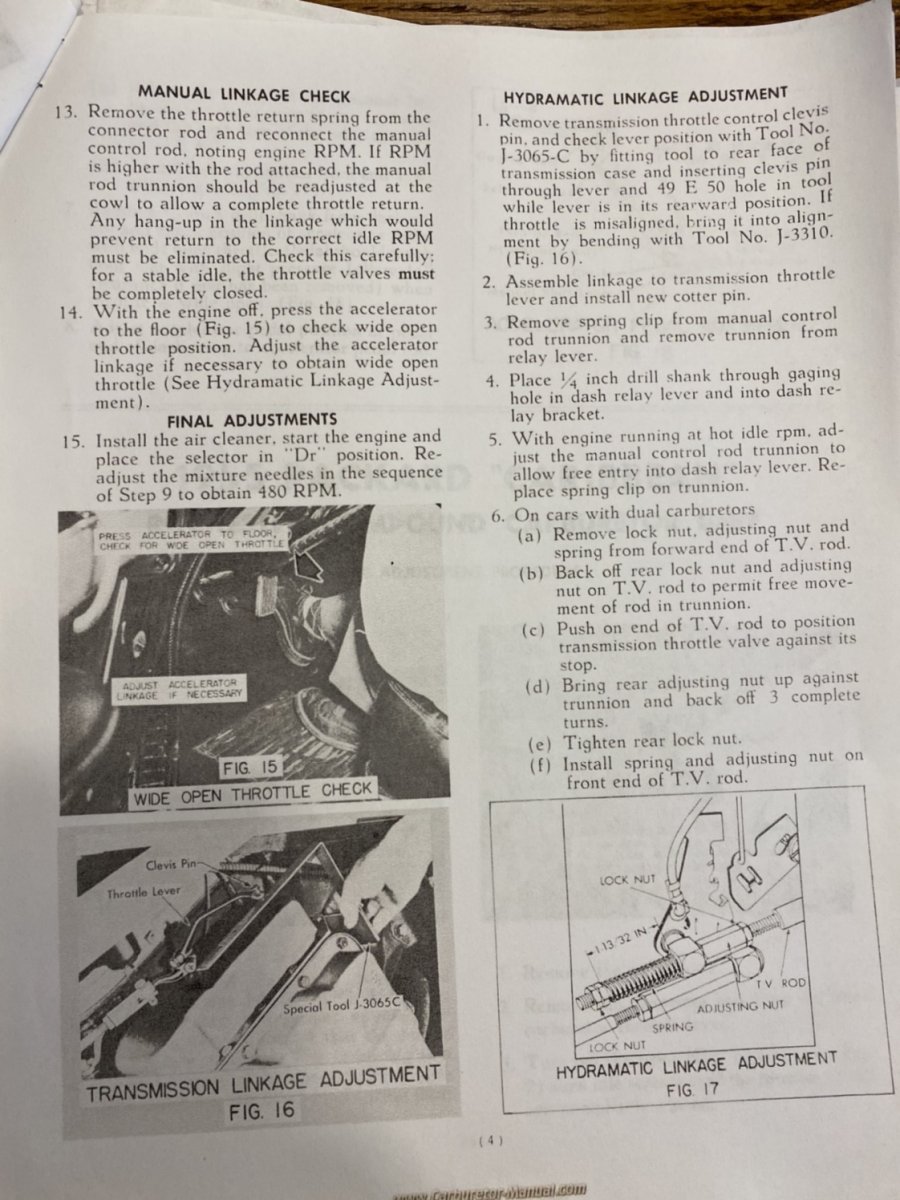

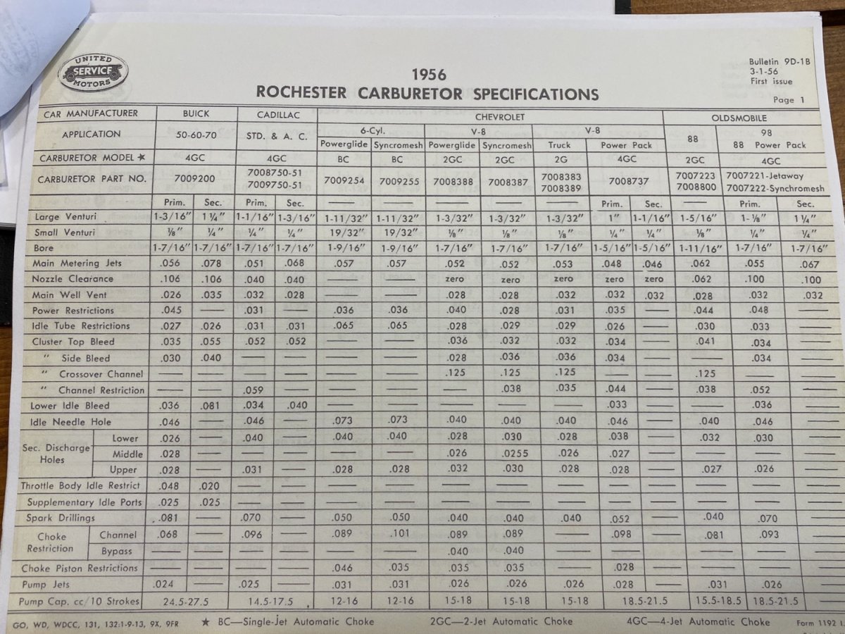

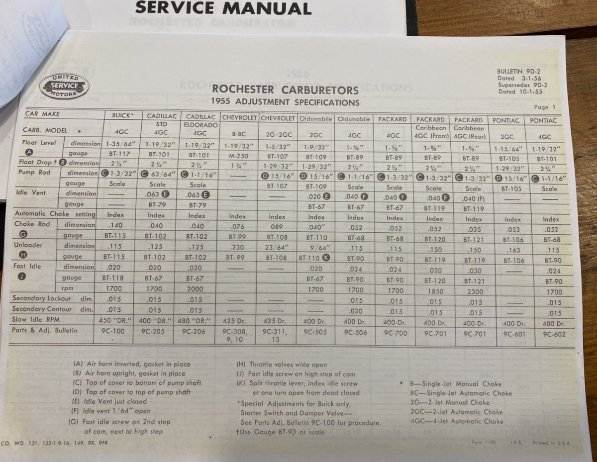

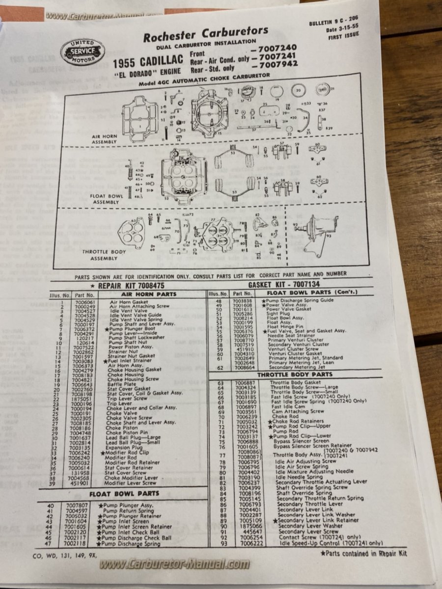

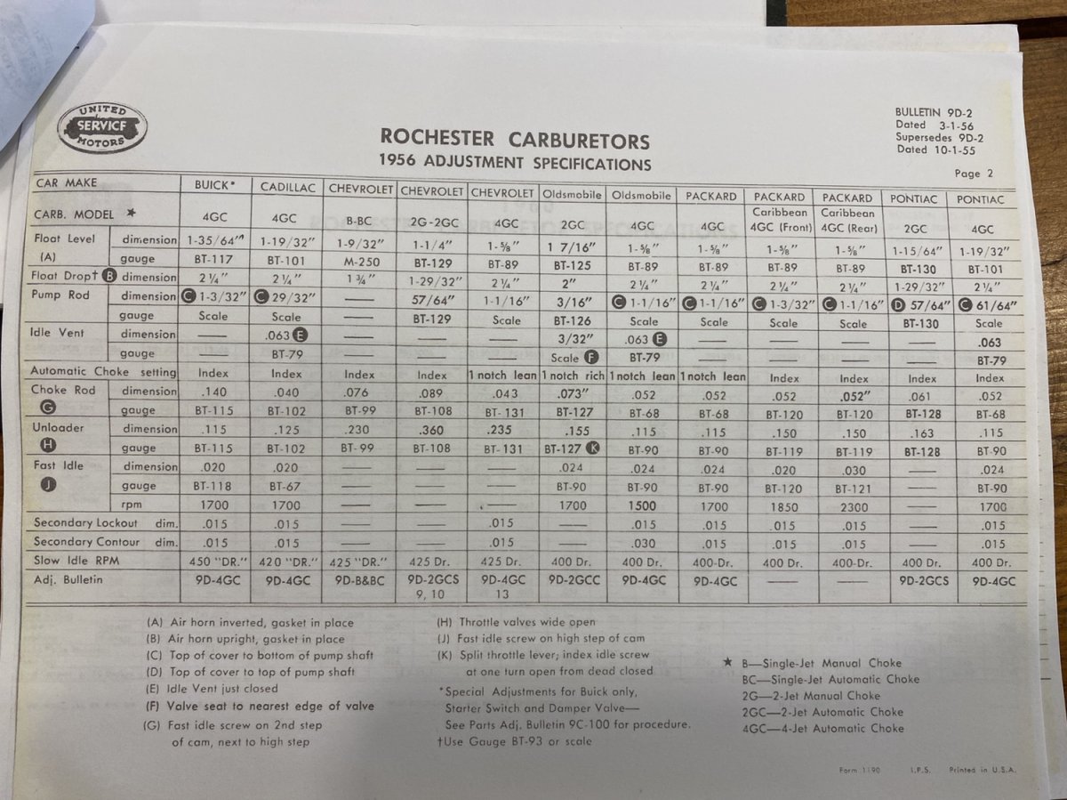

    Also, I bought this online years ago. It may or may not be of use for someone dealing with Carters, but it may be useful for someone dealing with Rochesters, so I will put it here in this thread, which would be the likeliest place it might help someone. IMG_0577.JPG IMG_0578.JPG IMG_0579.JPG IMG_0580.JPG IMG_0581.JPG

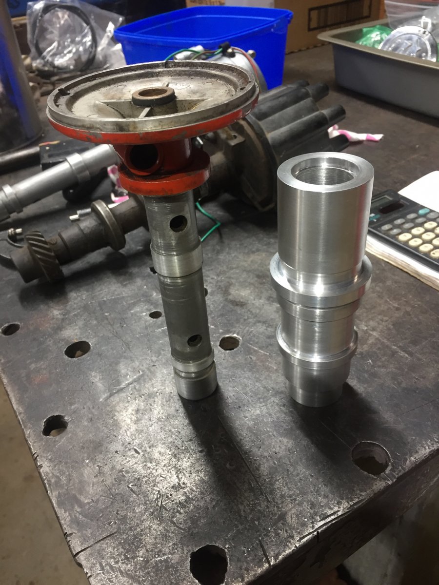

    Hey guys, I have been digging through the archives looking for a tech piece where a guy took a distributor out of something like a an Olds and machined the housing to ft a Caddy. Anyone remember that?

    Small Block Chevy Magneto, tach drive type. The metal shaft type like a Ronco/Vertex/Scintilla. Then I just machined a base using the original Cad for dimension. Then cut the Chevy one to length and to accept the Cad gear and pump drive. Tigged the two pieces together and the rest is shocking history. Cheapest Cad Mag ever made. Even Tom Cirrelo liked it when he recharged it.
    Just remember to hone the bushing as it gets a little tight after welding.

  14. Hi Roothawg, I didn’t do that but machined a sleeve to adapt a SBC Spalding flamethrower to fit a Cad, what are you looking for info wise?

    I don't know if it's mine you're talking about but I posted a couple of pictures years ago of the dizzy I machined for my 390. I started off with a summit 2 piece Ford unit, I can't remember if it was a 351C or W and machined a whole new stanchion for it, the top part just bolts on as the summit unit, I bored the Cad gear to match the shaft and redrilled the shaft for the pin.

    How would these work? Is it because it's a magneto? Cadillac spins the opposite way of small block Chevy. I was talking to a guy on instagram who machined an adapter ring to use an Olds 303-324 distributor, its a little easier to find a Mallory for one of those, but he was pretty cryptic on what was actually involved or wanting to sell any parts.

  17. F3B9BE02-AAE5-4C06-9428-CE04BE043ECB.jpeg The Spalding is a distributor, I just had to change rotation of it,machine a sleeve to fit the Cad block. I machined the Chev diameter down slightly and sweat it on with a bit of heat.
    As the shaft diameter was the same,just shorten it and drill for the drive pin.

    I don't remember who it was, but it was an actual thread on it. It may have been ChrisP. I was just surfing the web looking for Caddy Magnetos and they are hard to come by, so I thought about trying to find something that was close and modifying. I don't have to use a mag. I just don't really want the mag look alike HEI. That's really the only option for new, that's out there.

    It was originally ordered for a Pantera but not used, I can't remember if it's because the car had a 351 Windsor or the guy ordered a Windsor dizzy. I just recall it was rotating in the same direction as the Cad, the size was about right and easy to modify. That was 7 years ago and I'm not getting any younger...

  21. Beautiful work there, completely new housing, makes mine look agricultural.

    It works, but when I sent it to get recharged I asked Tom to change the cam lobe for Cadillac. The magneto doesn't care which direction it spins

    Thank you, but the summit design is a 2 piece design, so I only had to machine a new lower part just below the head so it's really easy, think about it, I'm a bodyman not a machinist and I have 0 training in the trade.

  24. When I did mine, I couldn’t machine it down to original size as it had to take the sbc housing. Nice job you did though, you sound as if you have the same machining experience as I have.
