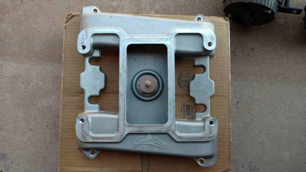

    Is that the new Gear Drive manifold?

    He makes nice stuff.

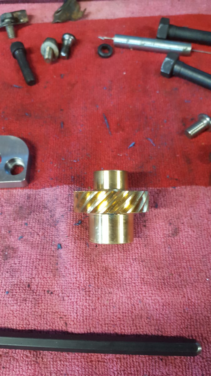

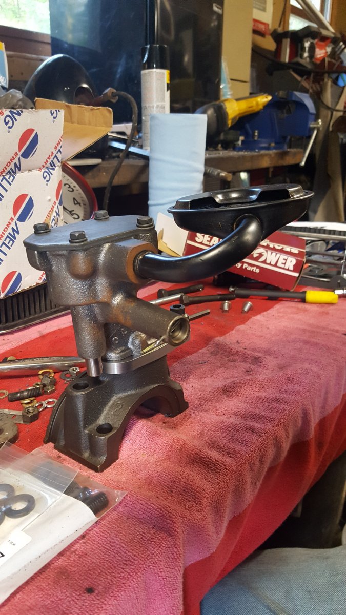

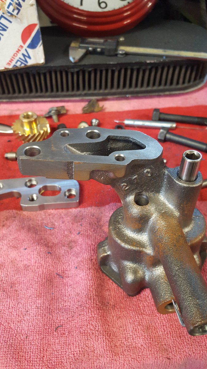

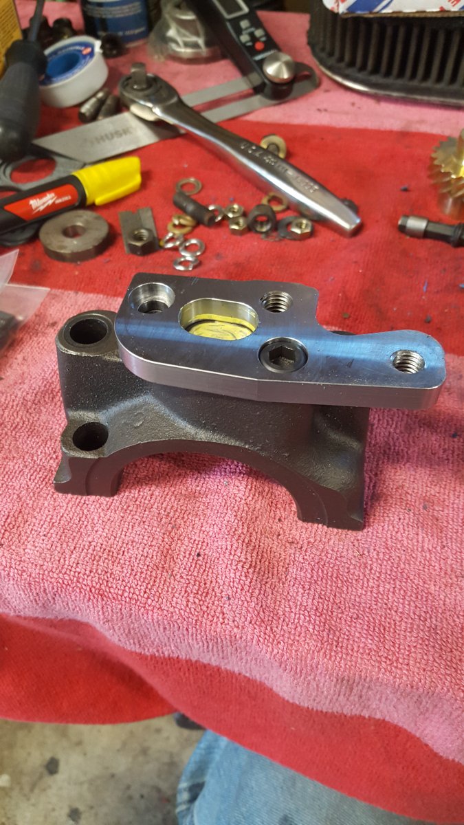

    Here's pictures of the parts to make the olds 455 oil pump work on the cadillac.
  12. MikeD
    Joined: Sep 10, 2006
    Posts: 20
    MikeD
    from mass.
    once I get the oil pump base machined to the proper angle, I will send along a pic of that...I do offer to do all the work, supply the parts and ship it all back to you. all I would need is your rear main cap. the bronze gear is strictly for a steel roller cam. I had several cams made for my own use and had about a dozen gears made to work with those cams. longevity is pretty good on the bronze gear. I generally replace them about every 10 years as they show some wear on the teeth on our race motors. street motors with a roller cam probably would use up the gear in a shorter time frame. as far as con rods go, you can use BBC billet rods but they need to be narrowed on the big end to fit and the crank would need to be ground to the BBC journal diameter. if you stroke the crank to the chevy journal diameter you can do it without adding metal to the crank to get that extra stroke, but piston pin height needs to be dealt with on the pistons. and thats not a big deal when doing forged custom pistons.

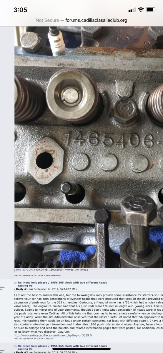

    Guys, question. I am going to replace my dual quad 425 nailhead in my 5 window with a 59 390. I found a set of what looks to be 1963 390 heads on ebay
    (stamped: 1479831 )
    Will they fit????
  24. Moriarity
    Joined: Apr 11, 2001
    Posts: 37,416
    Moriarity
    SUPER MODERATOR
    If they are 63 then Hollander says yes they fit . Interchange number 586

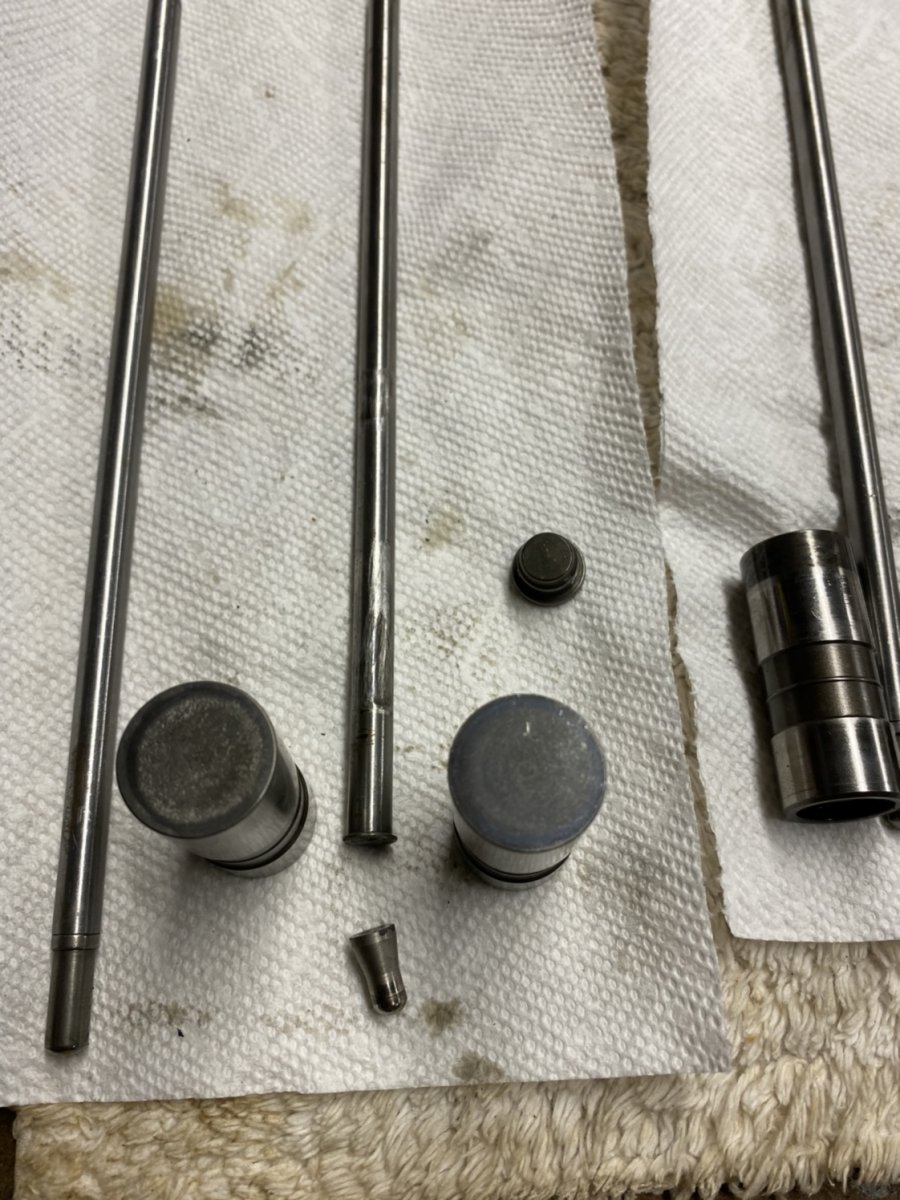

    Can anybody confirm pushrods are installed with the tapered small end down facing the lifters? Thanks!
  27. Moriarity
    Posts: 37,416
    Moriarity
    SUPER MODERATOR
    50E439D4-9F87-464D-B38D-A03FFF3B0443.jpeg 28CD2C5D-07FE-4573-8919-02ABD02D99B7.jpeg 8D7BE634-D7A8-4D14-9687-FB9D757A23E4.jpeg
    The manual says to put the grooved side facing up, hope that makes sense. I guess there are different radius on each end
  28. swissmike
    Joined: Oct 22, 2003
    Posts: 1,297
    swissmike
    Thanks Moriarty! I have the same manual and “grooved end” description doesn’t make any sense. Neither do the illustrations. My motor was rebuilt and had the tapered tip installed up and one of the tips was broken off.
    According to Feltz from Terrill Machine, the tapered side goes into the lifter. The smaller radius in the tapered side seems to have worn into the cast rocker arms which I also had to replace. Caddydaddy had the early 49 cam and correct pushrods and lifter combination (I hope...).
    I found a pic on the web that shows the fat side with the little flat on top. The radius is a good match with the rocker arm and I believe the flat might be to allow the oil flow through the tiny hole in the rocker arm.
    I will go with the tapered side down, install the heads and check lifter preload today.
  29. Moriarity
    Posts: 37,416
    Moriarity
    SUPER MODERATOR
    isn't that a groove on the pushrod on the left in your pic?
  30. swissmike
    Posts: 1,297
    swissmike
    I was debating that...
    The tip has the step or shoulder and a small groove where the tip is attached to the shaft, but the same small groove is where the taper attaches to the shaft on the other side. Not very conclusive IMO.
