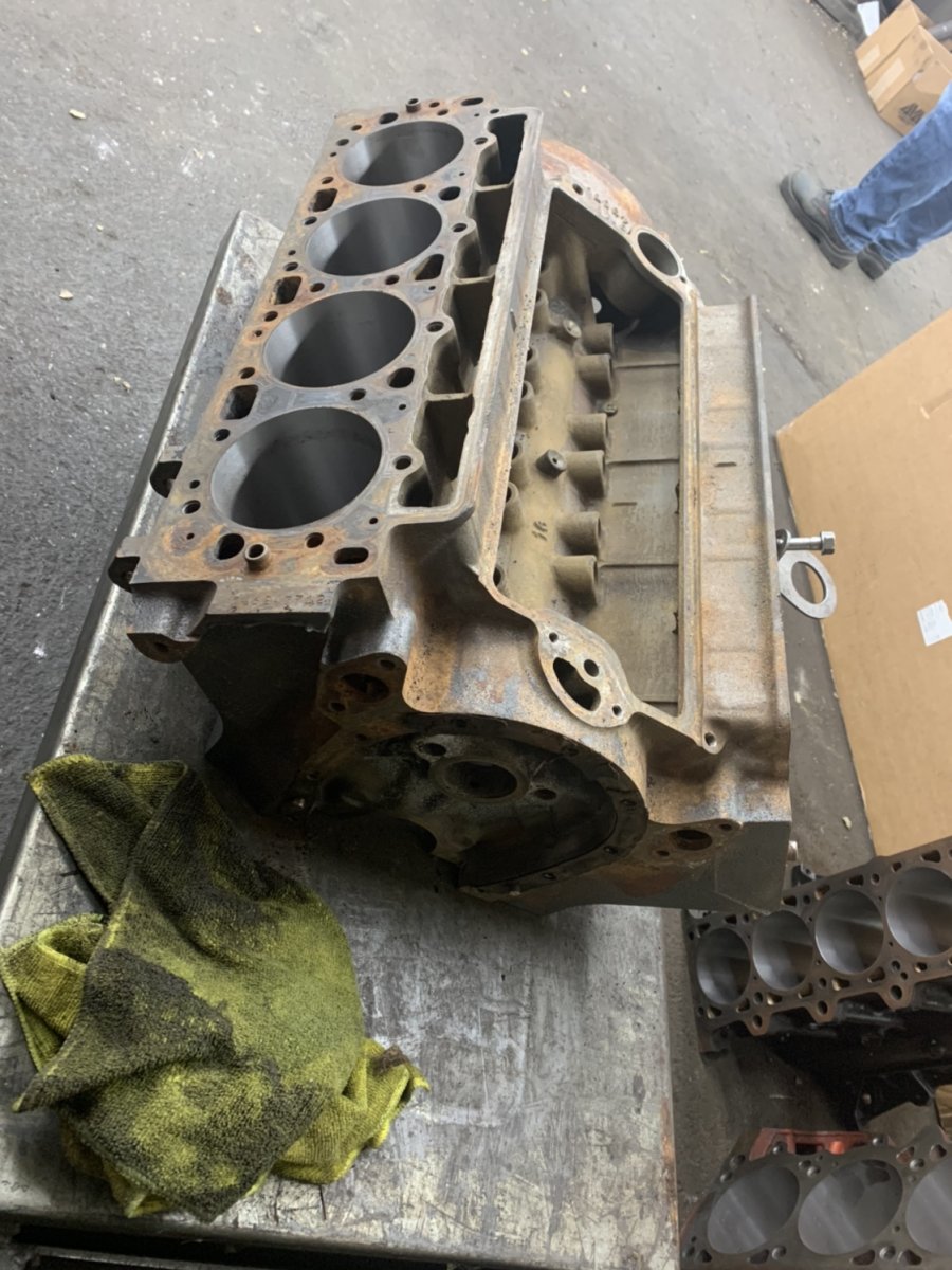

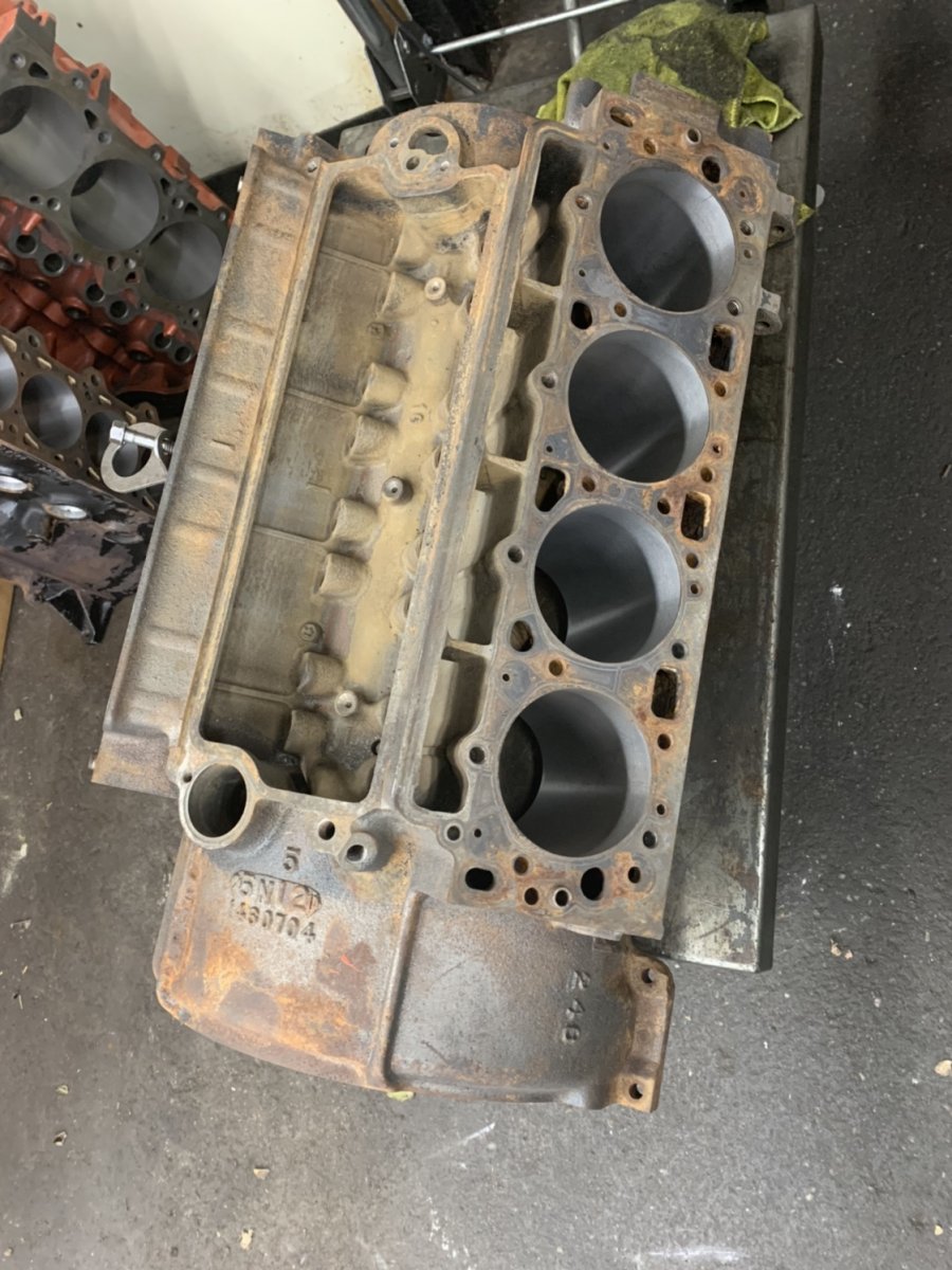

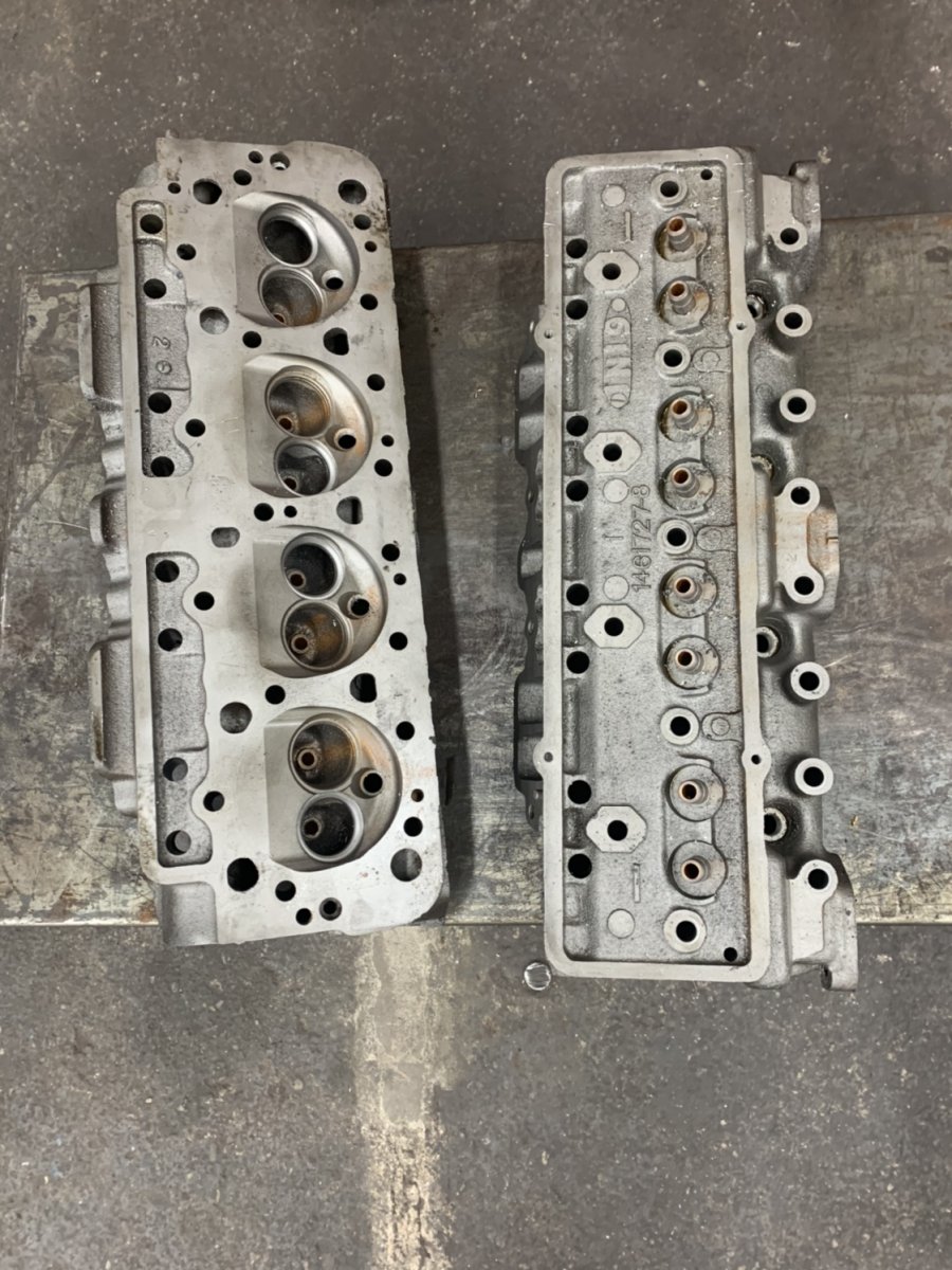

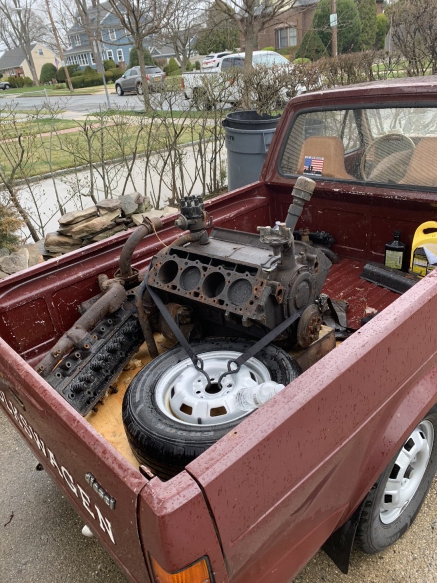

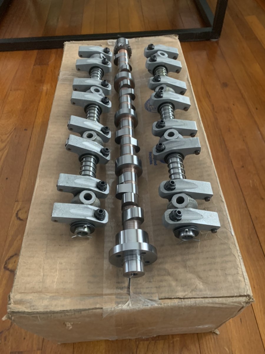

    Here’s some of my 54 331 that I’m putting together for my model a. I found it on marketplace The next town over and have slowly been having it machines and collecting parts over the last six months. Hoping to have it running by the end of the summer. We’re using bbc rods and custom je pistons. I have the valve information written down somewhere if anyone wants.
    I have read pretty much every caddy related thread on this forum and I remember someone cross referencing head bolts to arp, would anyone happen to have those numbers or specs?

    I know that there is a kit for the mains, but I don't know if there is one for the head bolts.
    Cadillac 331-365-390 1949-'62
    Main Bolt Kit
    117-5001
    I did find the rod bolts if you are interested.
    Rod Bolt Kit
    Cadillac 390 V8
    Kit #: 117-6001
