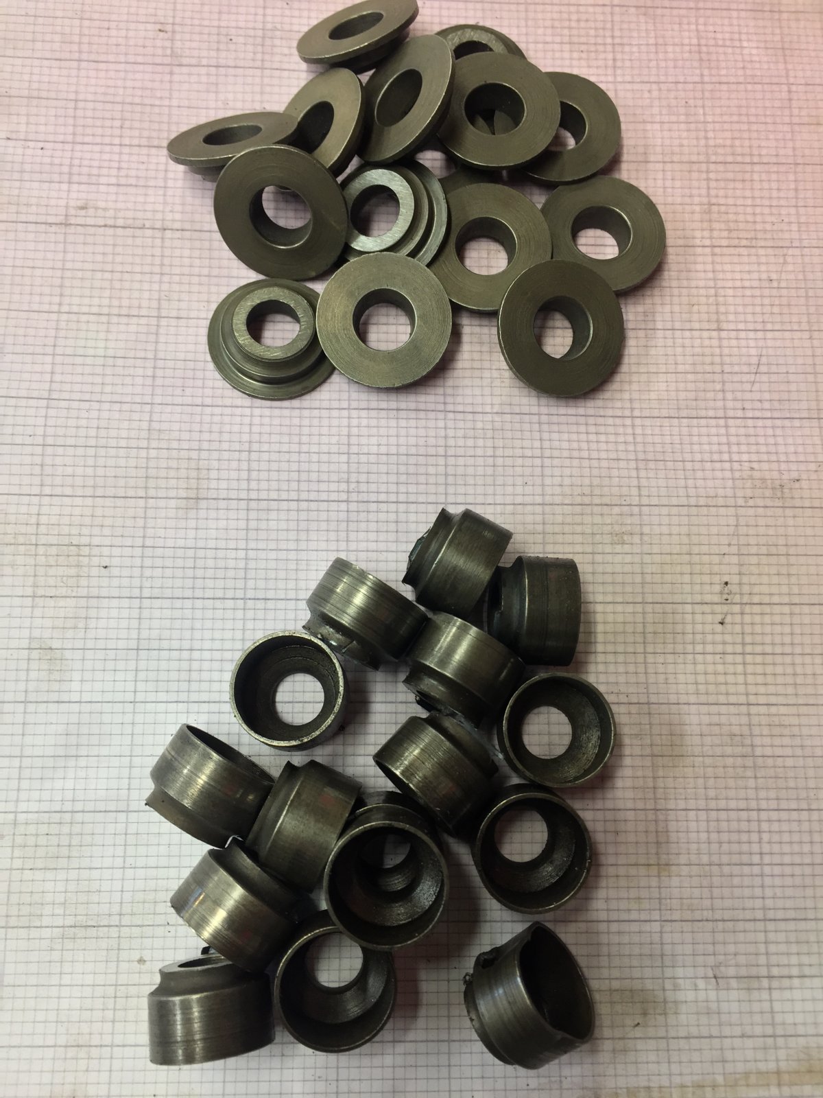

    Yes.
    Factory spring retainers with the oil covers removed.
    OEM style replacement valve springs with dampers. Dampers wouldn’t fit with stock spring retainers.
    SBC/SBF modern guide seals fit straight over the original valve guides (.500/.530?).
    Watch for valve lift hitting the seals.
    Had to have .250 machined from the guide height for a very mild Schneider Cam.
    31hotrodguy, loudbang and kadillackid like this.

    Thanks! Pics always help the simple minded.

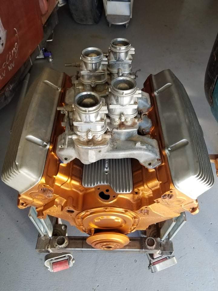

    I just got my 55' 331 all together and sprayed it last week. Going to run it in my 36 truck. Screenshot_20211022-180647_Chrome.jpg

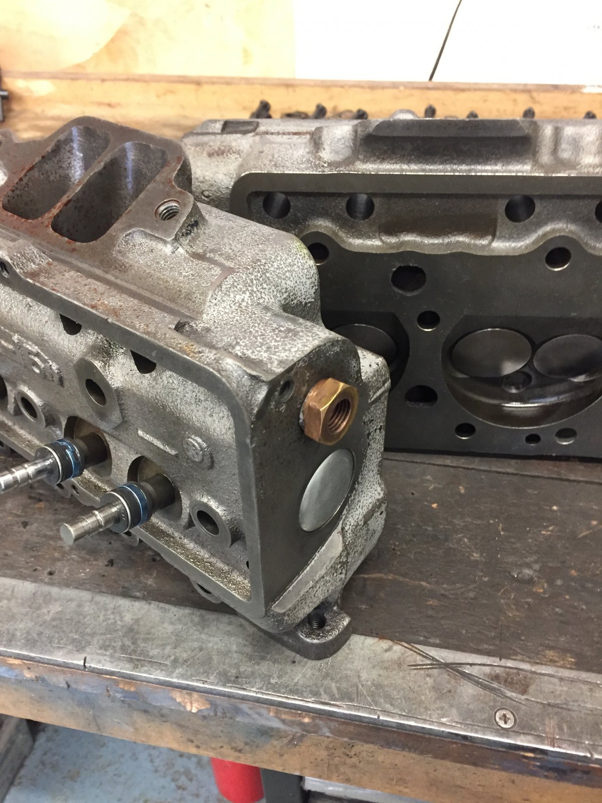

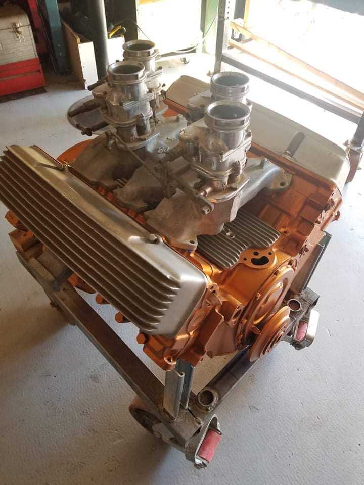

    Put some goodies on my 331...
    winduptoy, Dogberg, Jet96 and 9 others like this.
  16. iwanaflattie
    Joined: May 14, 2011
    Posts: 4,261
    iwanaflattie

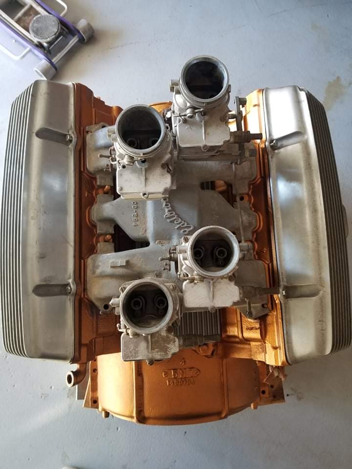

    received_1111416066062566.jpeg received_1081716869290307.jpeg received_3055655634712079.jpeg received_877329616318542.jpeg received_305033244675639.jpeg
    Put a little paint on the 331...im going to make a nice rolling cart and stick it in the corner of the living room.

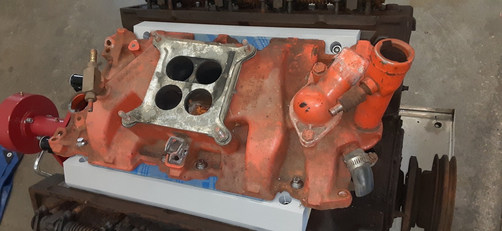

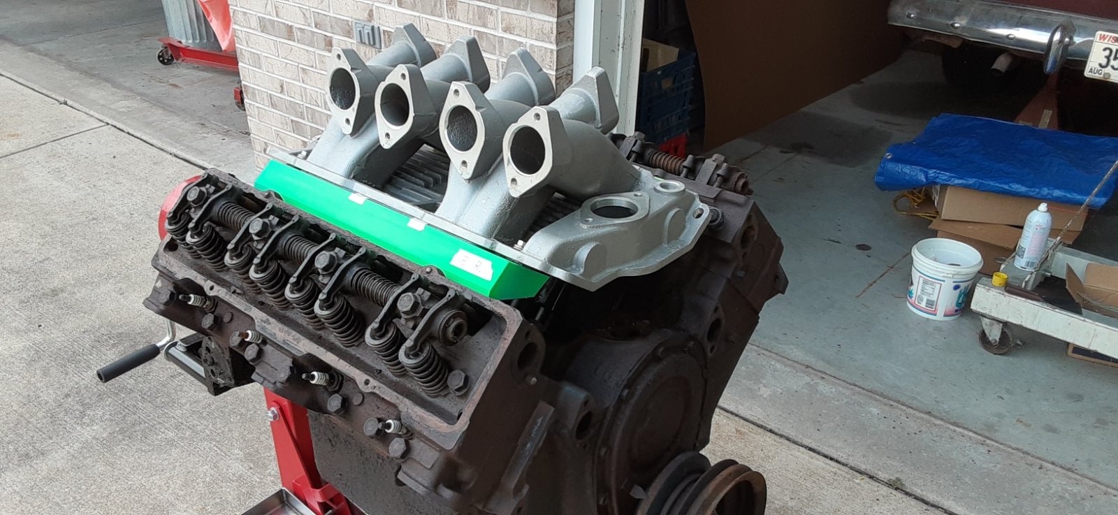

    I am getting close to having adapters available to put a small block Chevy intake on the early Cadillac. I started out doing a SBC to Studebaker and it was not too different to do the same with the Cadillac. The first one in aluminum is due from the machine shop in the next couple of weeks. The prototypes in the photos are 3D printed in plastic. Some of the manifold needs to be trimmed. Your intake possibilities are pretty much endless with a set of these adapters. I have another thread on here somewhere with more of the development process. I just bought a 671 blower and a SBC intake so the next post should have a blower on the Caddy.
    JK 20210821_074150_resized.jpg 20210819_192508_resized_1.jpg 20211008_164201_resized.jpg
    chrisp, kadillackid, Enbloc and 5 others like this.

    So you’d have to cut the coolant side of the manifold off? Cool adapter, makes a lot more possibilities available

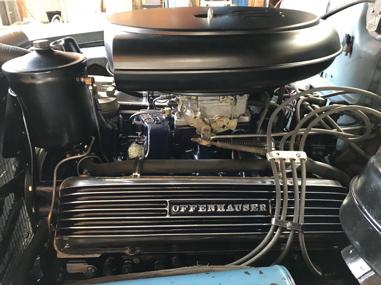

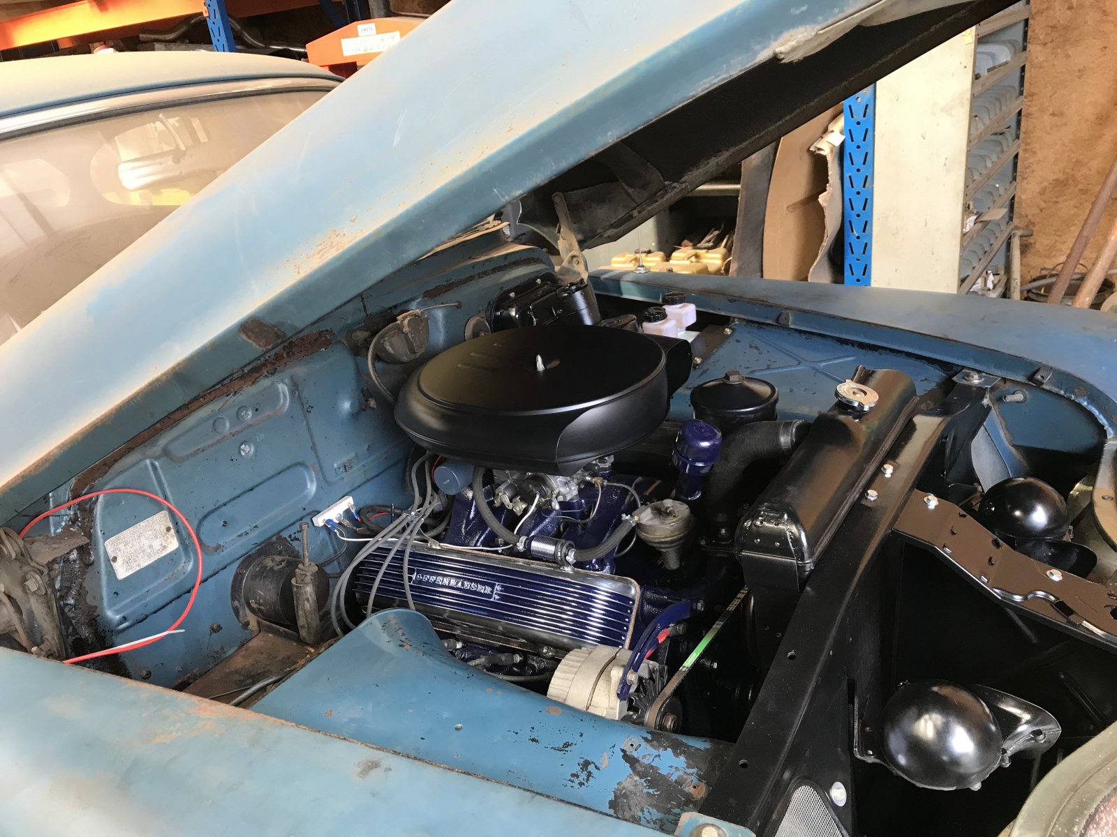

    Here is my ‘58 365 in my 52 caddy coupe. Just looking pretty but stil stock inside. I did replace the o ring type valve seals. Runs nice but still smokes a little from stuck oil ring. Motor sat for 25 years… i hope that solves just from driving more often.
    It’s got a edelbrock carb so need to figure the tv rod adjustment out… if anyone could help me out, please do so ;-)
    CollegeKid and loudbang like this.
