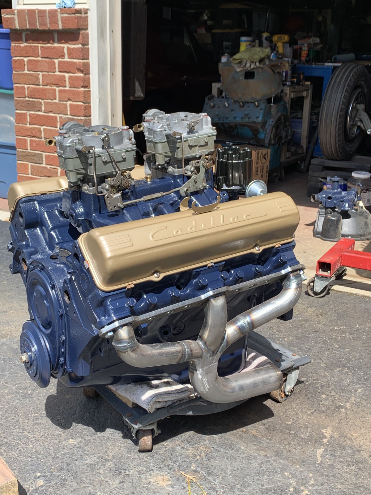

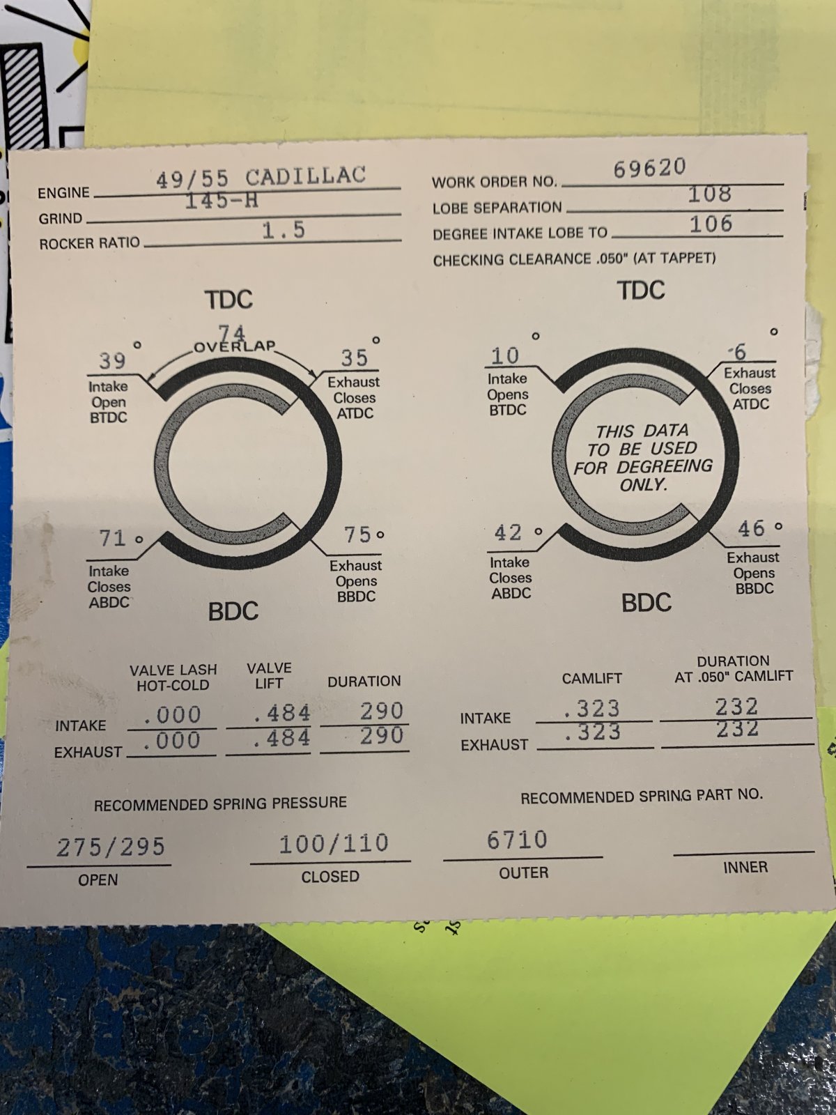

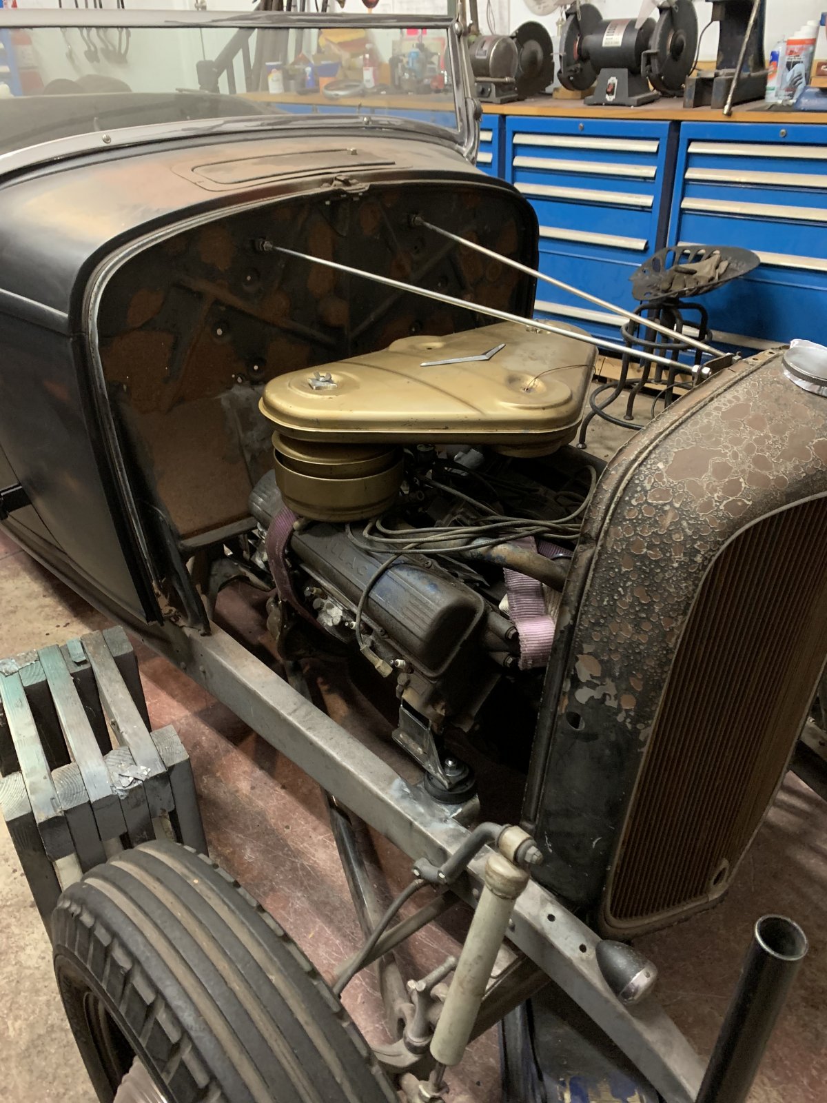

    Hey guys- great thread! I just finished putting this one together for my other roadster. 1956 engine +.040, Schneider cam (145H ground at 108). I had the valve guides re worked for the .523 valve lift and Viton seals as well as Schneider valve springs. I’m a little nervous about that much lift (523) for durability but maybe you guys can re***ure me on that? I’m using SBC lifters with Smith bros custom pushrods and a PCV adapter by @CTaulbert

    Have you busted it off yet? I’m curious about the cam…mine is similar.

    not yet- hopefully soon! One thing I didn’t realize until I got the cam was the valve life Schneider reports is at 1.5 rocker ratio. So if you are running the 1.62 rockers you need to recalculate to get the new valve lift. If you follow Cory Taulbert on instgram you can hear this same cam in his 331 ‘33 coupe . It sounds great!

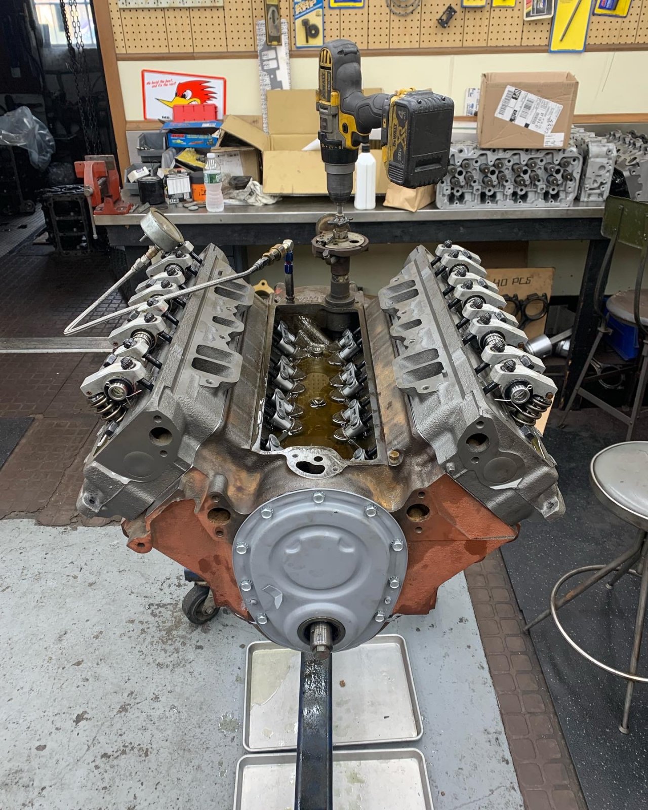

    What can you tell me about those rockers?

    They are from Ross racing along with the roller cam, lifters and oil pump

    Curious about what Ross did with the oil pump. Rebuilt, Modified or?? IMHO that's a weak point of the early Cads...

    This is what he told me in a pm.
    He added a billet insert in the pump to increase the pressure/volume and deleted the vacuum side

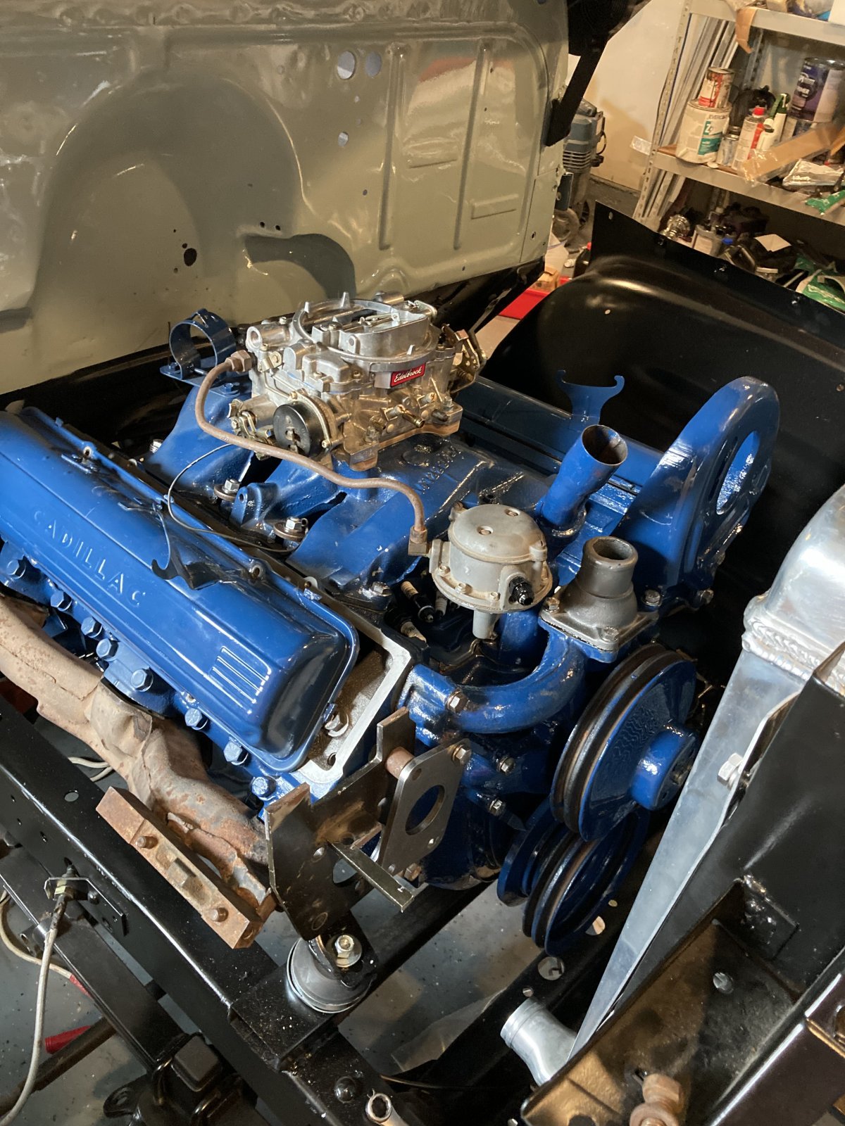

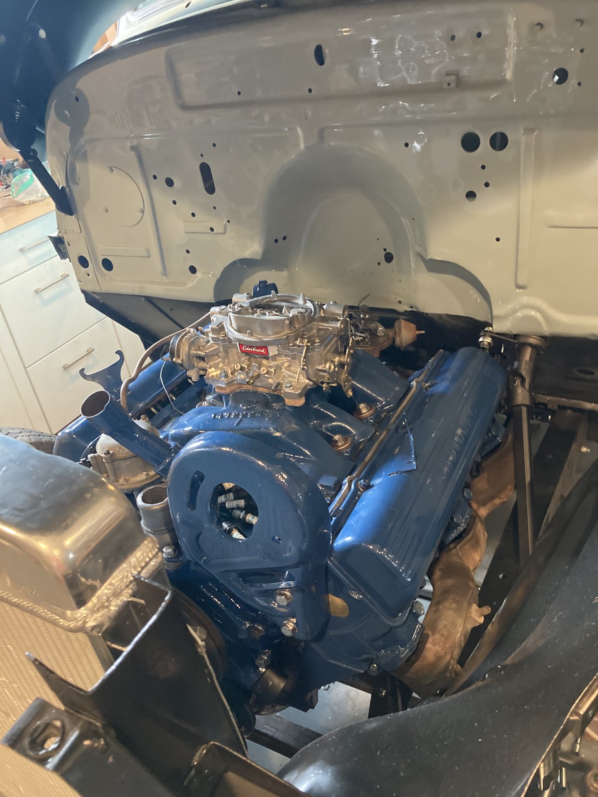

    390 in my 1950 Chevy 3100. Rockers are getting rebuilt right now. My current issue is mounting an alternator. I think I can squeeze it in there and keep the mechanical fuel pump but it’s tight.

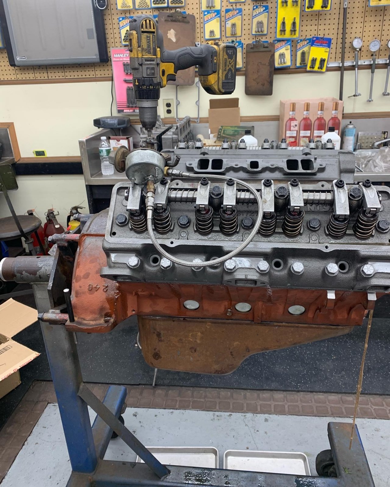

    Wondering if anyone may have some insight on this: I had my engine rebuilt. I was trying to prime it before starting for the first time and noticed the rocker arm ***emblies were clogged. I removed them and mailed them to get rebuilt. I only removed the head bolts necessary to get the rocker arms off. When I put them back on can I just torque those bolts down to the required 75 lbs or do I need to remove all the head bolts, replace the head gasket and retorque them all.

    You can just retorque and move on. At least I would…….

    Retorque them and go

    Just be sure that the rockers arms are correctly ***embled and that you get them on the heads in the correct orientation. Doing it wrong will cause lack of oil to the rockers or oil in the wrong place which can cause the rockers to seize and bend valves and pushrods. Previous owners/rebuilders of both my Cad motors screwed this up... had to replace all the shafts, rockers and valves on both.
