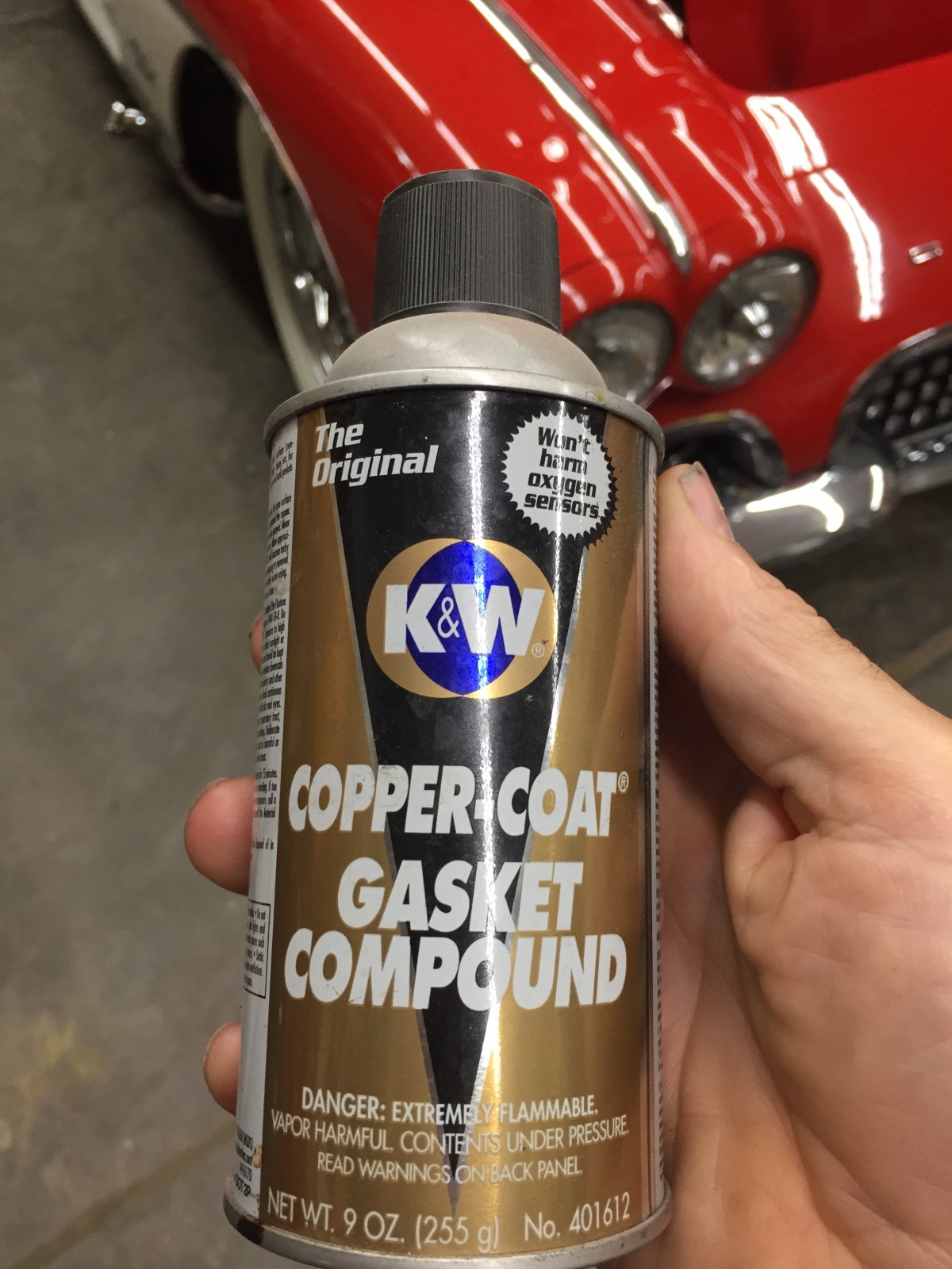

    I coat head gaskets with copper coat
