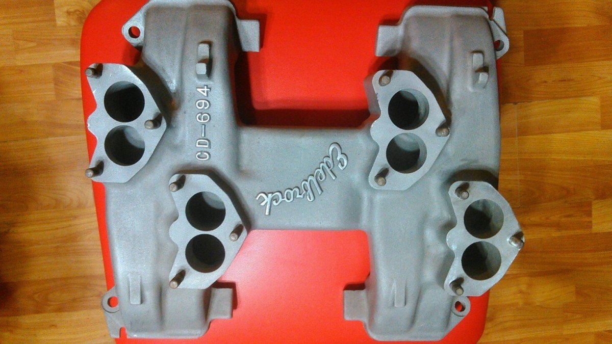

  6. Roothawg
    Joined: Mar 14, 2001
    Posts: 25,975
    Roothawg
    IMG_3299.JPG Dunno yet. It's unloaded, but it is a grimey pig. It has an oil filter adapter on the p*** side though. Kind of a clunky looking deal.
  7. Roothawg
    Posts: 25,975
    Roothawg
    Looks like I scored after all.
    winduptoy and MOTOV8N like this.
