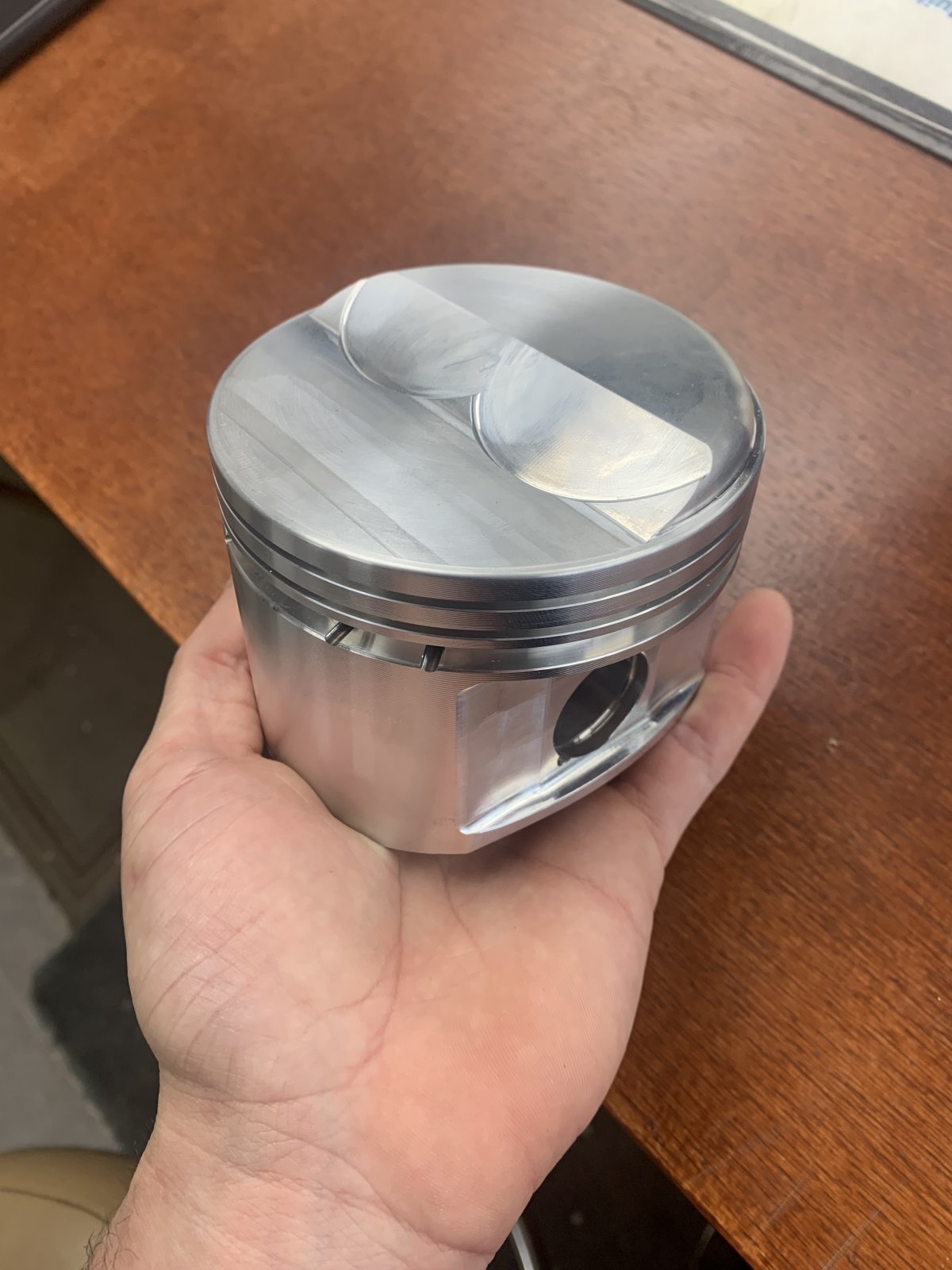

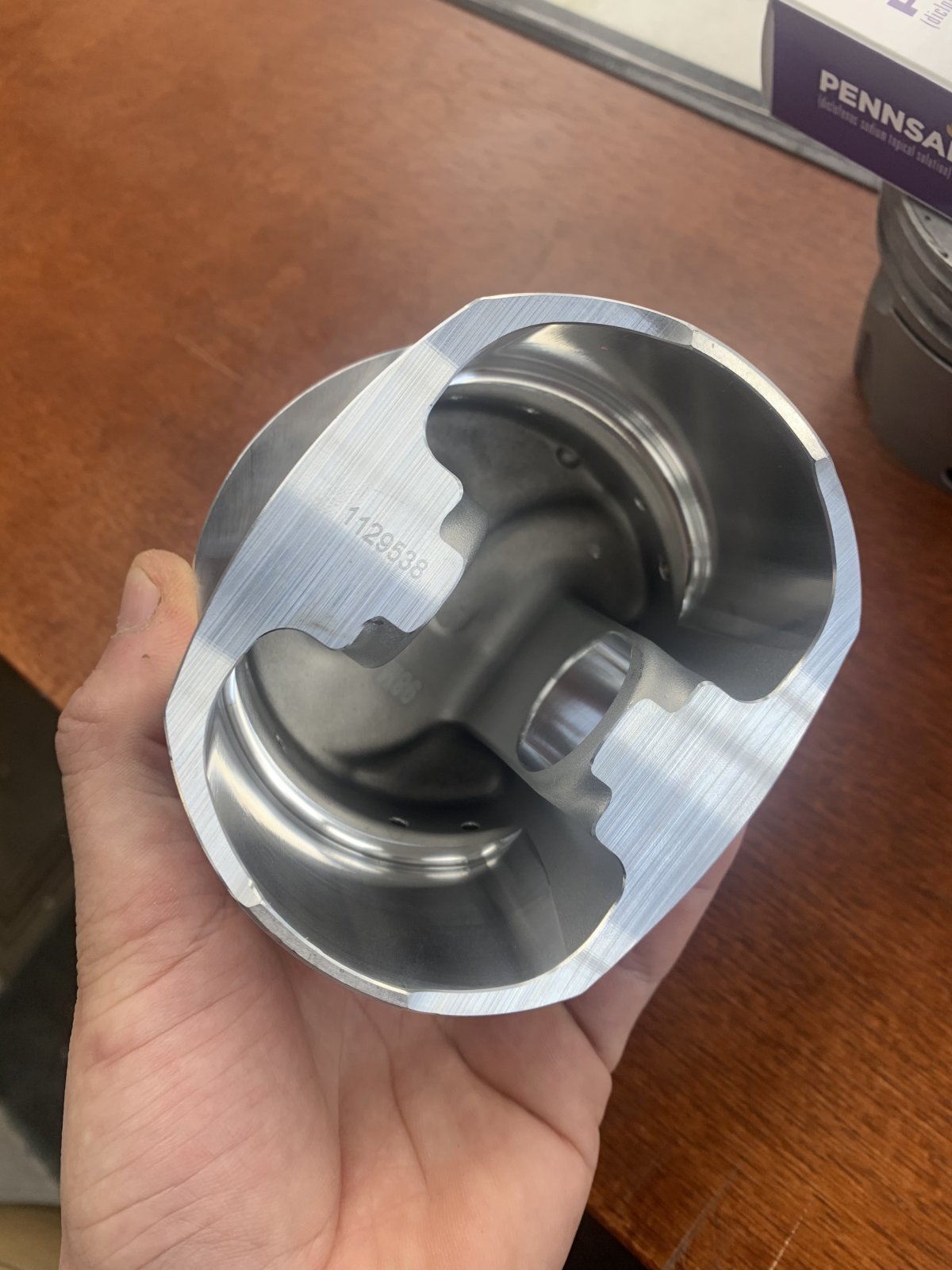

    I spoke to Ross today so I could get some pistons for my build.
    They called me back and asked a couple questions I need to find an answer for.
    The first was that he wanted to know the width of the small end of the connecting rod. I can call my machinist tomorrow and have him measure mine, but I thought I might get an answer quicker here. So anyone know that dimension for a 331?
    The second question was head gasket thickness. I can find gaskets available, but no info on thickness.
    I called and left a message with best gasket, but thought I'd ask here too.
    rod1 likes this.
  21. Roothawg
    Joined: Mar 14, 2001
    Posts: 26,034
    Roothawg
    The problem you run into is getting the rod width. I found out that I can use a Pontiac 455 rod but the width on the more modern rods is about .100" wider than the Caddy.
    I have a ball park on the original width, but I would hate to quote it to you and then you make the piston to fit that arbitrary number.
    JE will build you an exact replica of your piston in a forged slug. Just send them your old piston.

  22. tuff57
    Joined: Mar 5, 2008
    Posts: 113
    tuff57
    from wantagh
    I went through a gasket search putting mine together and it seems that best are actually the best available. But there is only one thickness that they offer. My machinist built a piston using an original piston and added to the top and sent that to jahns for them to make a custom piston for the build. I have the mock up one at home in a box somewhere but it was basically where that step up piece is to the edge screwed into the factory piston to get the compression ratio we wanted
    rod1, Roothawg and cretin like this.
  23. cretin
    Joined: Oct 10, 2006
    Posts: 3,059
    cretin
    I spoke with my machinist this morning and he just measured it for me right away. He came up with 1.38”
    I went with Ross because we are a dealer and I get a price break. But also, since I’m doing 390 heads, I wanted to get some made so I could dial in the compression ratio.
    As for the head gaskets, Best gasket called me back, and compressed thickness is .045”
