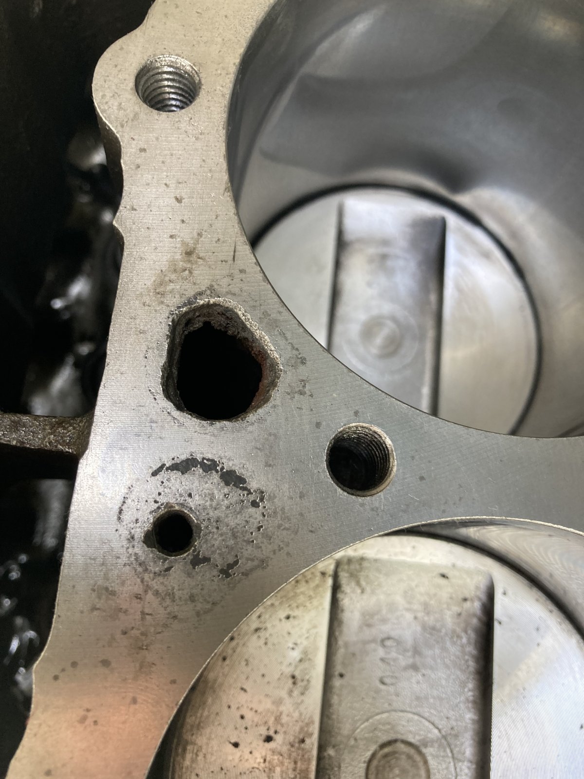

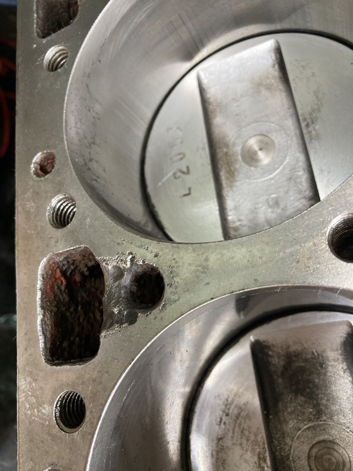

    sheparj2
    Do you guys think these imperfections could be causing the leak? The surface doesn’t seem warped but definitely a lot of pitting (rust I ***ume).

    Moriarity
    SUPER MODERATOR
    I enlarged the pics for you, always select full image when posting pics... man that is a lot of pitting, can you tell by looking at the gaskets which cylinder was leaking??

  18. sheparj2
    Joined: Dec 19, 2018
    Posts: 55
    sheparj2
    Ok. I think I fixed the pictures. No, I really can’t but I didn’t run it very long. Maybe 30 minutes. I took the whole engine back to the rebuilder but he’s just lost.

    lumpy 63
    That block really needs to be decked, but first you need to measure how far down the pistons are at TDC to see how much you can cut it.

    wrenchbender
    First thing is that block needs to be decked it has way to much pitting to expect a gasket to seal my big concern is the area in the 5th pic but I will look at my extra block when I get home tonight to see what that hole is for as it been awhile since I looked that close and it may not matter

    warbird1
    #3 and #5 do not look good... that block needs to be decked, if there's enough meat left.
