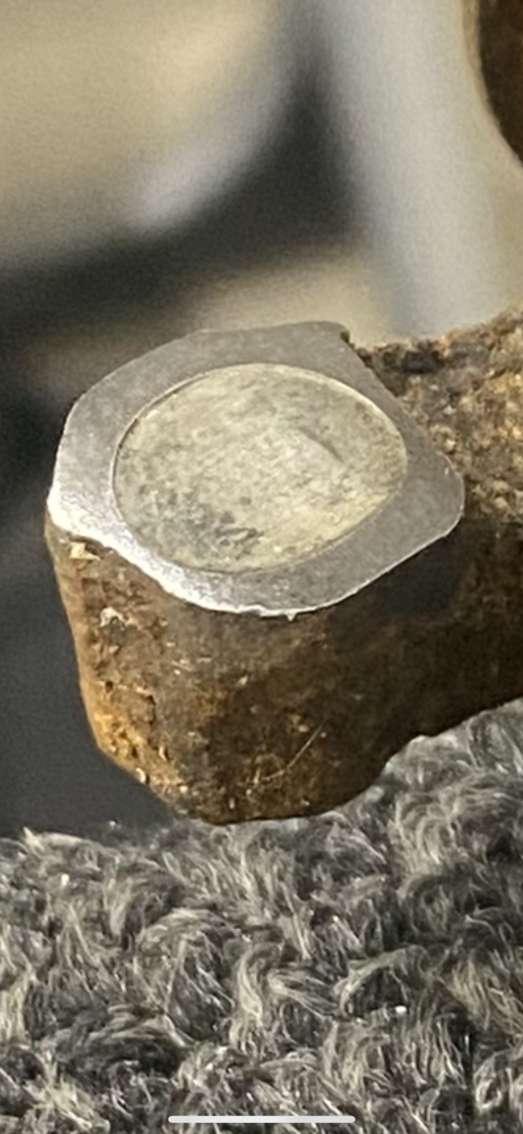

    2E0E8A35-26F3-4B5C-837E-0BE9CFA1A0A2.png Another issue that I’ve noticed is rocker arm wear where it contacts the top of the valve stem. I have a couple sets and most of them are worn like the photo I posted. What’s the solution? Find enough unworn ones? Can they be resurfaced?

    My machine shop had a fixture to resurface rocker arms, but if they are really hammered they are probably junk.

    . I had mine rebuilt by rocker arms unlimited. $350 plus shipping. Came back looking brand new.

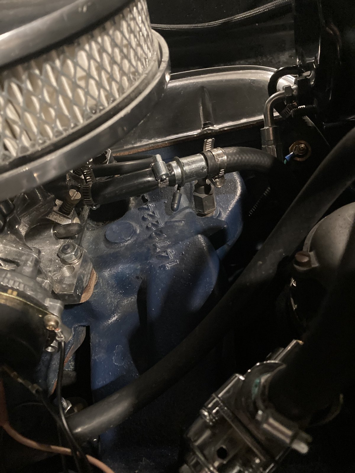

    Is there anything incorrect about how I have my PCV set up? It seems everyone else does this fancier so I was wondering if how I have it is ok.

    That PCV setup looks good to me as long as you have the breather tube clear to Fresh Air

    Thank you. When you say "breather tube", you are talking about the oil filler neck? I haven't found a cap small enough to fit so its very open right now. :)

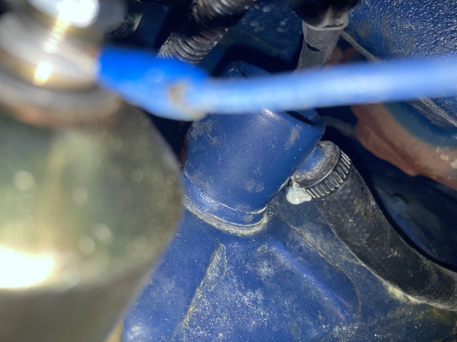

    If you have the pvc that close to a breather it will not do its job of evacuating the crank case of fumes. The pvc will take the route of least resistance which is to **** fresh air thru the filler neck. What did you do with the port in the valley pan that the road draft tube usually goes to? That is where your pvc should be connected to so that fresh air enters the breather on the oil fill and is drawn thru the crankcase and the fumes removed by the pvc at the port where the road draft tube was. If you are wanting to leave the pvc on the filler tube you will have to get an oil cap that seals tightly and then figure out how to get the fresh air to come into the valley pan at the opening that the road draft tube was in.

    That's how Cadillac did them in '62... how I've done it on both of my Cads; seems to work fine.

    where was the fresh air drawn into the system?

    Through the filter media in the oil cap.

    Am I not seeing his photos correctly? it looks like the inline pcv valve is connected to the oil filler tube?
