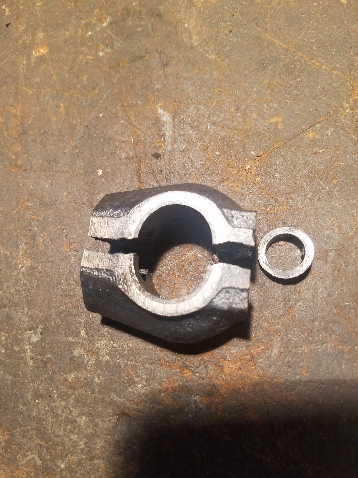

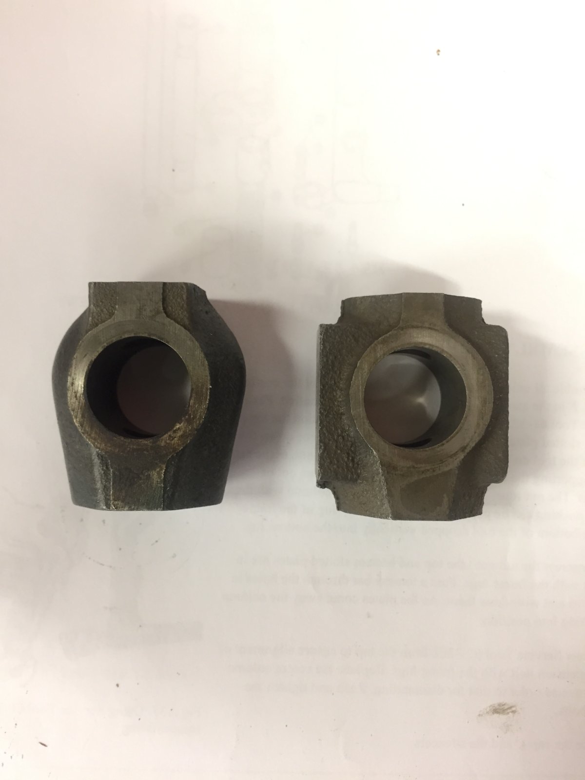

  25. Automotive Stud
    Joined: Sep 26, 2004
    Posts: 4,391
    Automotive Stud
    Random question, I'm curious if anyone else has run into this. When I was torquing down the heads on my 55 331 I had one of the rocker shaft mounts split in half. I searched around and everyone told me they never heard of this before, but when I eventually found a couple of junk replacement shafts I found that a couple of those had hairline cracks in them already also, so it can't be that rare. I also noticed the later 365-390 mounts looked a little more beefy, but I stuck with another set from a known 1955 motor just to be sure they were the same. So I'm also wondering if the later mounts could have been a possible upgrade? 20191223_131720.jpg
    warbird1 likes this.
  26. Enbloc
    Joined: Sep 27, 2004
    Posts: 1,895
    Enbloc
    from London, UK
    Yep!
    I think I had a couple of cracked ones from memory.
    Then I realised I had a mis-matched set as I had a couple of later ‘square’ stands mixed in.
    I’m guessing the cracked stands had been an issue in the distant past and replaced.
    I ended up buying a complete set of later rocker ***emblies to get a set of ‘square’ stands because I believe they are stronger and an upgrade from the early ones.
    All the shafts were worn out so had to get replacements and added a set of adjustable rockers!

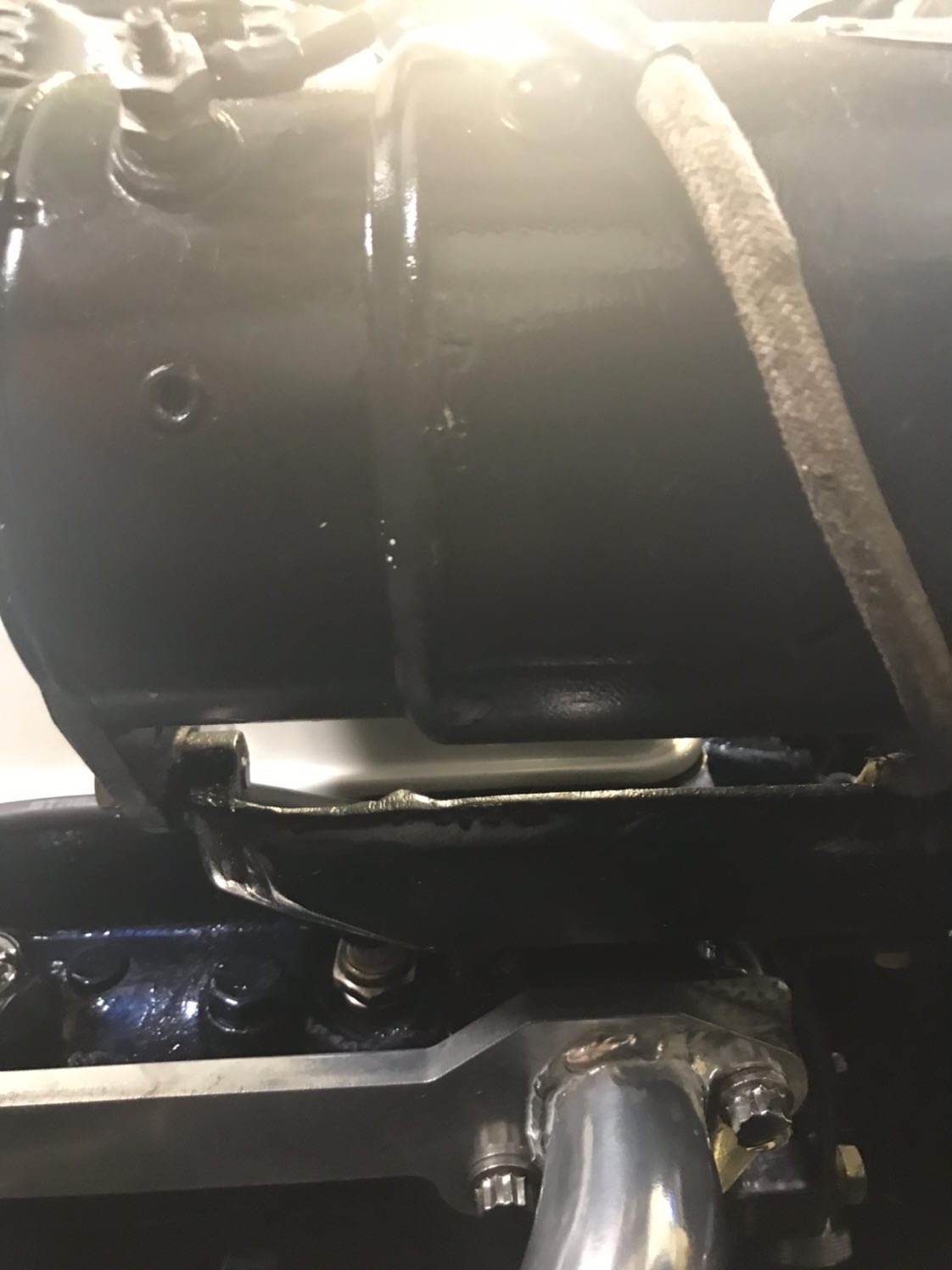

  30. Automotive Stud
    Posts: 4,391
    Automotive Stud
    When I put the motor in my '40 I didn't have room on the side to hang the generator, so I made my own bracket to hold a Ford generator, it goes to the two water pump bolts and the intake manifold. It's been on there for probably 5k miles now with no issues. 20200330_174041.jpg
