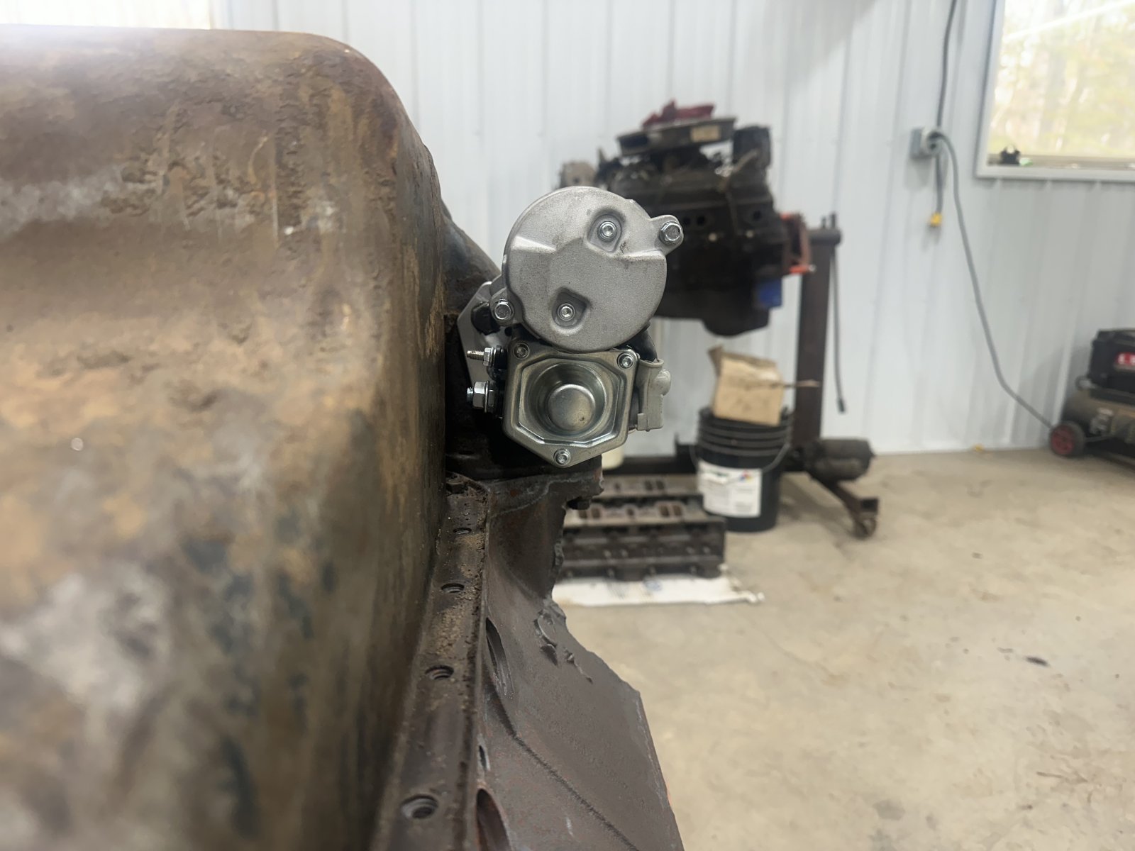

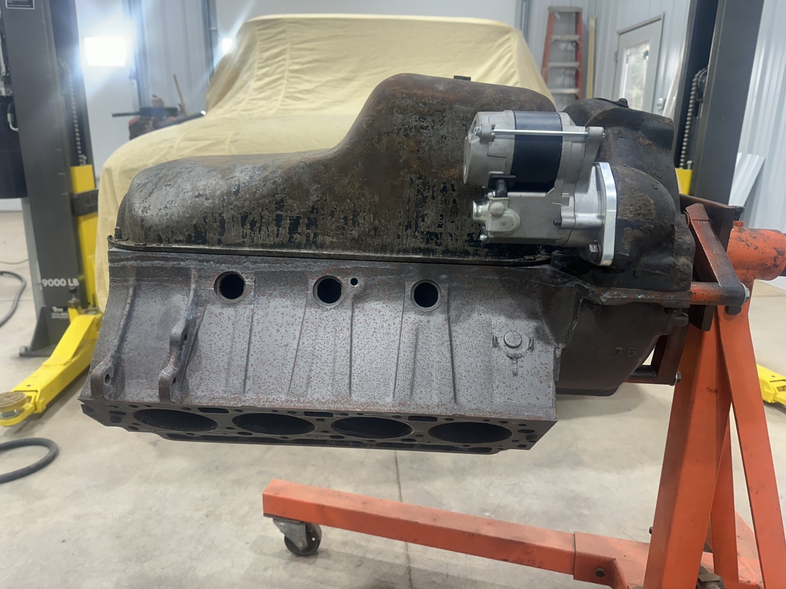

    New problem. I bought a new flywheel and high torque mini starter from Speed Gems for my 331. Their flywheels have a 143 tooth ring gear instead of the stock 145 so I bought the starter they offer to match. Problem I’m having is I can’t mount the starter in the common way with the solenoid on top. The only way it will fit is straight down, at about the 7:30 position and at the 9:00 position. Anyone else run into this? I tried calling them Friday but they were closed for the week.
    MIKE PAUL
    I rotated the starter on my 331 that is just loosen the bolts and move it so it is where it needs to be.

    Tried multiple positions, that’s the only way it works to give access to the starter mounting bolts
