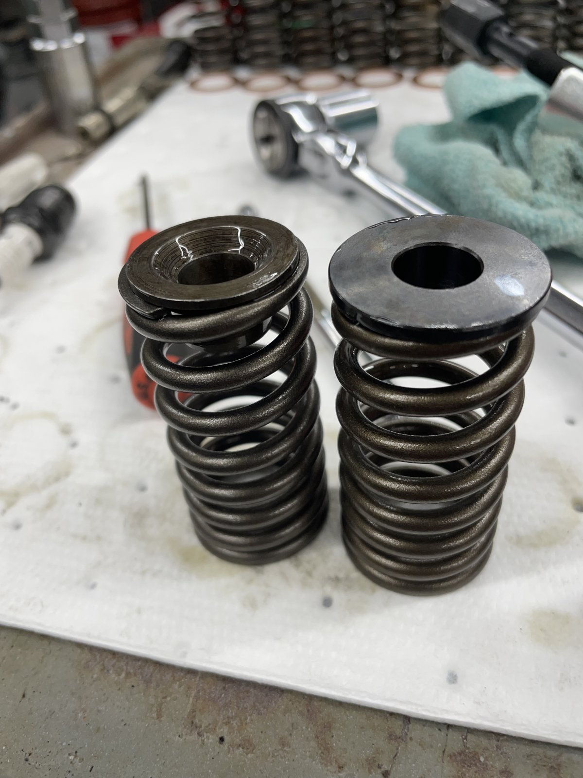

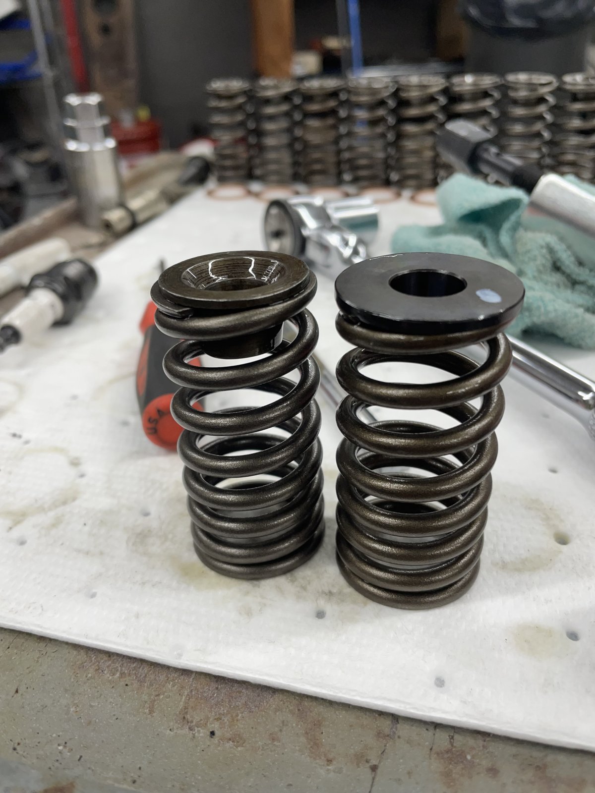

    I wanted to add a little info here to maybe help someone in the future. I bought a Schneider cam and valve springs part number 6710. To get the install height pressures correct they would have needed an average of .110- .125 worth of shim. The machine shop had a set of SBC retainers and tried them and because of the design they made up for .110 worth of height difference alone. Also the caddy keepers fit the Chevy retainer.
    Stock 365 caddy retainer on the left and the SBC retainer on the right. IMG_0044.jpeg IMG_0043.jpeg

    I was planning on just using all SBC stuff on mine. I am going to changed the guides and cut them for a positive umbrella style seal. Those clunky Caddy retainers have to go. I just need to see what springs I can make fit. What was the diameter on your springs?

    My guides are cut down 1/2” in height and also cut for umbrella seals. I don’t know for sure, but think they are a “z28” style spring, 1.26 OD

    Also in that picture I posted those are the original style springs I used to brake the cam in, The ones I’m running have thicker wire and a flat damper spring.

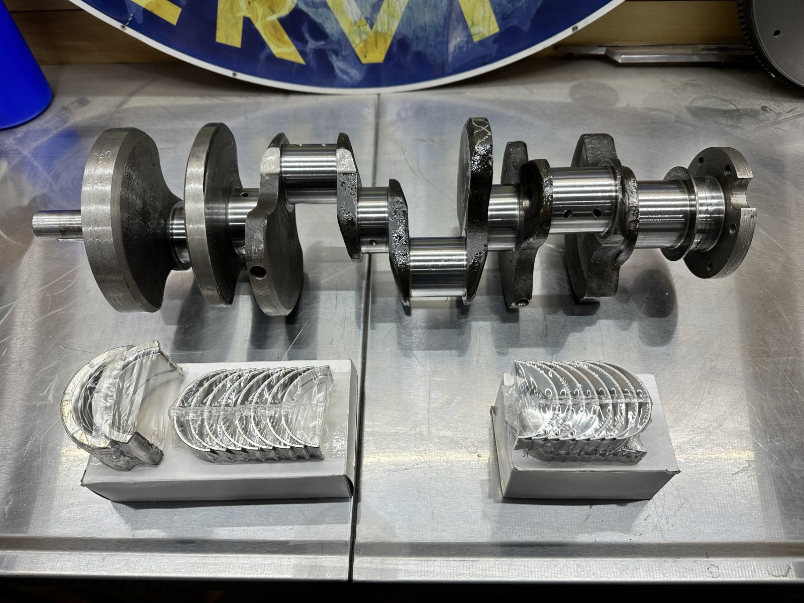

  26. Anyone have any luck finding main bearings in .010 or .020 for a 331 (he really needs .010). I have a friend that's looking for them and can only find .030 and doesn't want to grind a good crank that low, since the crank was ground to .010 already.

    what engine? They take different bearings. I have 331 .020 rods and mains. And a freshly ground crank

  30. Yeah, I spaced....it's a 331.
