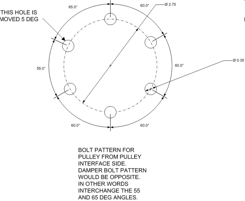

    Would anyone happen to know the bolt pattern or the harmonic balancer? I know the crank pulley only bolts on one way and I need to machine a set of pulley spacers to space my belt out 3/16 of an inch. I found this file, but I’m not sure if it is correct. Can anyone confirm?

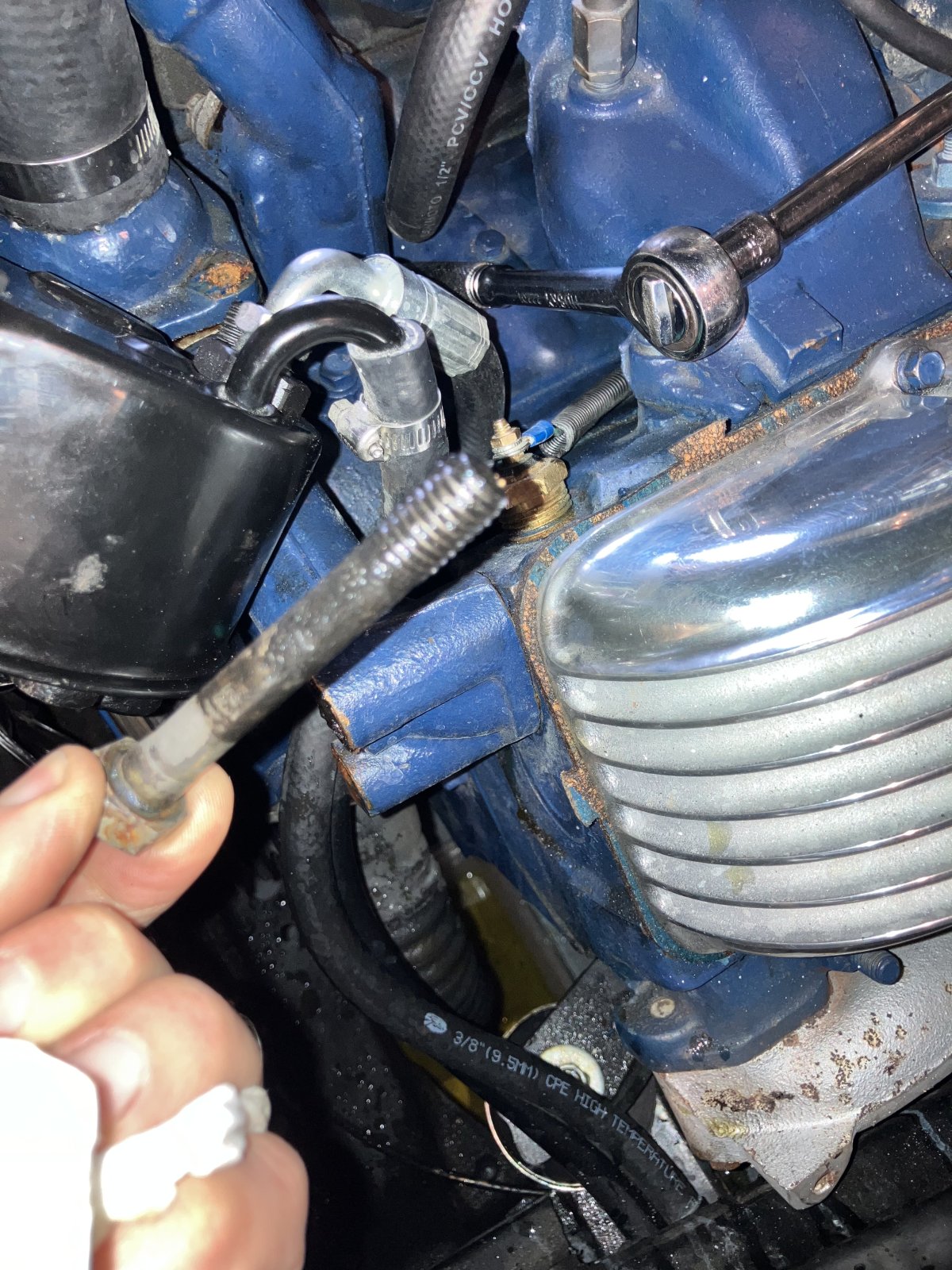

    Hey guys, Anyone know what this could mean? I pulled this top water pump bolt out and it’s kind of black and sooty. The bolt is over sized because the threads were stripped. The motor runs ok, I just needed to remove my power steering bracket. My antifreeze isn’t black like this so why would this bolt be like this? A crack in the head right here? Thank you

    Petrified Permatex?

    yup, they put sealant on the threads so it would not leak around the bolt. that hole goes into the water jacket

    “They” would be me. Maybe it’s that simple, it just seemed like it was wet and more than just a bit of rtv. I guess if it was a crack there would be some more catastrophic type symptoms….

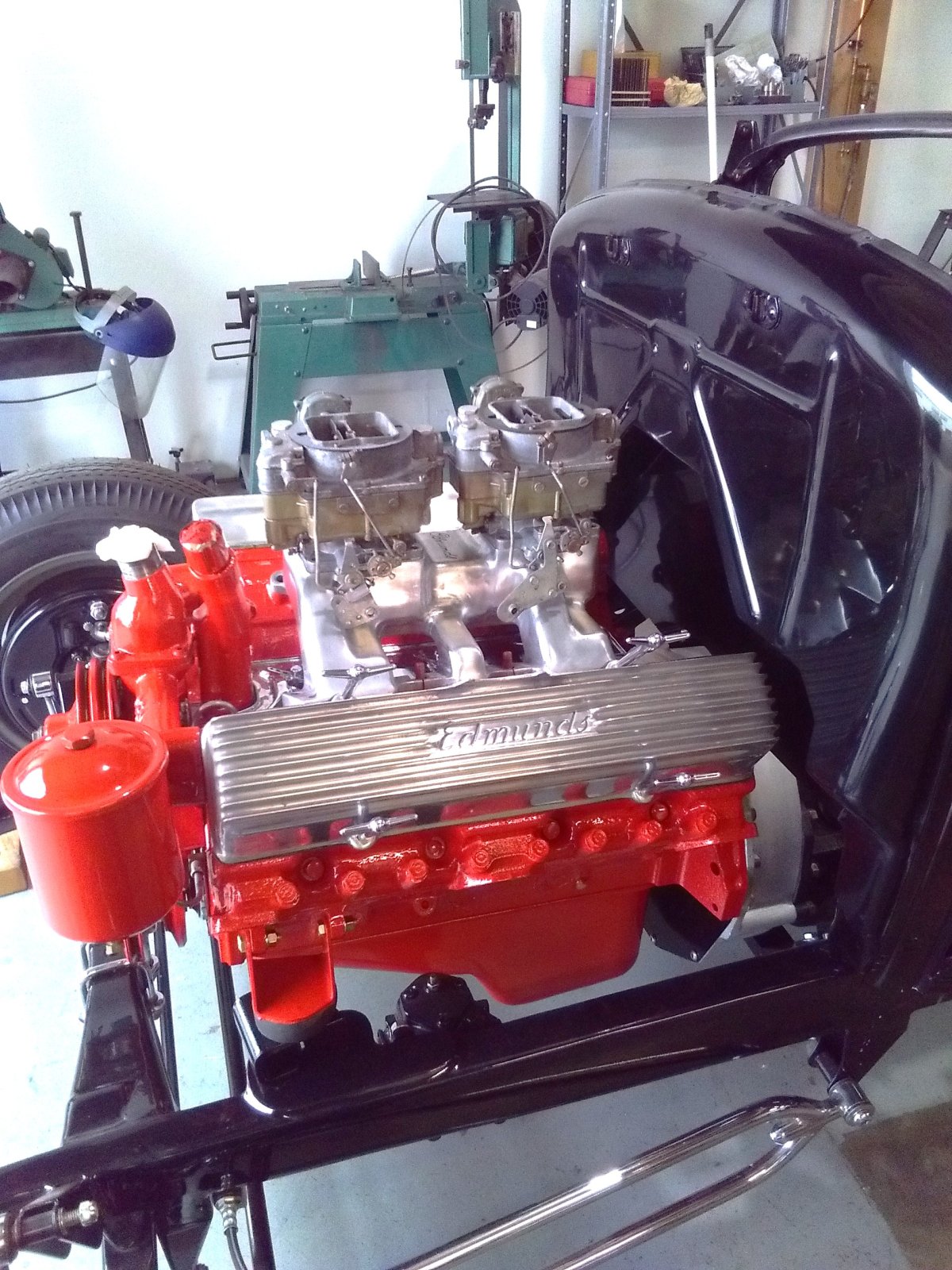

    Just showing off today... the 331 and Hydro are finally installed.

    That makes my pee pee feel funny.

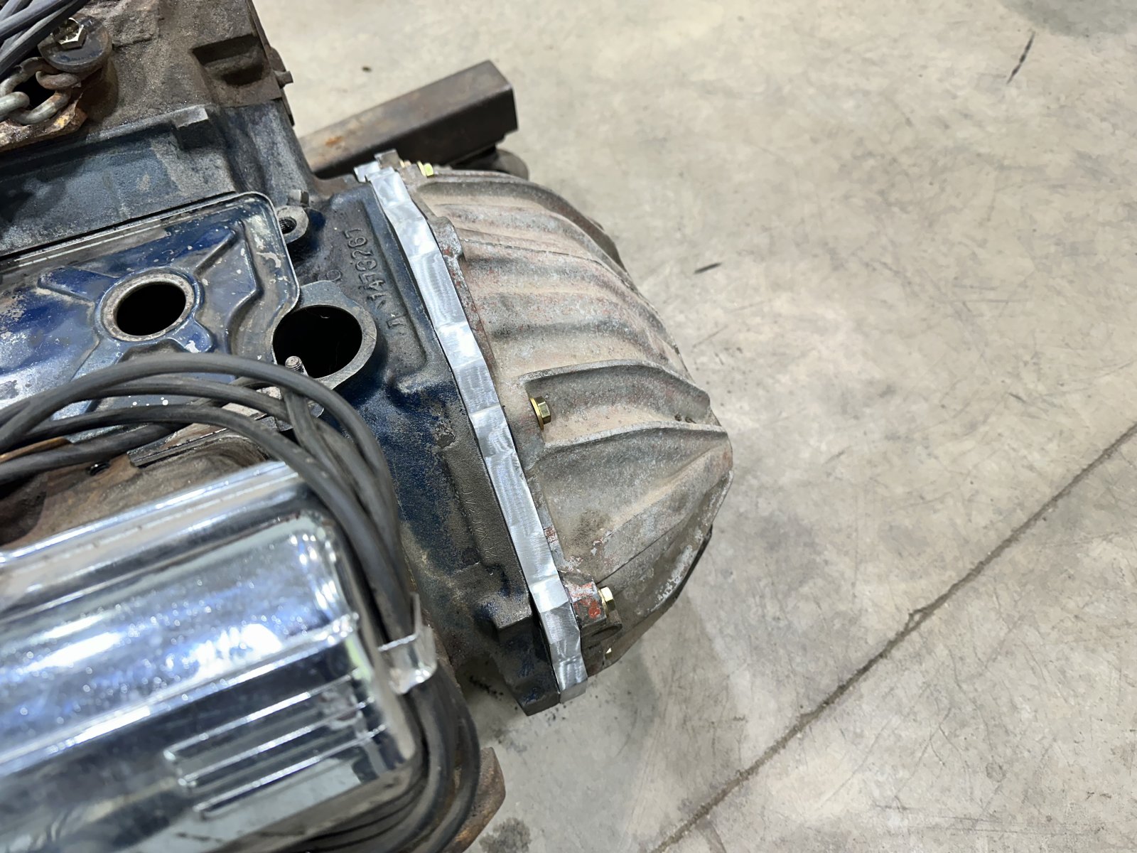

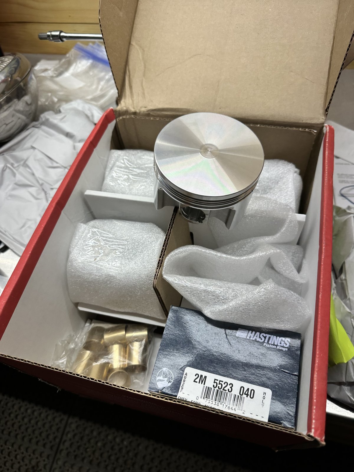

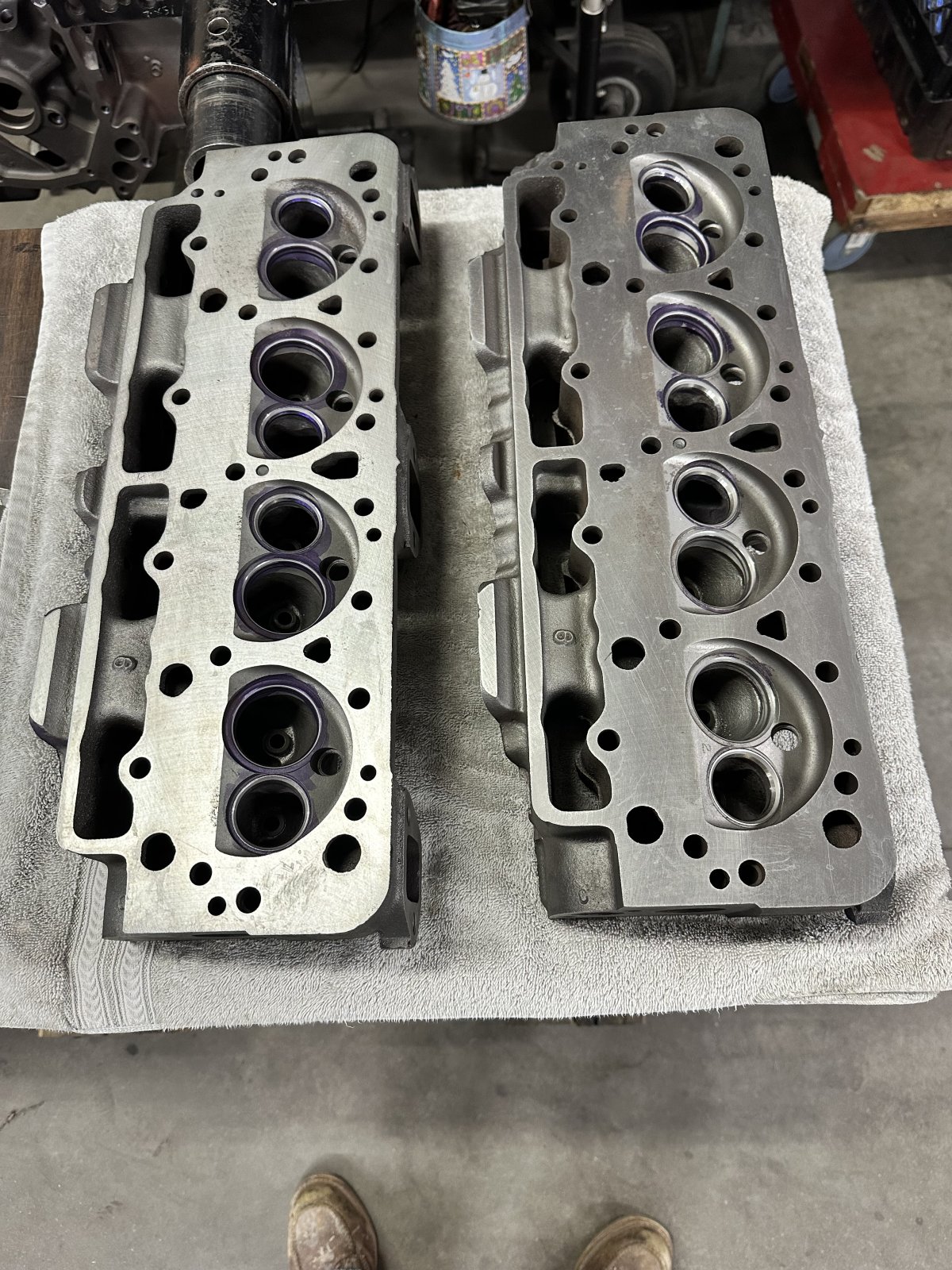

    390 update. Rotating ***embly balanced. Head machine work done. Block work is next! Speed Gems Transmission adapter trimmed down to match the profile of the engine/bellhousing better IMG_3664.jpeg IMG_3663.jpeg IMG_3635.jpeg IMG_3639.jpeg IMG_3641.jpeg

    Forged pistons? Who made them?

    Racetec

    Post a part number if you don’t mind, really any part numbers help for future reference.

  20. Nice job taking the time to trim down the adapter, one of those things you don’t see but well worth the effort.

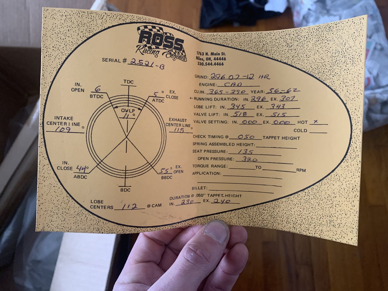

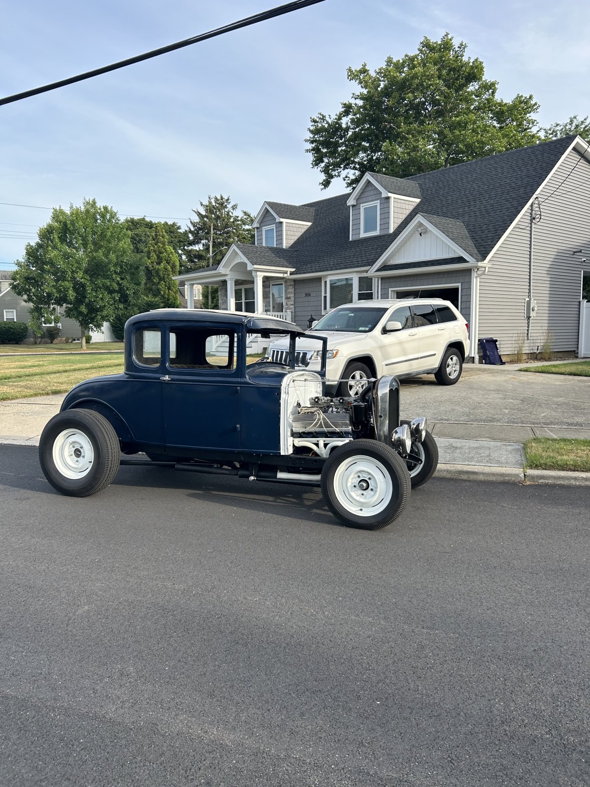

    here is a video of my 54 extended bell 331 running. It has a Ross roller cam, Howard roller lifters, roller rockers, Chevy big block rods, custom j and e pistons and chevy valves on stock 331 heads. Running a 56 2x4 with original Carter wcfbs. I am running Porter shorty mufflers. I have an original caddy dual batwing that I am trying to workout converting from oil bath that I look to run in the future

    Sounds great

    What a great build @tuff57 .
    Did they provide you with a cam spec card for that hyd roller?

    @Roothawg
    Sorry for the delay. Thanks for the compliments! I probably have it 90% tuned. Just dialing in the timing and carbs. I’ve put about 25 miles on it on a couple of short trips. Hoping for nice weather this weekend to take it for a good blast

    I enlarged the picture, always select full image when posting pictures
