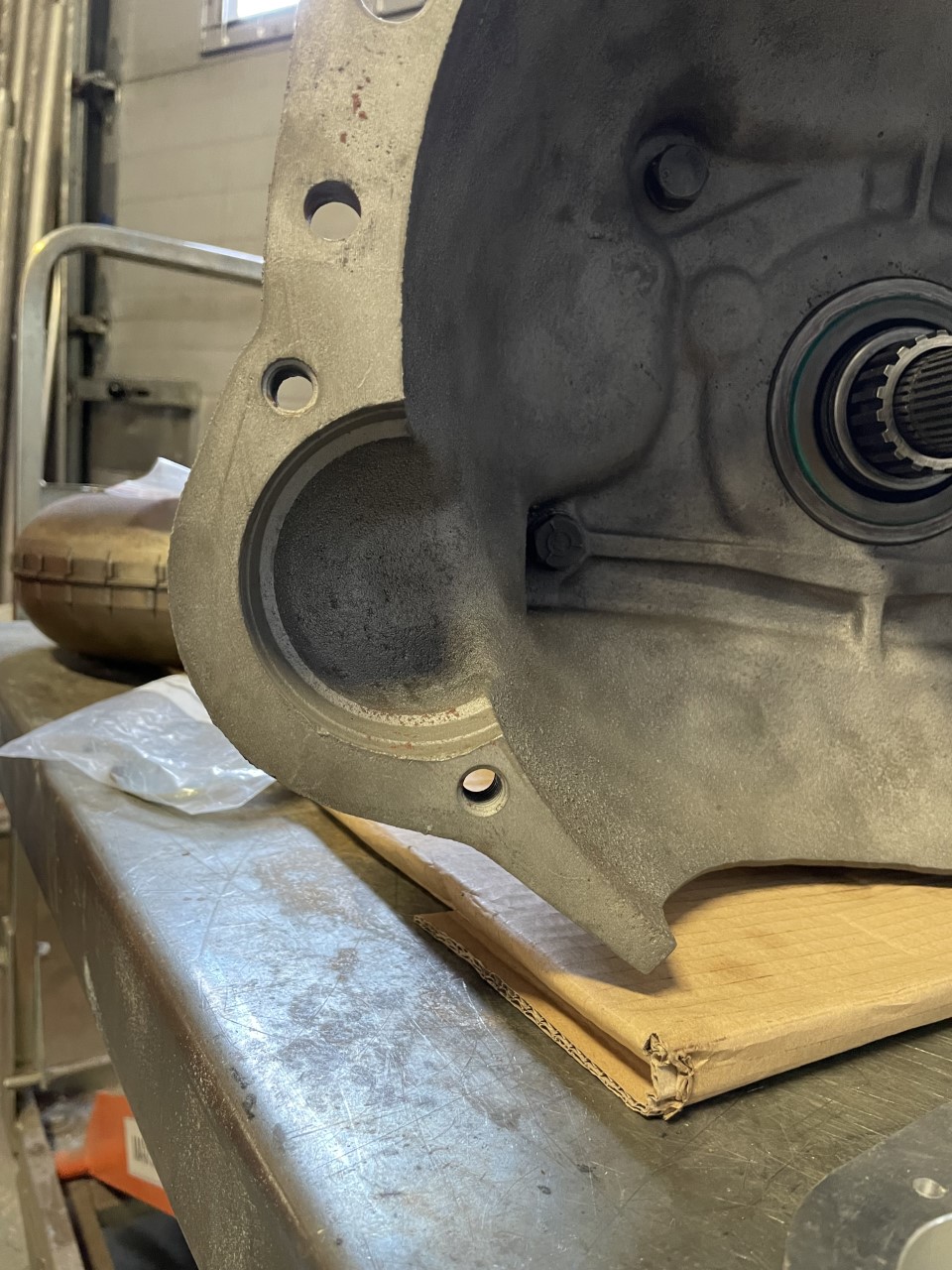

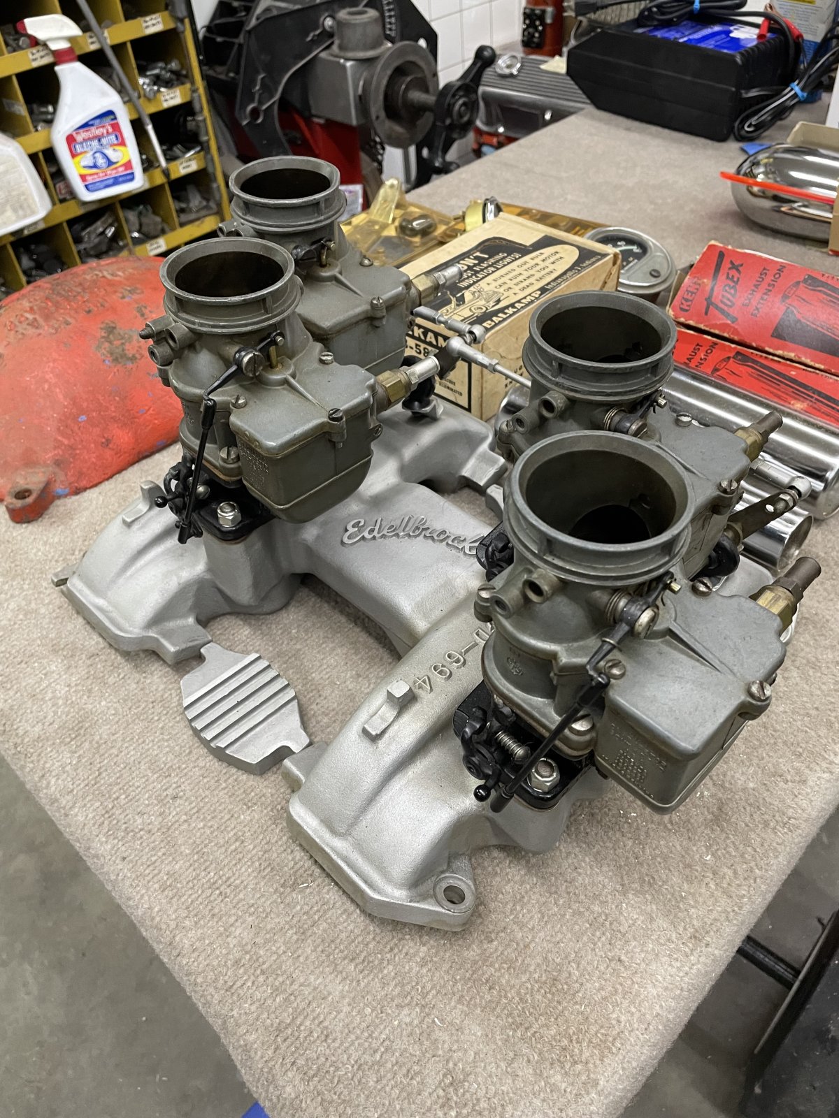

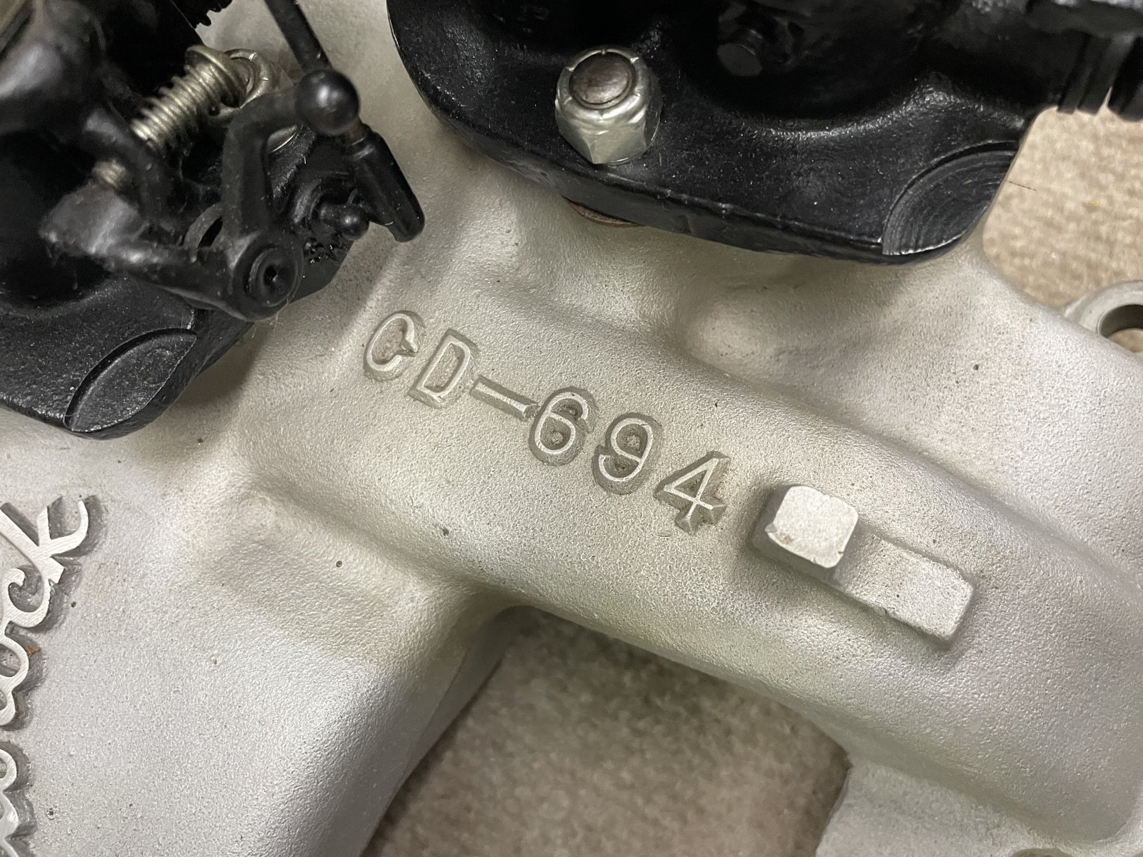

    How in the world do you find all these?

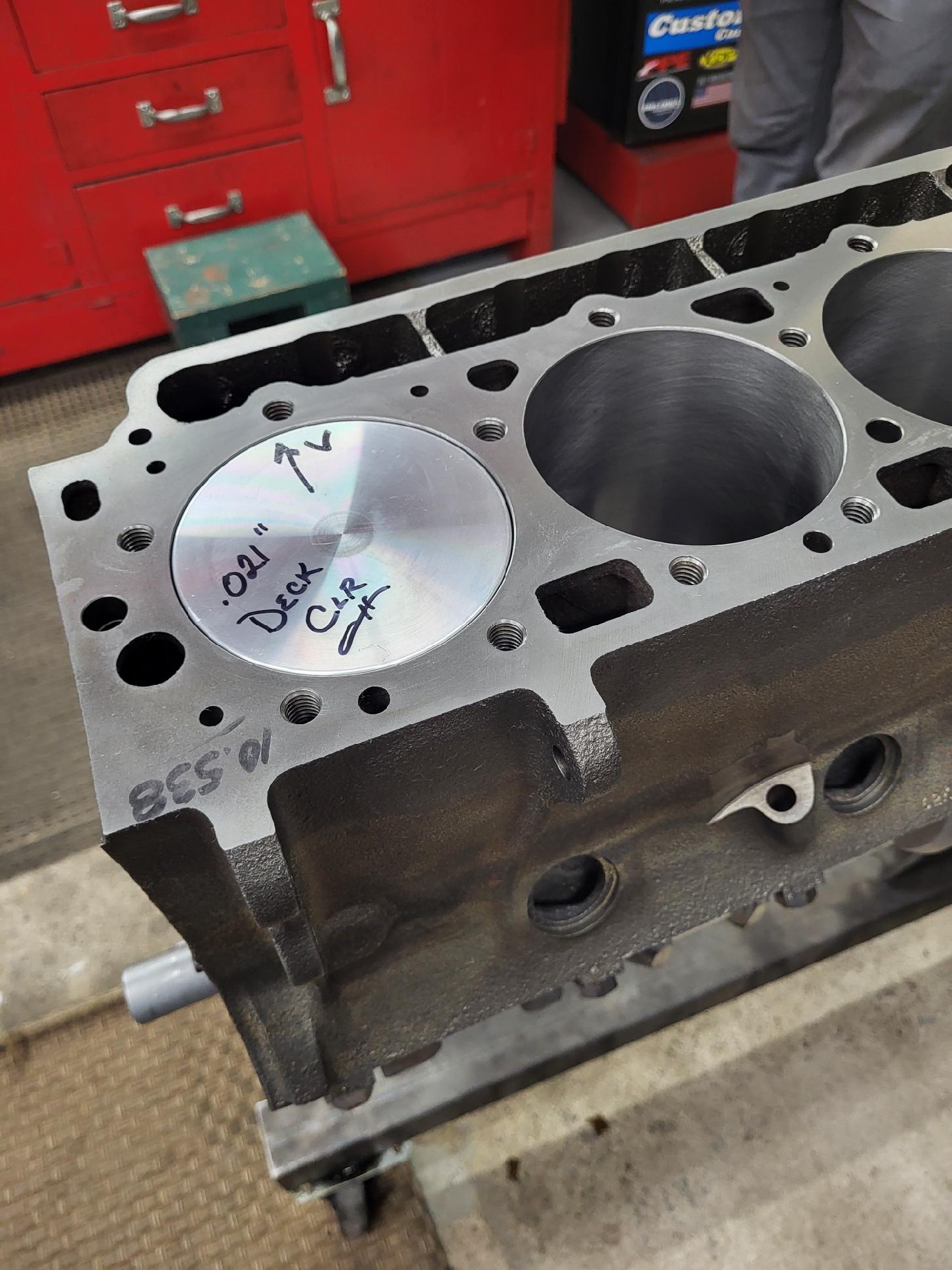

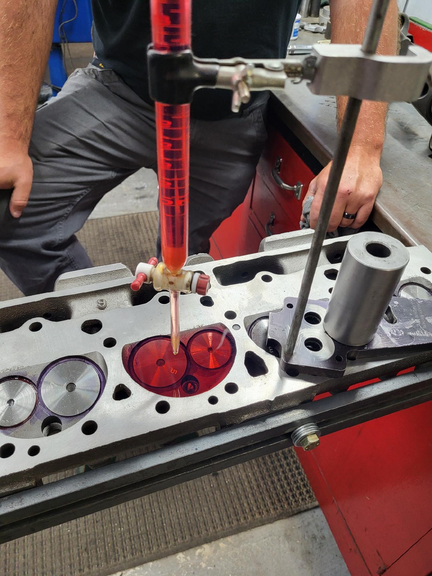

    Resized_20241011_105939_1728663383481.jpeg A little 390 progress Resized_20241011_100120_1728663392789.jpeg Resized_20241011_110510_1728663450936.jpeg IMG_3752.jpeg

    probably end up cutting some valve pockets. Anybody know of a good quality timing set or a way to change to a double roller set? The “Engine pro” set I bought changes the intake valve center line from 112 to 101
