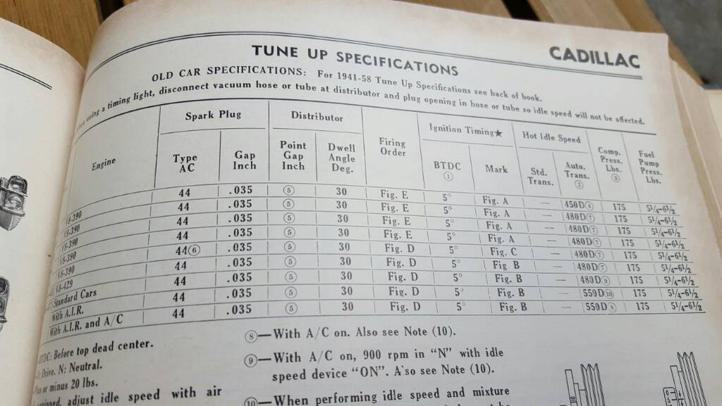

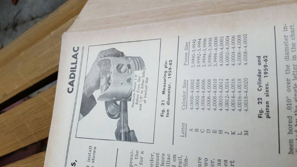

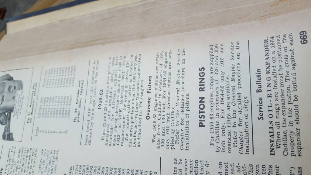

    all from a 67 manual. I have a 57 too but won't do you much good since the rods are longer. I'd call Kanter.
    Sent from my SM-G920R4 using H.A.M.B. mobile app
