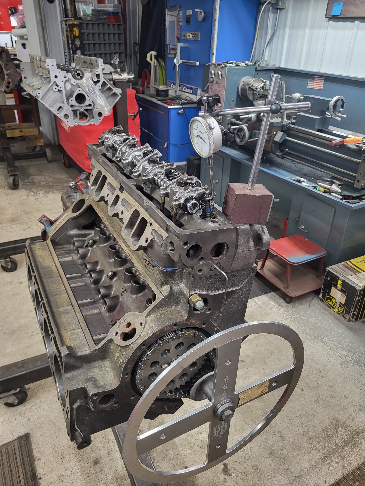

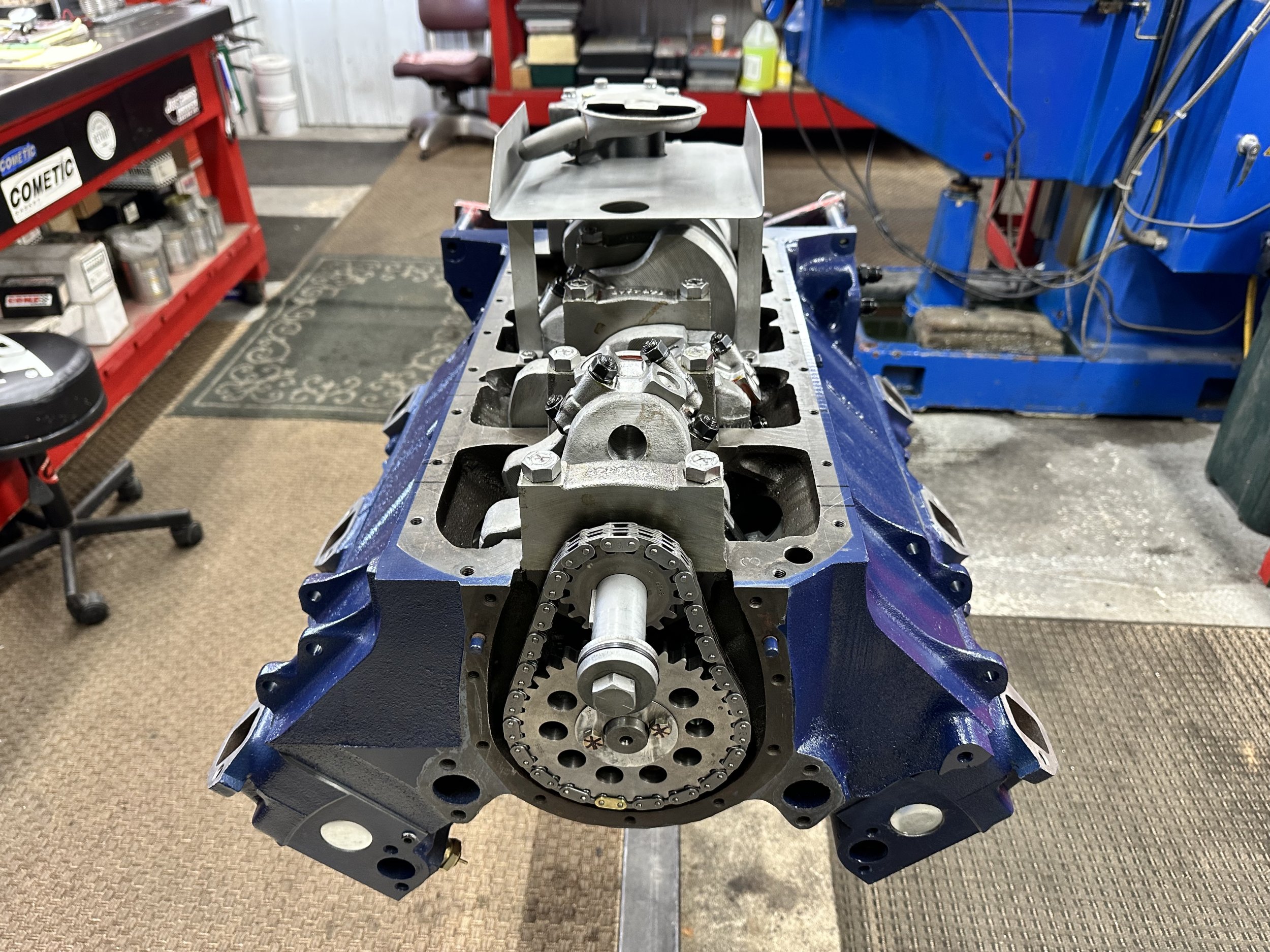

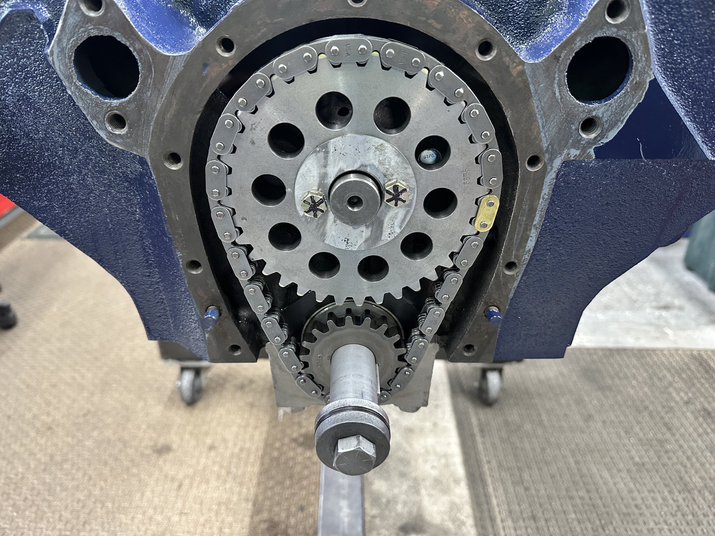

    We are talking about (if I have to use the timing chain set I have) possibly slotting the bolt holes and making an offset bushing for the cam gear.

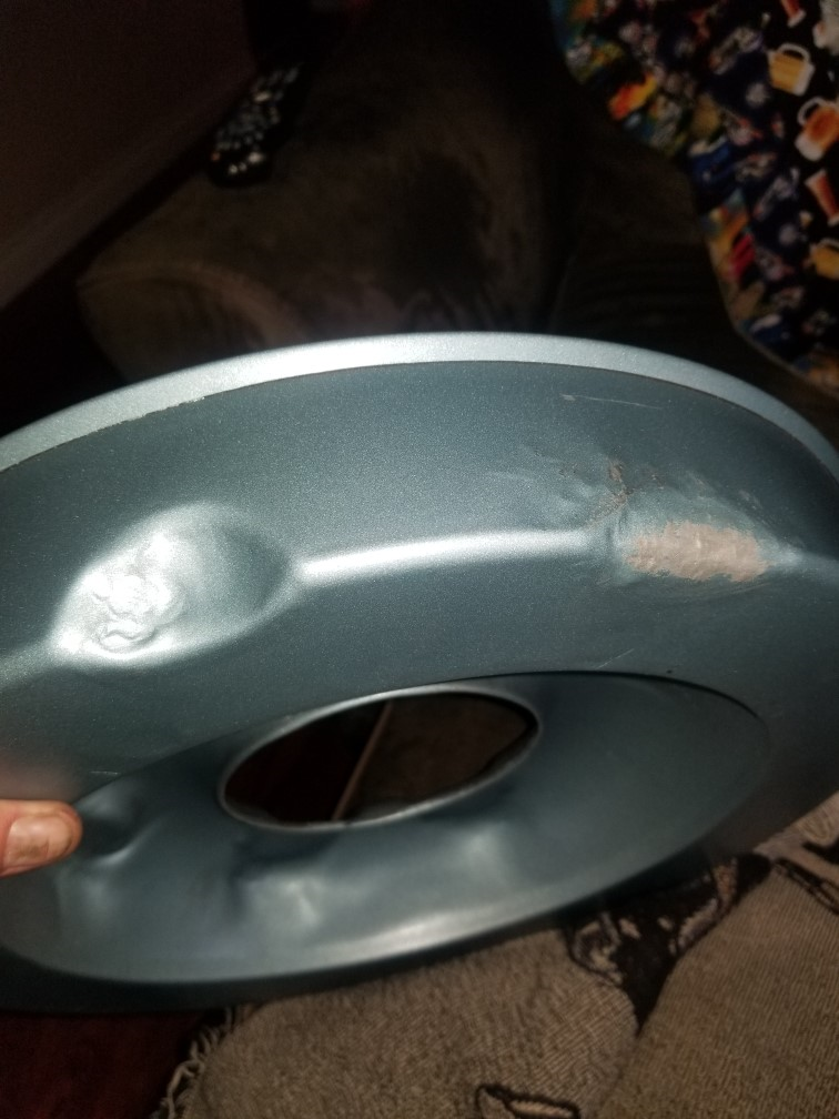

    No tech to add, other than if it hasn't been mentioned yet a fella can take the stock intake manifold and open up the 4 holes into a dual plane to gain some plenum volume. Makes a pretty big difference if you're on a budget and want to do something basically for free (except the price of intake gaskets, but you should have the heat crossover blocked anyway, so a good time to do that)....I also ground all the numbers and flash off my stock intake on this one, came out really clean, and obviously cleaned up the ports a bit....Air cleaner is from a '66-'67 Toronado that I metal finished the factory clearance dents out of. I felt it matched the Cadillac "V" pretty well, so I went with it for something different in my '60.

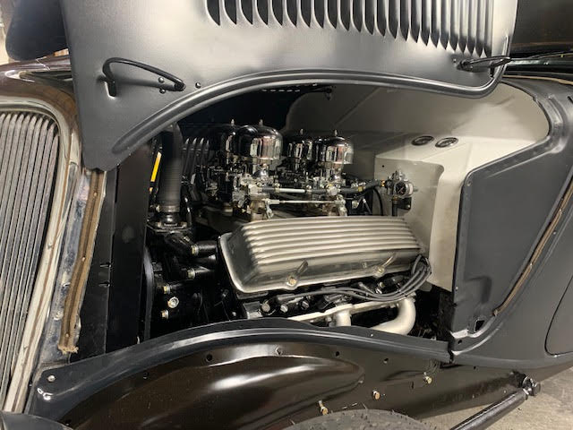

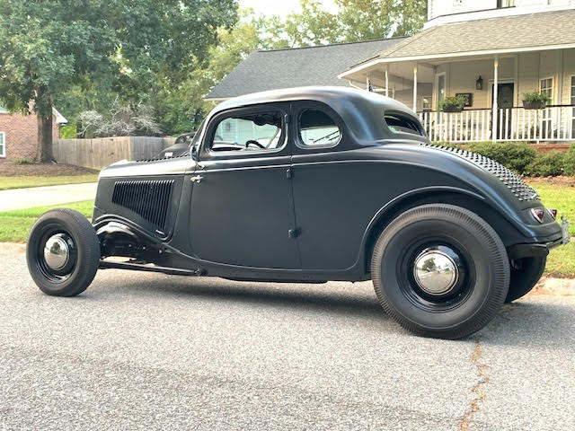

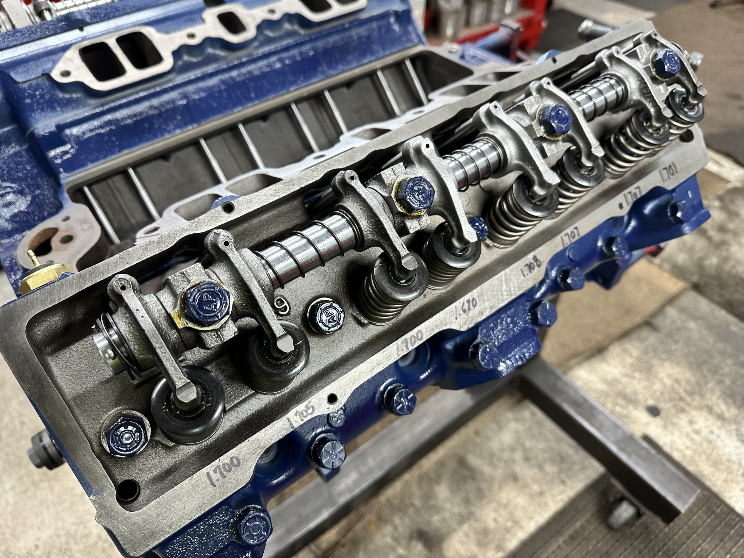

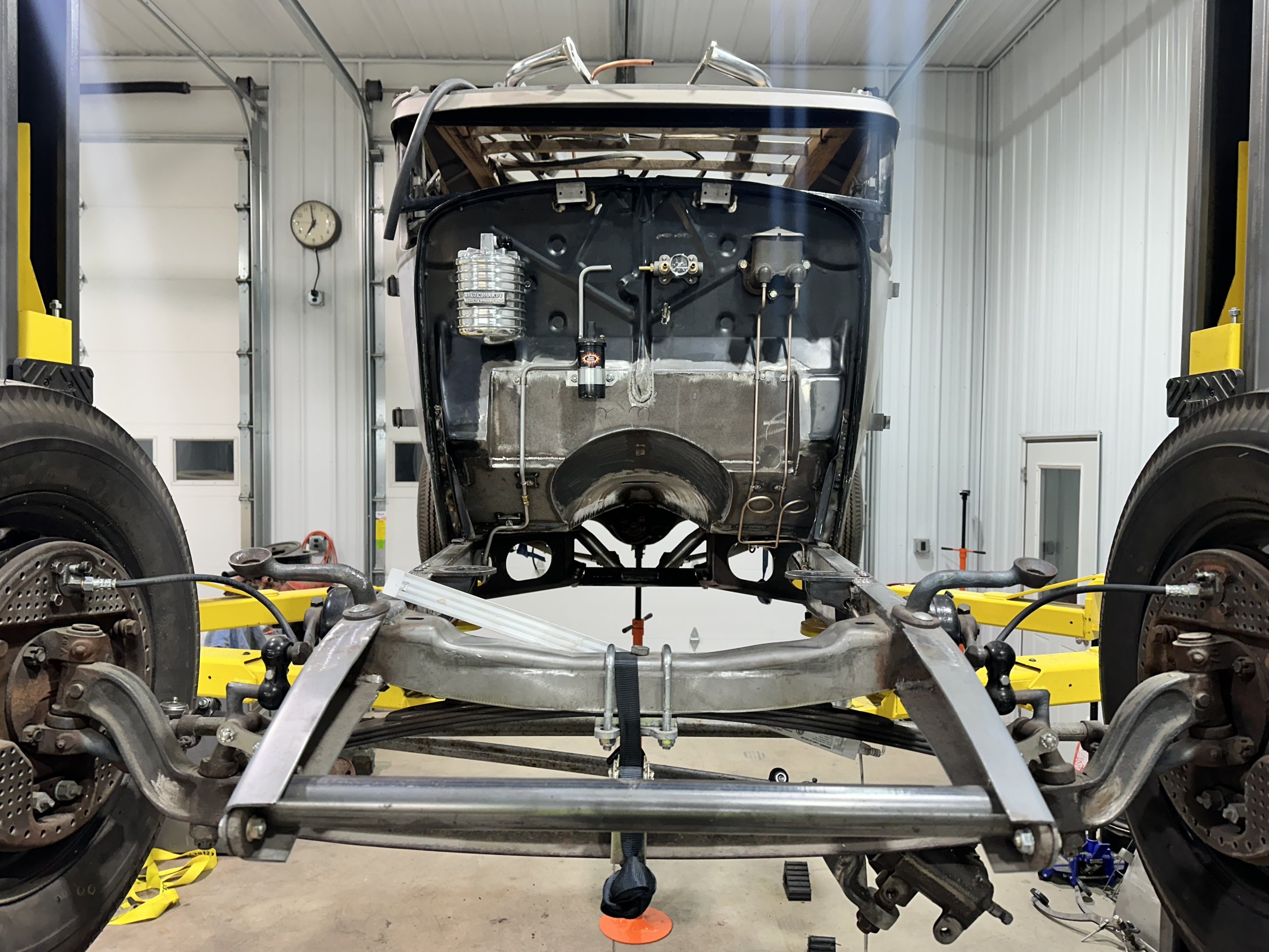

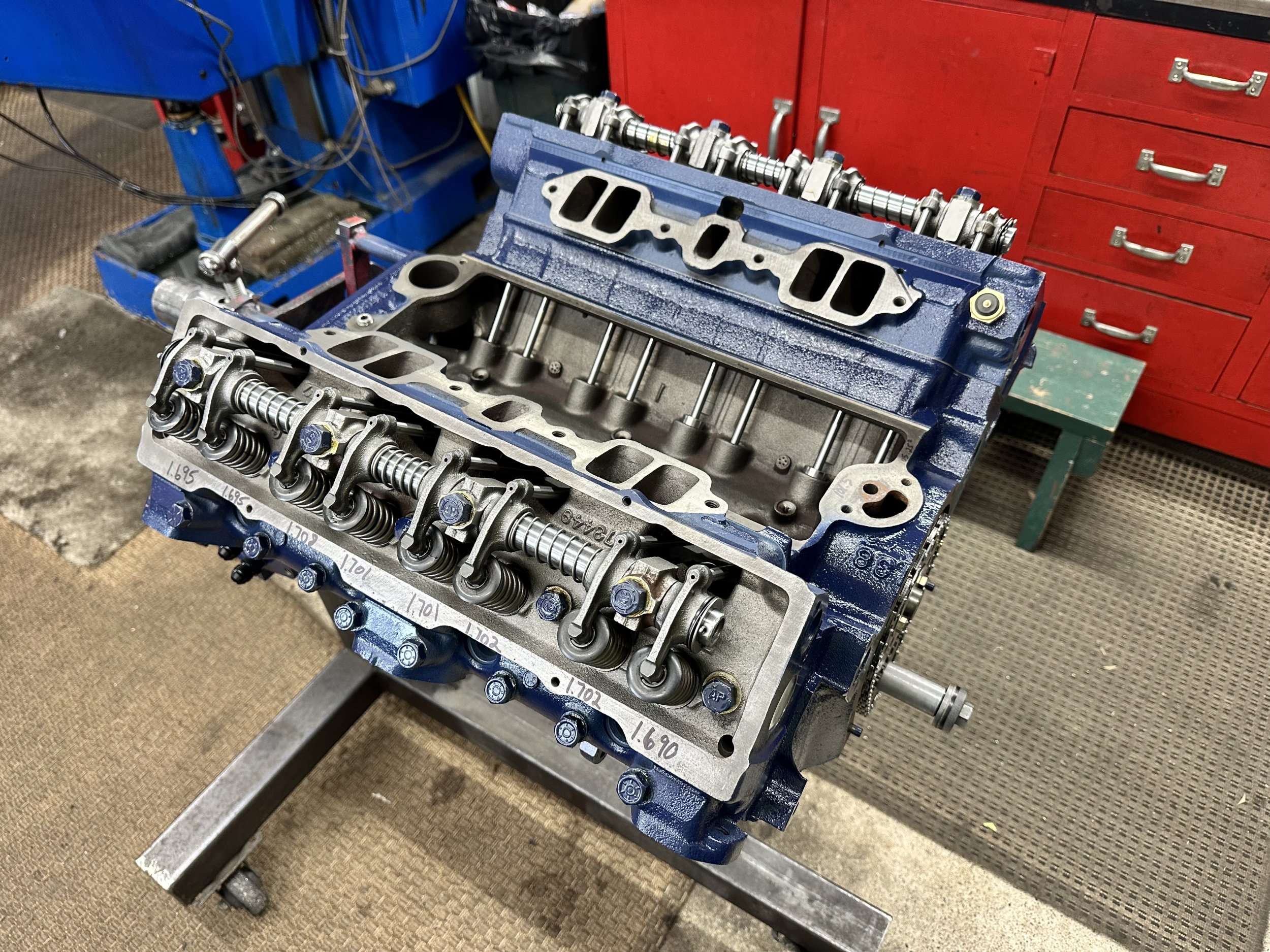

    I got the '62 390 for my '34 finished and I wanted to pile on some random information.
    The slot in the rocker shaft goes to the bottom. Also as important, there is an oil hole in the shaft which goes to the REAR of the rocker. If you have your rockers backwards, the oil hole in the shaft and rocker will line up and it will lose all of your oil out the hole.
    This is the hole all your oil runs out of if your rockers are on backwards.
    And, if you look closely, the rocker shaft stands have a particular order. The stands have a thick side and a thin side and they go like this. If not, your rocker tips won't line up with your valve tips and hell comes to breakfast.
    I don't have too many miles on her, but she runs great so far. You can definitely tell it makes 430 # of torque.
    Here is the car.
    See ya, -Abone.
  9. warbird1
    Joined: Jan 3, 2015
    Posts: 1,360
    warbird1
    ^^^^^^ What he said about rocker arm shaft alignment.^^^^
    Both of my Cad engines had been previously ***embled by chevy boys. Ruined the rockers and shafts on both of them and bent some valves and pushrods on the 390.

    I have a question on the timing chain issue so is the only big issue of using a sbc chain and gear set the crank diameter I’ve been following along here forever it seems and my plan is to have my 390 supercharged but I can’t seem to find a crank hub to buy that will fit also if I had to turn the crank snout down for a sbc timing gear that would solve two problems at the same time for my issue and yes mine will probly end up in my dragster with lots of boost and probly methanol for fuel
  11. warbird1
    Joined: Jan 3, 2015
    Posts: 1,360
    warbird1
    The problem isn't that the Cadillac crank snout is too large to fit the sbc crank sprocket, but that it is too small. You either have to Mickey Mouse a bushing to make up for the larger inside diameter of the sbc sprocket which probably wouldn't hold up too well, or put a larger diameter snout on the Cad. crankshaft.
  12. wrenchbender
    Joined: Sep 5, 2007
    Posts: 2,489
    wrenchbender
    Thanks for the info I was under the impression it was too big and so that just makes things even more difficult I guess I’ll just make everything like I do on all my builds all because I can’t leave well enough alone lol.

  18. Mike Paul
    Joined: Oct 10, 2003
    Posts: 1,038
    Mike Paul
    this is what we came up with as far as an offset bushing. It is within a couple degrees of the cam card now but this is the only bushing he had. We ordered a couple more different ones today to get it dead nuts. We are going to make some kind of retainer to hold the bushing from coming out. I’ll post pictures of that when it’s done.

    So if we swapped the crank snout to SBC.. we would have to :
    1.get a different timing cover seal
    2. a different timing set crank gear (cam gear still works or are we using all whole SBC timing set?)
    3. new harmonic balancer (we COULD use an ATI balancer now for SBC as a bolt on roughly?)
    4. Cut, adjust, shim, lower crank pulley to fit
    I think this is all that would be needed? Am I missing something?
    This path (if not too expensive to swap the crank snout), may actually get a quality balancer on the engine, with gilmer pulley / drive off of an ATI balancer hub I think..
    winduptoy and Scotty's Garage! like this.
  20. warbird1
    Joined: Jan 3, 2015
    Posts: 1,360
    warbird1
    1. Yes, depending upon the O.D. of the balancer you end up using. You may have to
    modify the timing cover.
    2. You'll have to use the sbc crank gear; and since you're doing this to get a roller type timing chain you'll also have to modify the sbc cam sprocket to fit the Cadillac camshaft. Use the complete sbc timing set.
    3. Yes, you'll have to finger that out...
    4. Yes, more fabrication...
    Good luck with this, keep us posted

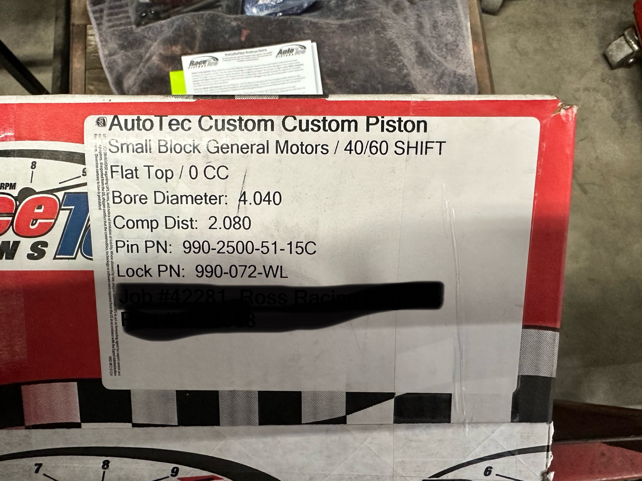

  21. Mike Paul
    Posts: 1,038
    Mike Paul

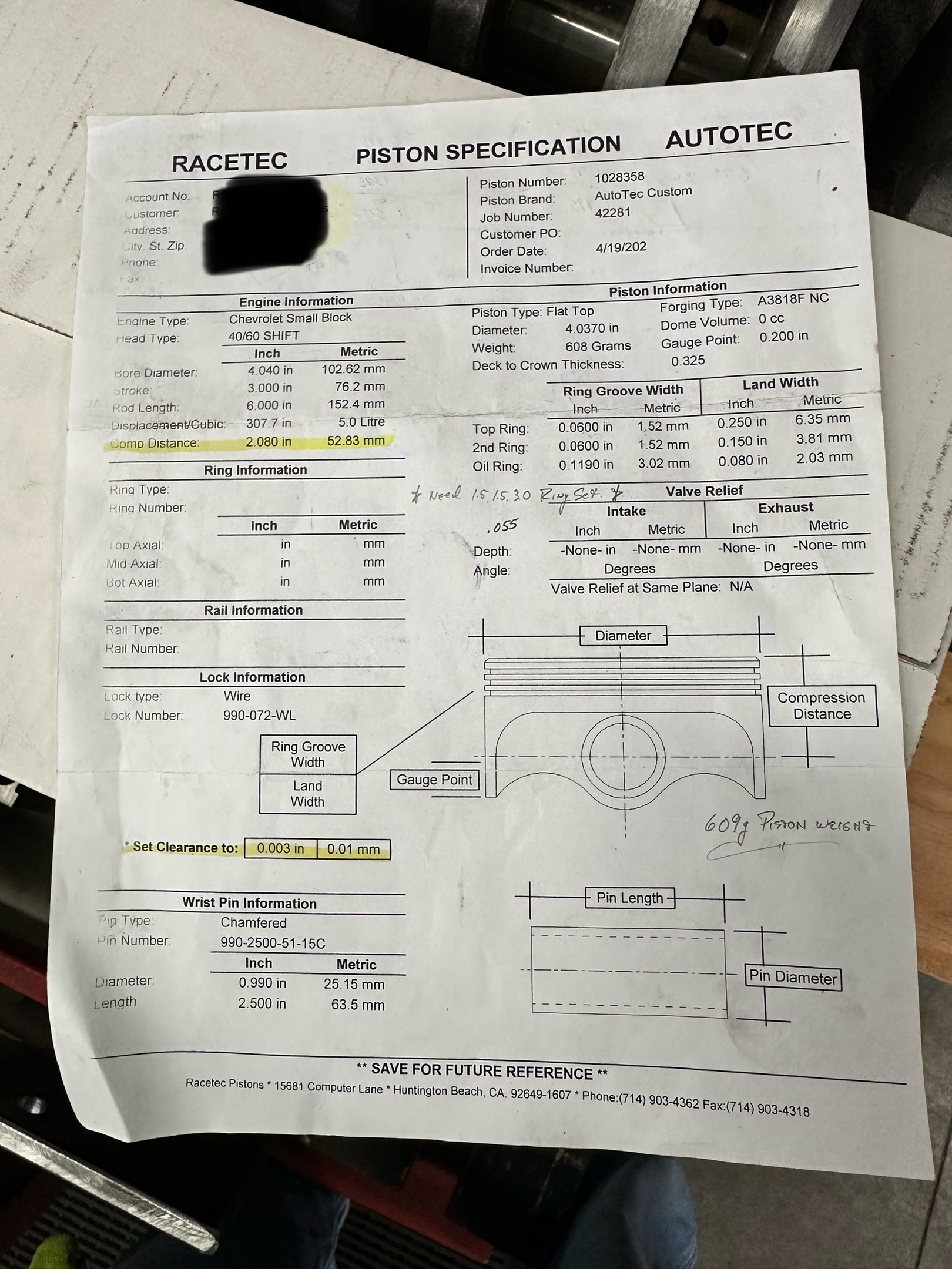

    Here’s the info on my 390 pistons for those who have asked IMG_3796.jpeg IMG_3795.jpeg
    jet996, winduptoy, rod1 and 2 others like this.

  23. Mike Paul
    Posts: 1,038
    Mike Paul
    Yes they are. With ARP rod bolts, floating pins and bushings

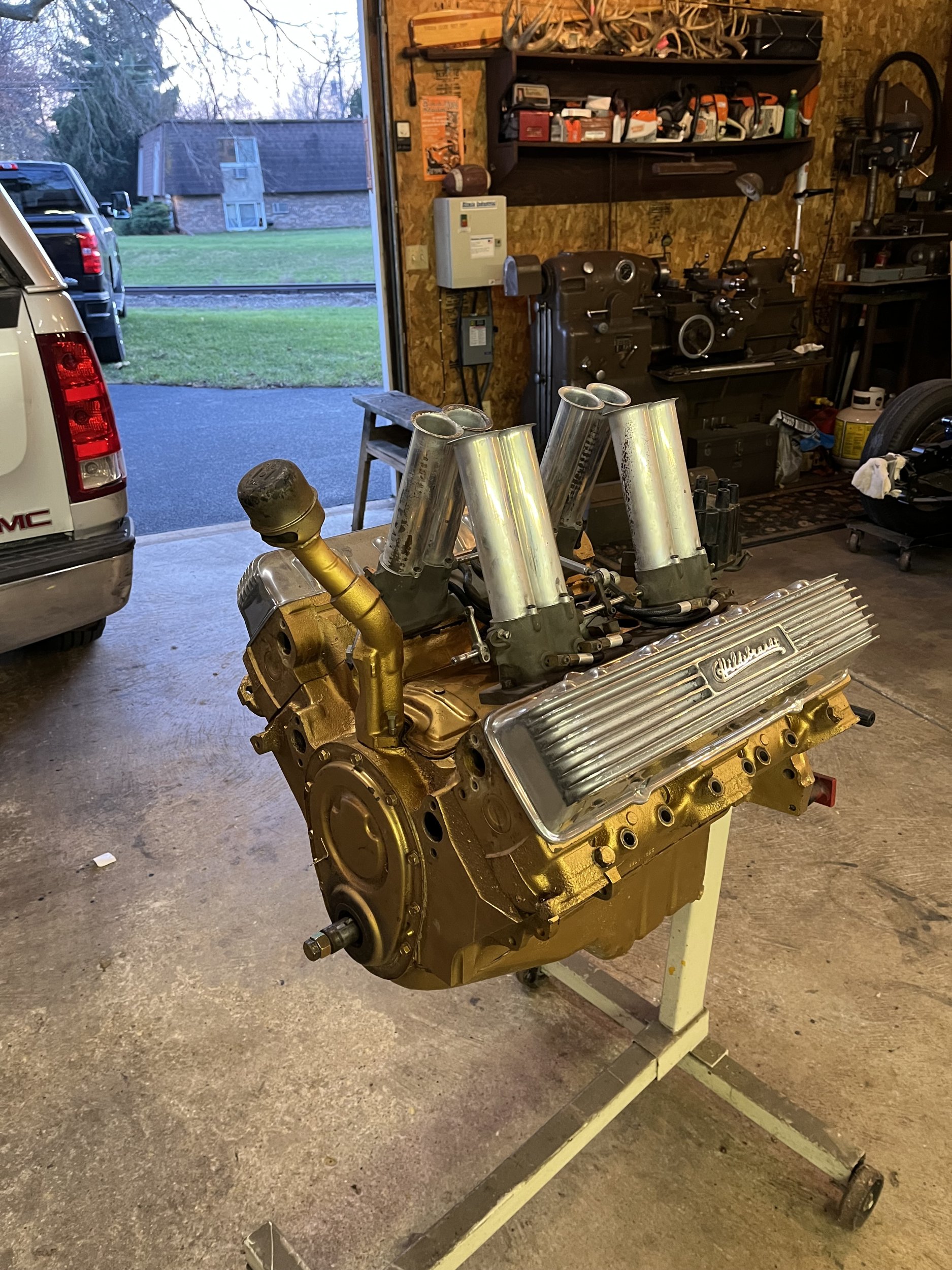

    from Byron Ill
    I’ve had these Cadillac speed parts for years. The injector pump adaptor isn’t in the picture, but I have it. I just picked up this 62 390 yesterday from Torkwrench and thought it would be something you guys might like to see. It’s a project, but appears to be a good foundation for a build.

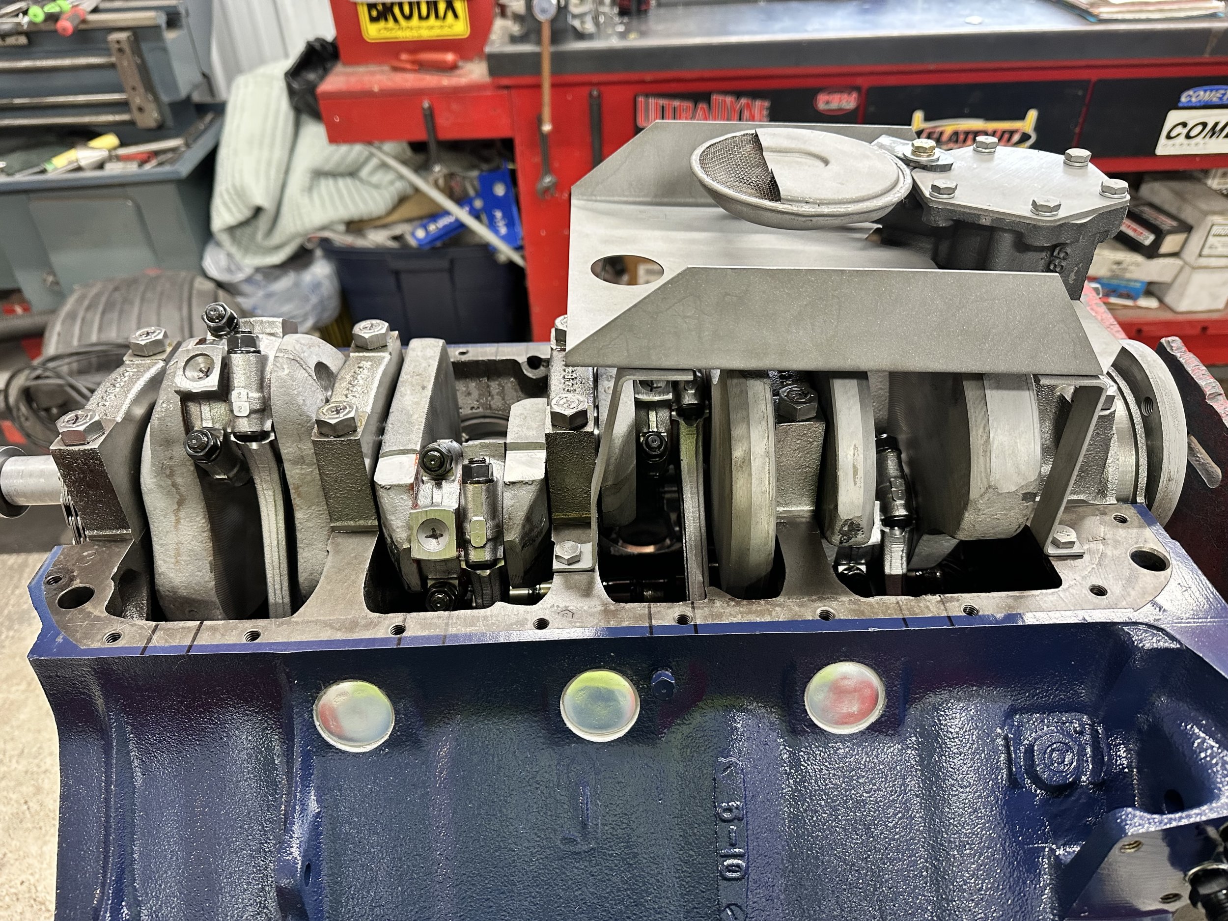

  25. Mike Paul
    Posts: 1,038
    Mike Paul

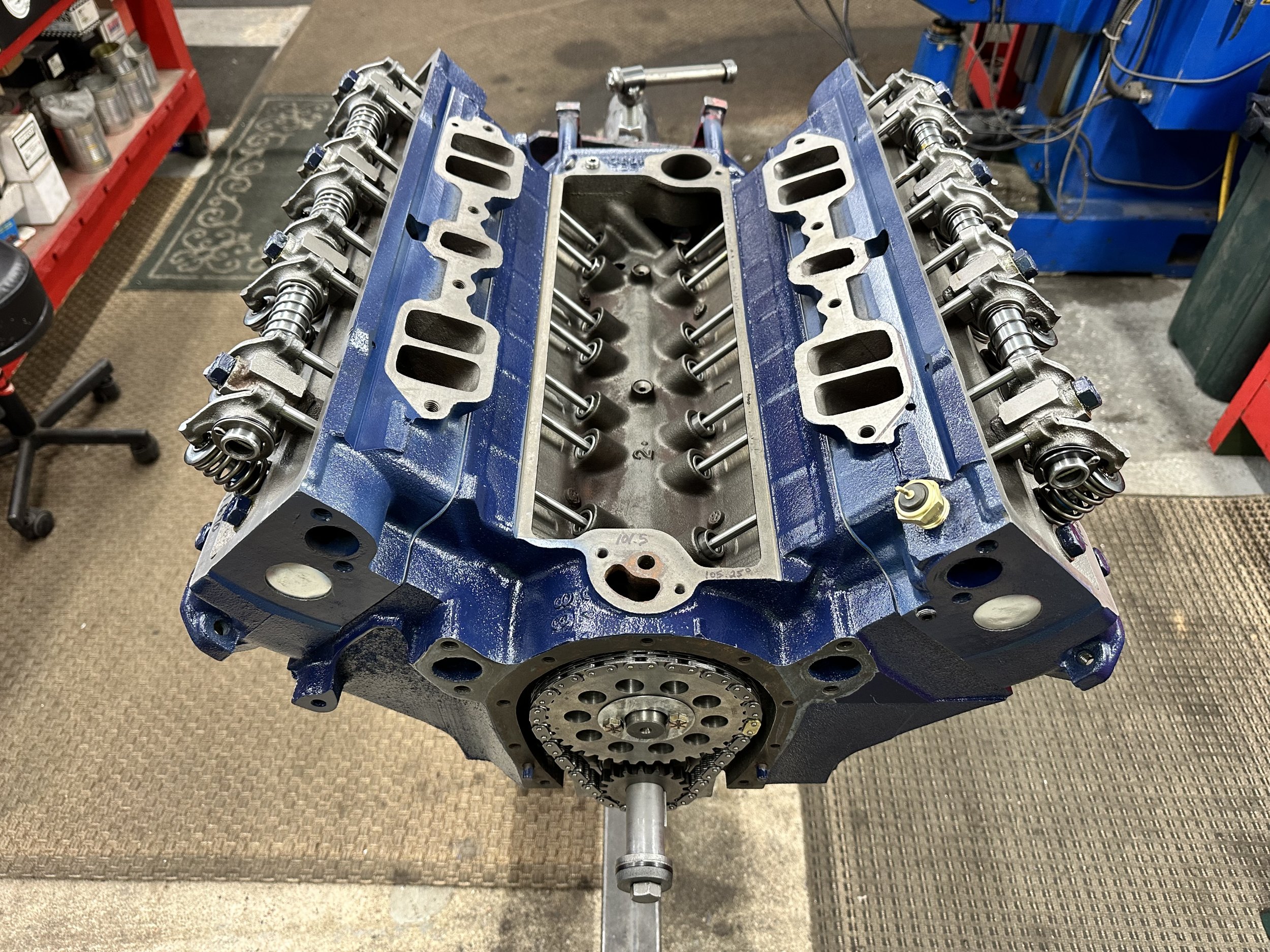

    IMG_3846.jpeg IMG_3845.jpeg IMG_3847.jpeg IMG_3848.jpeg IMG_3841.jpeg IMG_3842.jpeg IMG_3843.jpeg IMG_3840.jpeg IMG_3844.jpeg IMG_3849.jpeg Long block ***embly pretty much done
