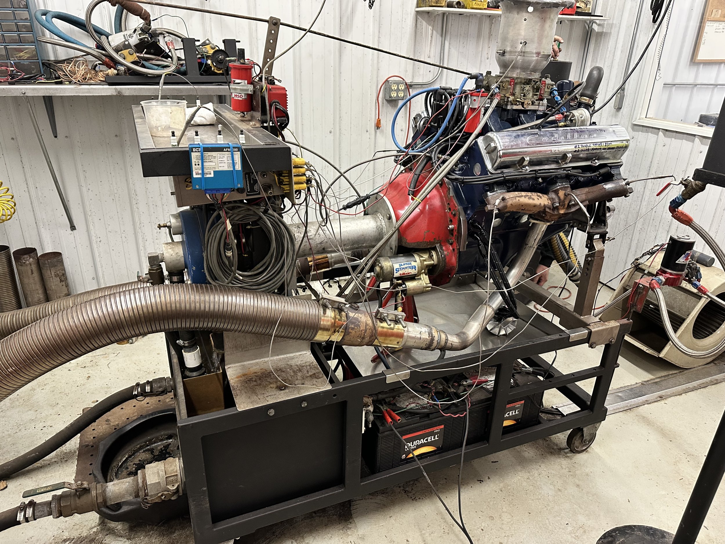

    Me too! The only thing is I don’t know how accurate the numbers will be on it because we are using the dyno Holley 4 bbl on the stock intake, instead of the 6x2 drag star because I don’t have the Strombergs ready yet. Also the stock exhaust manifolds instead of my chrome headers because they want to install O2 sensors

    I hope there are a few break in runs and at least a couple power pulls for a graph. How big is the dyno carb? I mean it's not the drag star setup .. but if it's the late 390 intake it should work well no? I hope you get it to 400hp.. but maybe I'm crazy hoping for that. Are you going to rev it to at least 5500 as well?

    Not sure on the carb size, he did say it was easy to change the jetting without removing the bowls. I have a 650 double pumper I was going to use but he suggested using the dyno carb. Hoping to get one horse per cube so around that 400 hp would be great. We plan on a couple power pulls to see what it likes for timing and fuel

    I know for the math 650 likely works fine but in reality I wouldn't be surprised if they put a 750 or larger on that thing. Either way I'm excited to see your results as I'm about to start a 390 build myself.

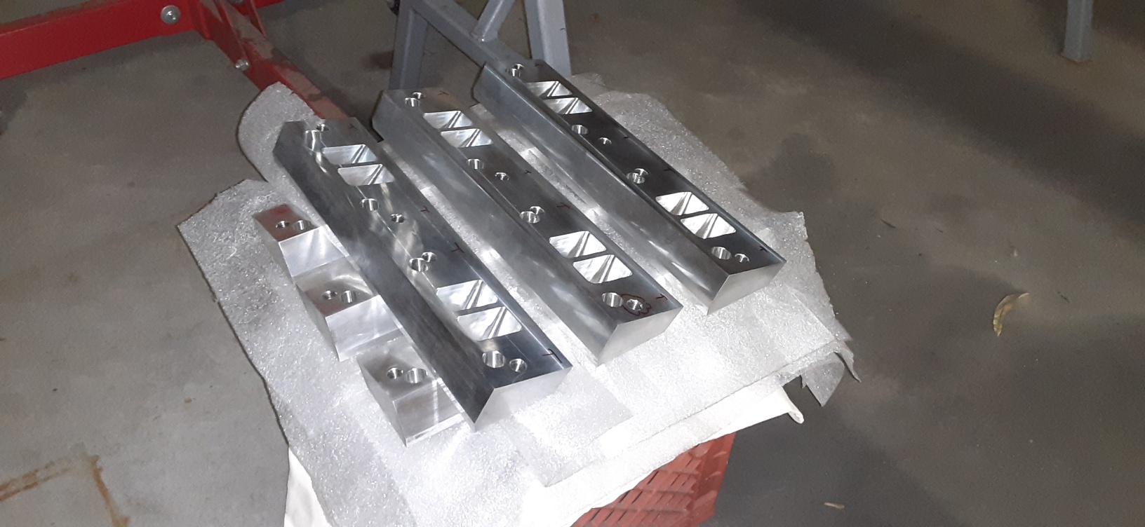

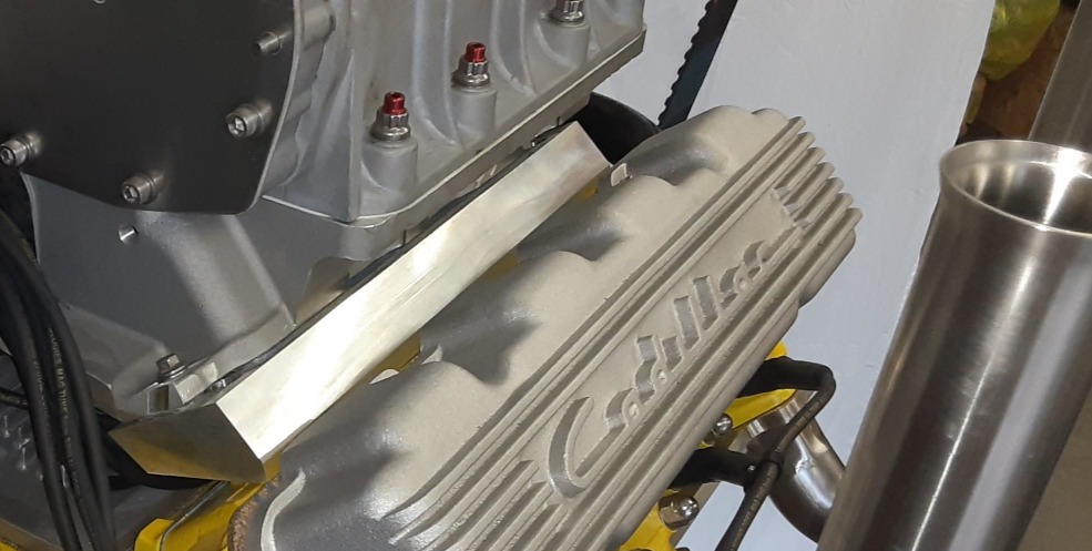

    Thinking about making a small run of this alternator bracket arm I fabbed up yesterday. Local fab shop has a CNC plasma. If I get enough interest I will get prices. Works on 390’s with the accessory hole and a small Denso alternator.

    Did you ever get the Caddy on the dyno?

    We did. The stock 4 barrel intake only flows 400 cfm and with the stock exhaust manifolds it put up numbers a little better than factory. Once I get the Strombergs done we are going to run it on the dyno again with headers.
    we did play with oil pump pressure relief springs a bit and found we were able to get the cold idle pressure to 60 psi, 30 psi hot idle and 50 psi at 5000 rpm with the engine up to temperature. I’m pretty happy with that. We ended up putting in a double spring and one of them I believe is from a duramax. I’ll find out more information to be sure

    I'd be interested to know what the O2 sensors told you about the mixture distribution for all the cylinders...

    I would say you could lean it up a bit on the big end and gain some power but that is a safe tune for sure

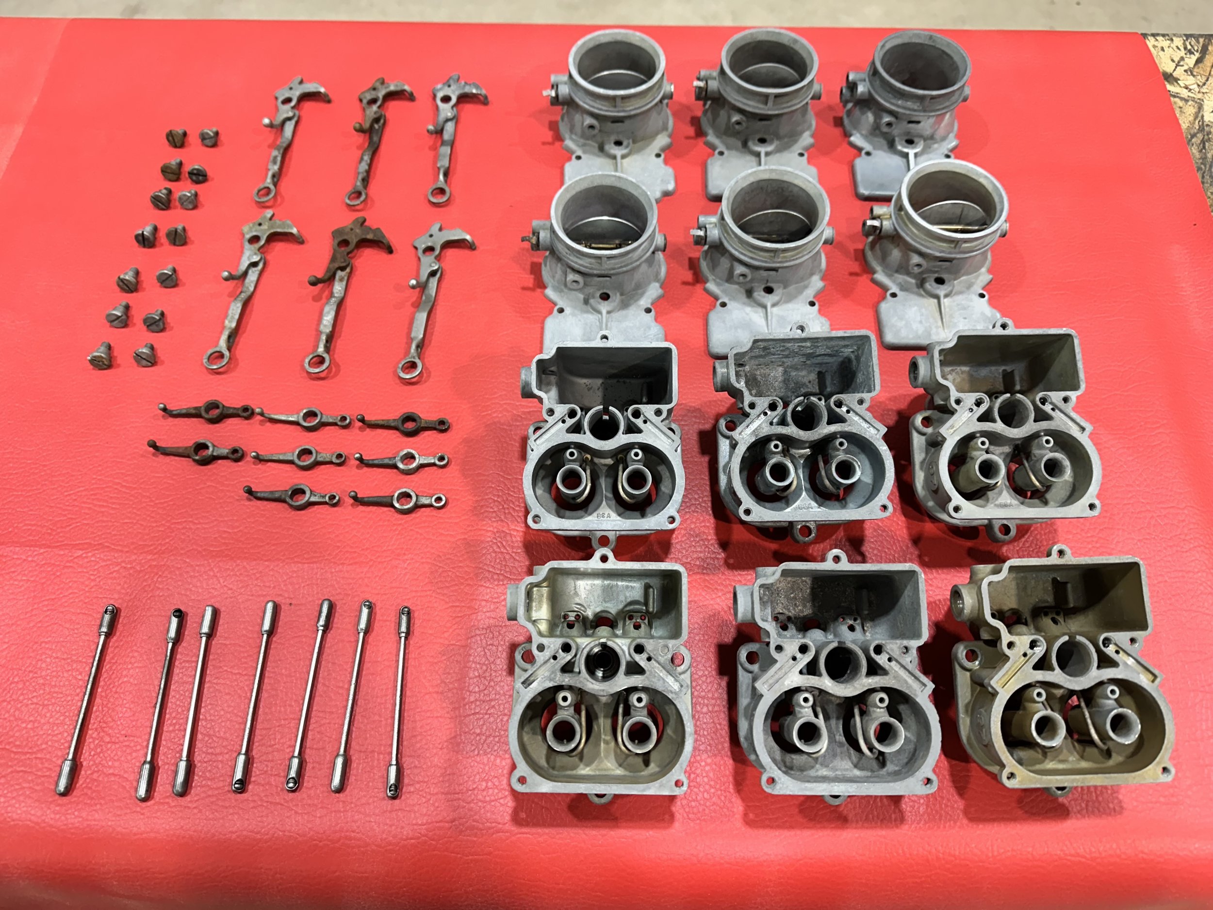

    OK, its been four years since I started this project and they're finally ready. I'll post adds next week on the appropriate page here and on other Caddy and hot rod sites. Been battling cancer and that is why it took so long. The adapters bolt on with standard Caddy gaskets and The intake uses a standard SBC gasket, trimmed to length. ISO .JPG l7.JPG 2.JPG 20250706_06.jpg

    Mike, did you get the Strombergs set up and dynoed at all?
