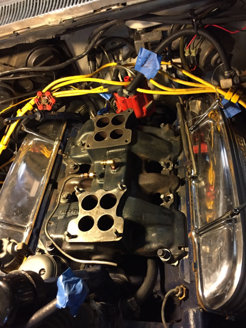

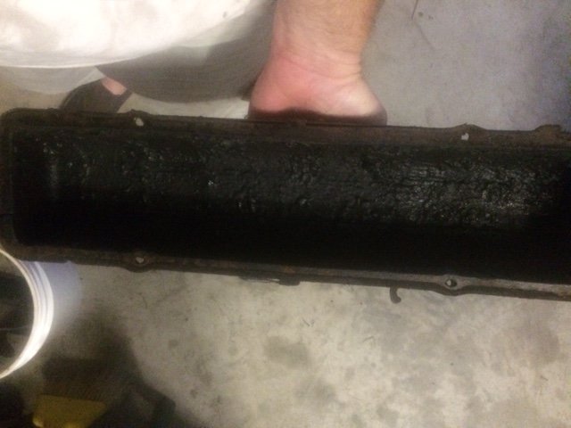

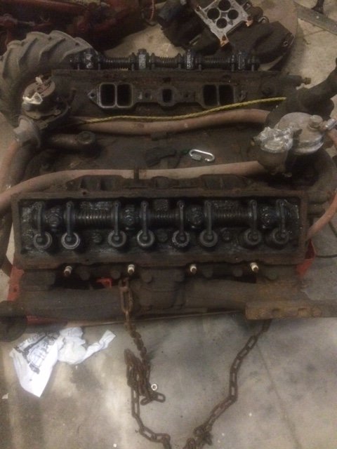

  2. Roothawg
    Joined: Mar 14, 2001
    Posts: 25,950
    Roothawg
    I couldn't resist. I know I don't have time to mess with it, but I wanted to look and see what was lurking under the intake and valve covers. Looks like the intake is cracked in the usual places. Looks like this thing shouldn't have any rust, it is all covered in 2" of old greasy oil byproduct.
    The valve covers weigh about 10#.

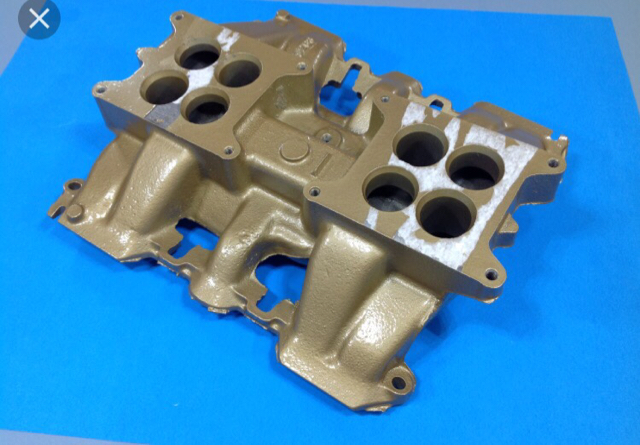

  6. clunker
    Joined: Feb 23, 2011
    Posts: 1,609
    clunker
    from Boston MA
    These Caddy cast iron dual quads come up a lot, usually pretty pricy but I got the manifold w/ original Rochesters and linkage for around $350 on Ebay. The carbs needed work but it's pretty nice. My car weighs 5000 pounds so I'm not worried about the weight. With adapters you can run AFBs if that's your poison. Just fab a linkage for your tv rod if you have an automatic ******. The manifolds by themselves are all over ebay for $300. A lot have some cracks but if you use Crown Alloys 44-30 you can cold weld and tamp it with a pneumatic peening hammer after 1/2" shots.
    The single four barrel manifolds work just as well, just not as ***y. There is a lot of finned stuff for these motors, headers etc. The 390's are pretty much bored and stroked already and have serious torque, (435 lbs), Even the 331's are pretty butch. I'm a big fan.

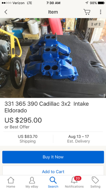

  13. clunker
    Posts: 1,609
    clunker
    from Boston MA
    There's a good deal on the 'Bay right now for a tri power manifold, and one for an ok dual quad, just for your info, not sure you want to go down that rabbit hole ImageUploadedByH.A.M.B.1470828869.285538.jpg

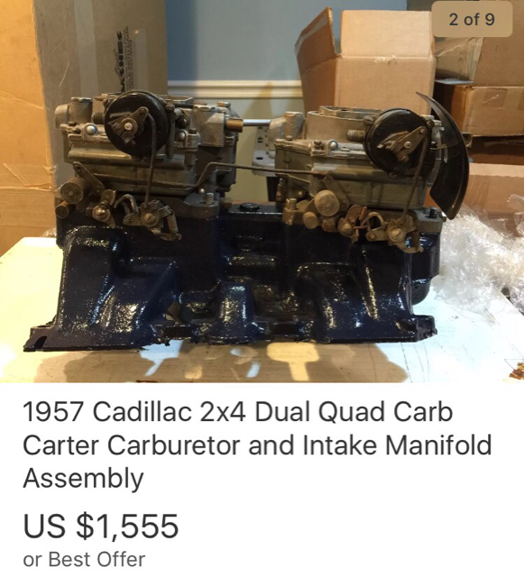

  25. clunker
    Posts: 1,609
    clunker
    from Boston MA
    They appear less often, but if you keep your eye open they do come up.
    There's a whole 57 Carter 2x4 set up on the 'Bay now ImageUploadedByH.A.M.B.1470951595.704057.jpg
    But it's $1500. There's no fun in paying $1500.
    winduptoy and Roothawg like this.

  27. carbking
    Joined: Dec 20, 2008
    Posts: 3,959
    carbking
    If the chokes are original and not broken.......dirt cheap. Note the picture is on the side opposite the chokes.
    Jon.
    winduptoy likes this.
  28. clunker
    Posts: 1,609
    clunker
    from Boston MA
    It does have the original chokes, everything looks really good. It is a screaming deal but I don't think it's within Roothawg's budget for his project.
