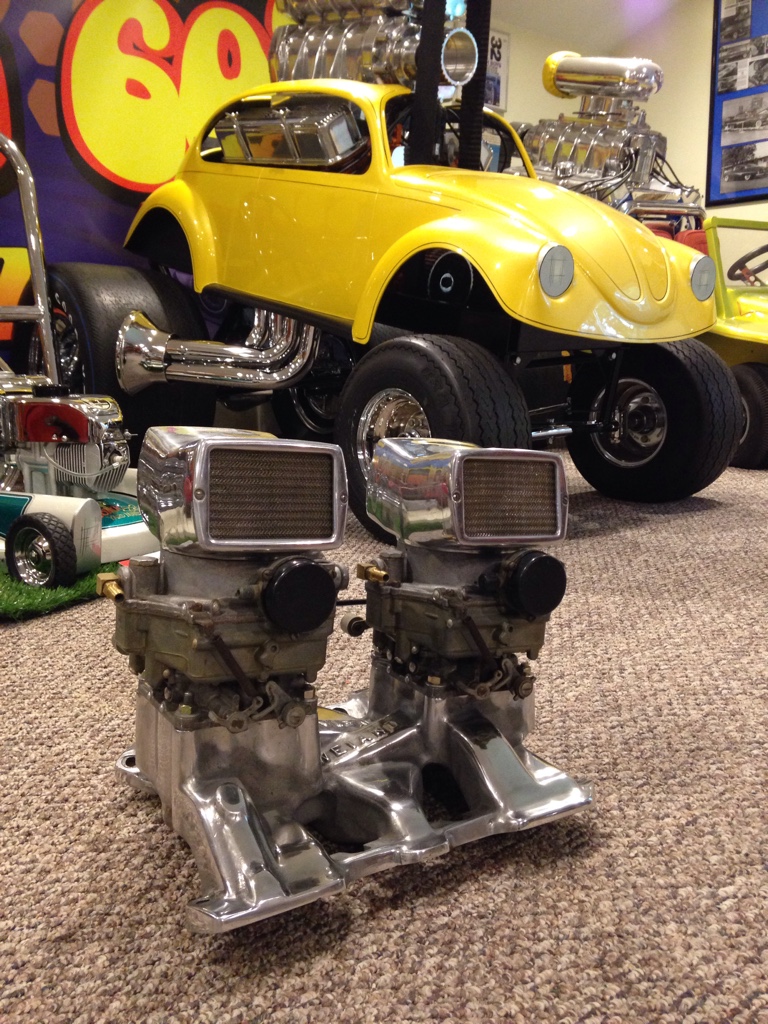

    I don't know much about the old Rochesters. Do they seal up decent (throttle shaft wise) ? Can I still get OH kits etc? Any idea on the cfm range? Are we talking 4GC series?

    A lot of haters for these old carbs, but I'm a fan. Even on ebay you can buy cheap cores, (most have frozen throttle shafts so just make sure you get cores where the shafts aren't seized) kits are all over and cheap. I bought boxes of cores so I could have lots of spare parts. A frozen clapped out core might be $30, but have good floats, which are like $90 for a set, etc.
    Modern CFM standards are a bit different, but short answer is 4gc's came in 500, 600 and 700 cfms, based on their bores which varied.
    Take minute to read this:
    http://wildaboutcarsonline.com/memb...ine_Modification_and_Tuning_Rochester_4GC.pdf
    winduptoy likes this.

    I think you really need the manifold that takes AFB's don"t you? these small WCFB's may not be large enough for you...

    The 1957 factory intake will take early, small AFB's, and is the only one of the factory intakes that will.
    The throttle center-lines on the larger AFB's was moved apart from the early small AFB's, so larger AFB's on a factory manifold would require either adapters or milling the intake, even though they will bolt on (the throttle plates will hit the manifold).
    Jon.

    Good info. I think moriarity is just taking the piss out of roothawg, he's taunting him with that sick Weiand intake.

    I think they would be enough.

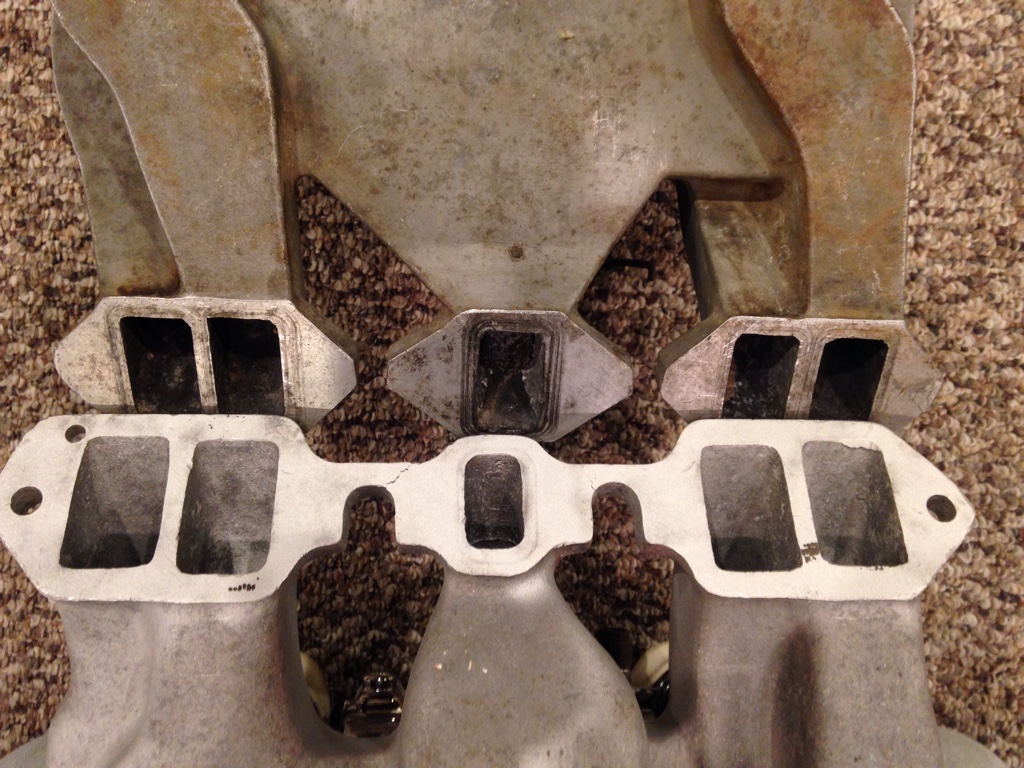

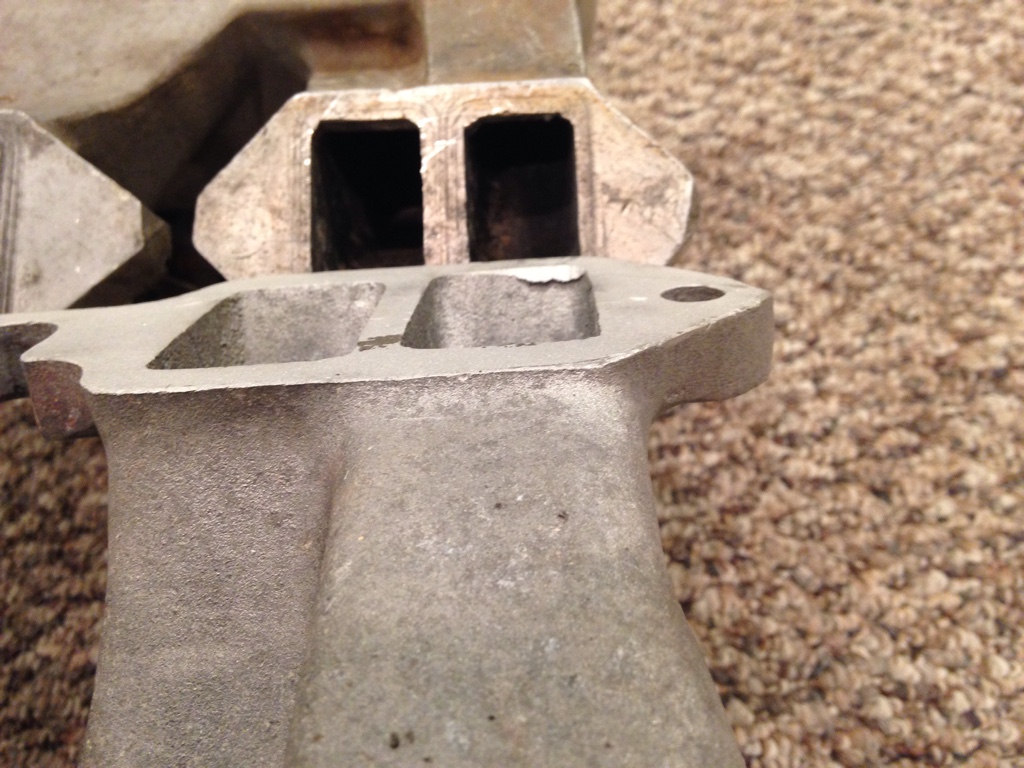

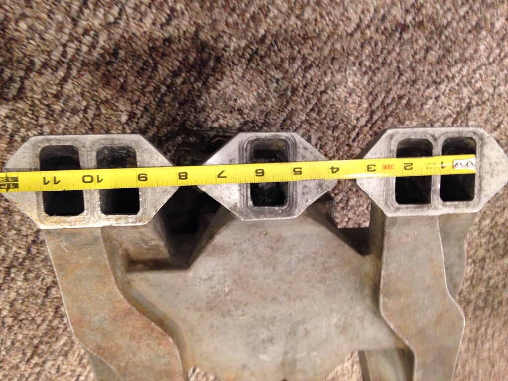

  18. Moriarity
    Joined: Apr 11, 2001
    Posts: 37,355
    Moriarity
    SUPER MODERATOR
    Ok, I looked and did not have a caddy intake gasket so I set the offy stude manifold next to a weiand caddy manifold and it looks way off to me.
    The first pic will show that the front of the ports are lined up[​IMG]
    The next pic is overall showing the mismatch[​IMG]
    The next one is the closeup of the mismatch [​IMG]
    Then I measured the length of ports front to back, the stude is 11 1/4"[​IMG]
    The caddy is 12"[​IMG]
    I don't think this would work very well. Has anyone here actually done it??
