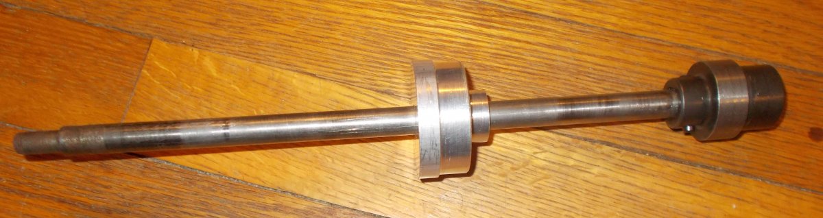

    About to first time fire the rebuilt '57 Cadillac 365. Whipped up this oil pump priming tool. Cut an old distributor gear down to clear cam. Used Chevrolet shaft (it's longer) Made aluminum spacer to fit block and accept hold down clamp. Be sure to spin drill motor in reverse. I realize it's not Rocket Surgery but may help someone. Ron prime.jpg

    OK, I'll bite. Why in reverse? I'm a Caddy newbie.

    Pontiacs are the same as the Caddy, the distributor rotates counter-clockwise and drives the oil pump.

    Man, that explains a lot. A buddy of mine was having a heck of a time getting his 365 to run. Couldn't get it in time. Same firing order, different direction. It all becomes clear now...

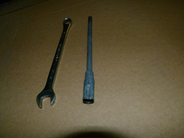

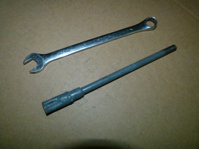

    I took a different approach-quick & dirty. I can even loan it out without fear of not getting it back.
    Stuff on the bench, 2 pieces of tubing 1 piece of 1/2" rod, weld together.
    About ten minutes of fartin' around. If I ever did another Caddy, I wouldn't be able to find it anyway.

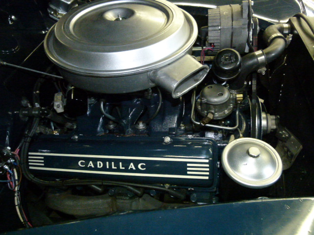

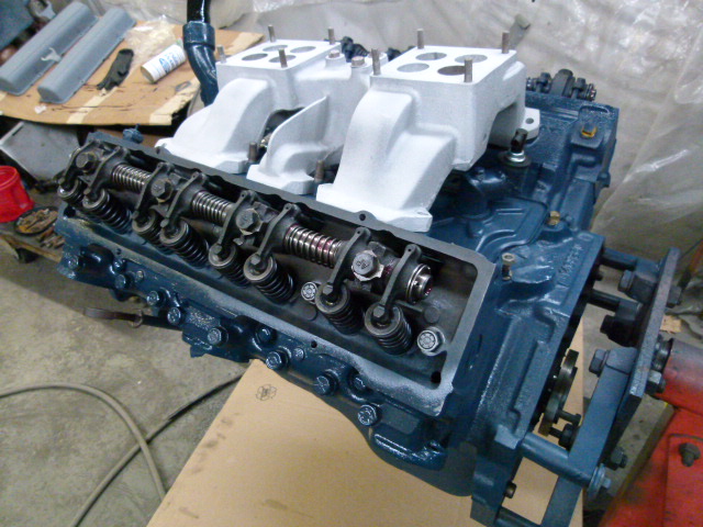

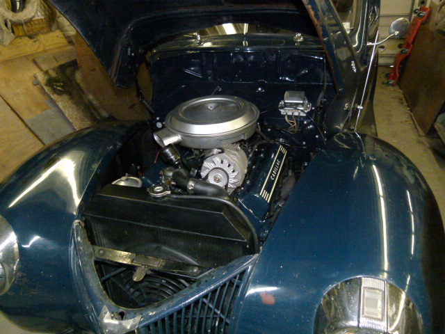

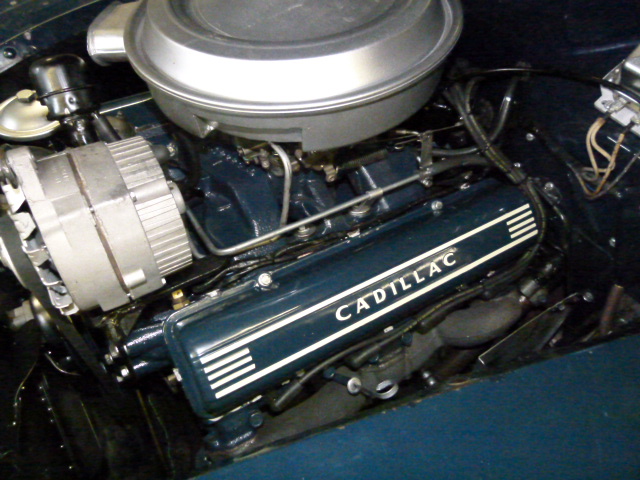

    Freshened a 390 to replace the 365 in my '40.
    Installed & running, 262 Isky, Holley 600 & painted valve covers so the kids know what they are looking at.
    Saginaw 3 speed with OD & an 8" Ford rear. This is a ROAD CAR, no multi carbs, no wild cams.
    It works.
    I agree, the tin covers are tough to seal, but it can be done.
