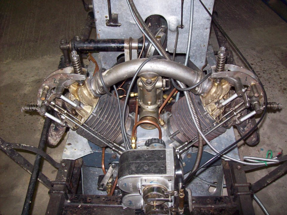

    Good weekend on the jappic got the staggered seat done and the metal work is done and bolted to the wood parts,
    The lack of engine is now holding me up, the 600 sv engine is really much wider than the 350 engine and I will struggle to get the pedals in ,
    Despite the fact it only has two pedals clutch and brake as the throttle is a hand throttle on the steering wheel
    Don't know why the seat was staggered as it's impossible to get a p***enger in and drive the car he would get eaten by the drive chain but, its supposed to be a faithful recreation so that's how it has to be

    ..............jappic update ......
    This week the rear axle arrived , it's actualy an old school kart axle , need to extend one of the key ways to mount the drive sprocket then machine taper and keyway on the ends to mount the hubs ,
    The grease pump that lubricates the valve gear that mounts on the dash arrived good eBay buy ,
    Another eBay buy was a quan***y of nice dome head 1/4 unf aircraft bolts they look very vintage
    Hopefully I should have the road springs this weekend they are from a early cyclecar of some sort and have nice tapering leaves with radiused ends they are half elliptic springs so will need chopping in half to make the quarter elliptic springs I require
    Busy weekend
