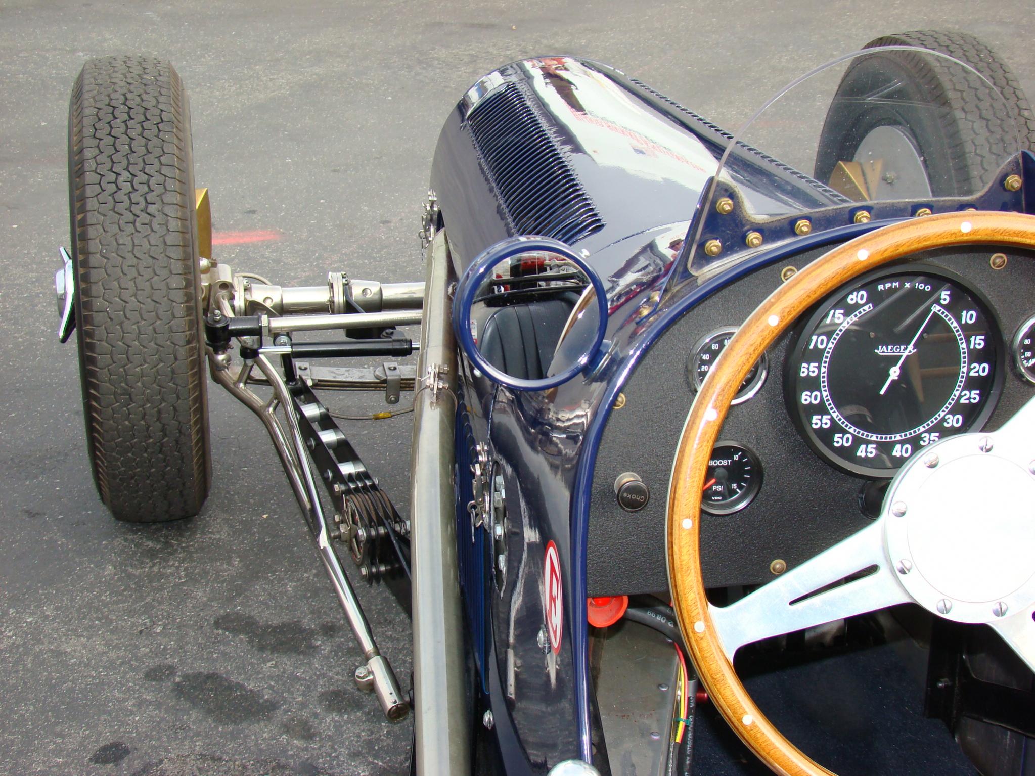

    That's beautifully engineered: great to see something as small/good as that being done in Leviathan Land.
    I wonder how much of the 8k tacho gets used?
    And ... is there any anti-tramp on the front axle, or is it all up to the springs?

    There are friction shocks

    Fair enough, but they'd mainly/only deal with the upsy-downsy motion of the axle, rather than the twist generated by heavy braking, non ?

    The axle seems to be located by those strangely-twisted hairpin-like arms, which makes me wonder if that is a rotary articulation on the left side of the axle. I see no lateral locator, however?

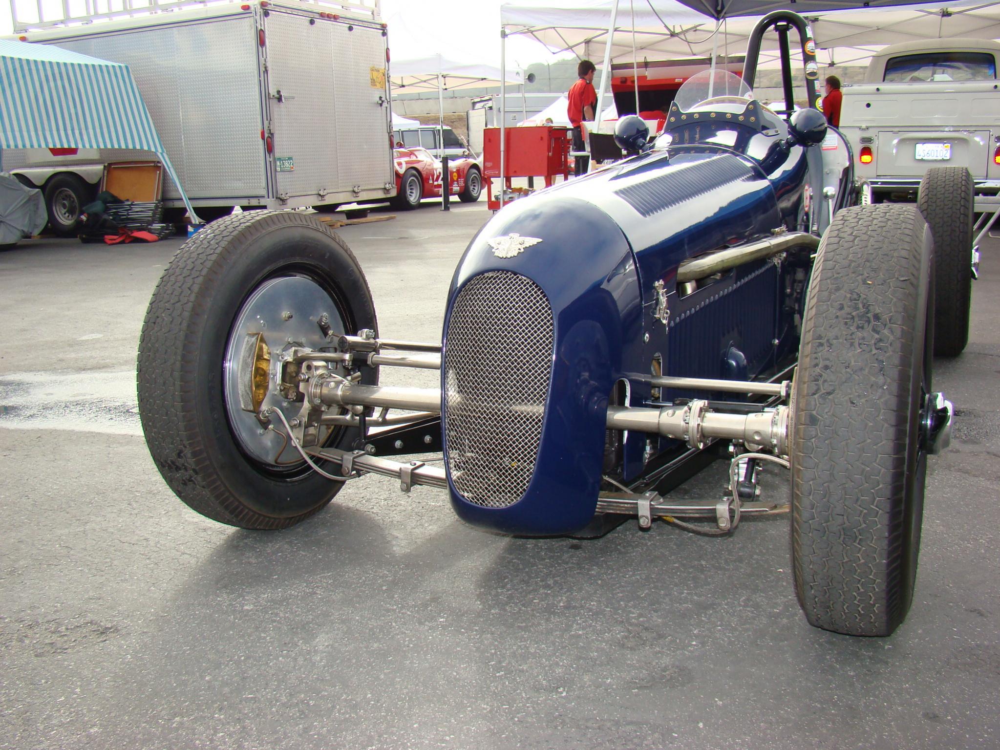

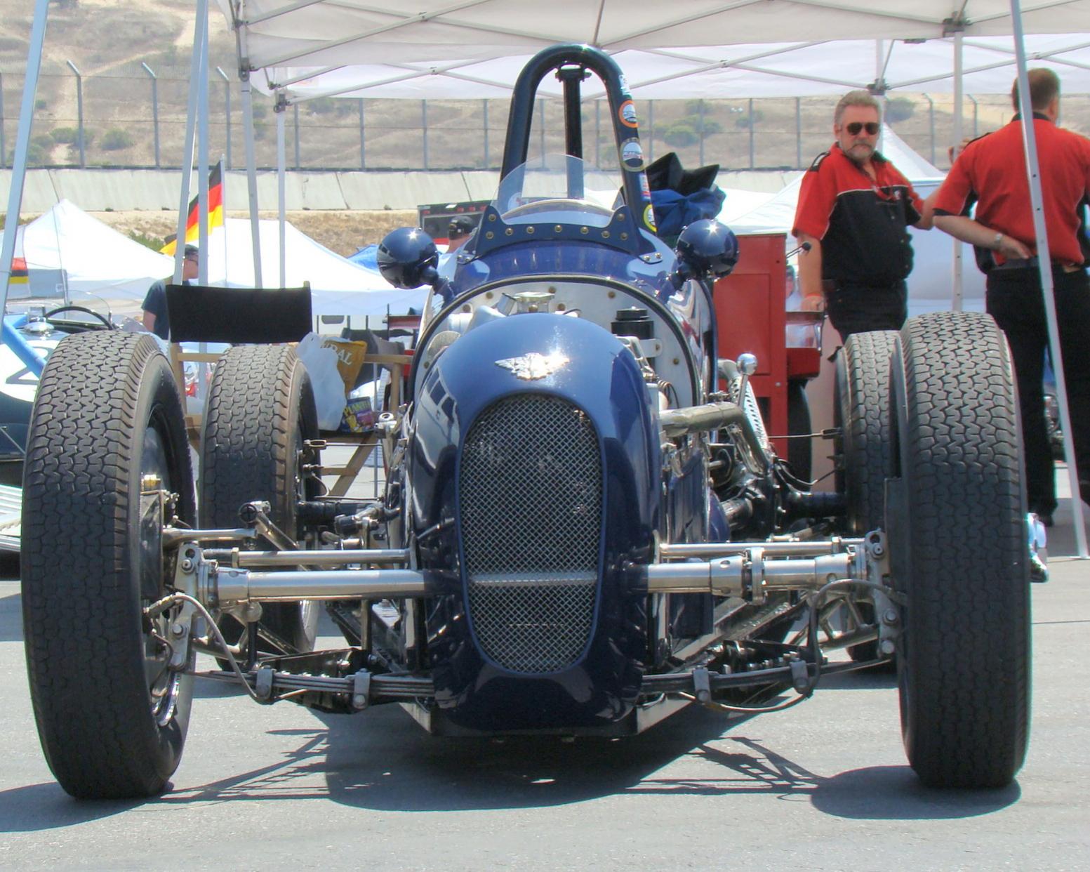

    Can someone explain why that front axle is a two piece affair? Bob [​IMG]

    If the axle is located by hairpins the ends of the axle would have to rotate slightly relative to one another about a lateral axis. I'm not sure if a rotary joint is what we're looking at, though. One of the other photos shows what looks like a bent plate bracket attached to the joint: is this part of a lateral-locating device? The joint looks quite similar to the ends of the axle: could this just be a clamp to hold a Panhard bracket or suchlike?
    This is giving me ideas, not for geometry but for method of construction. And I like the nickel-plate(?) finish.

    It looks like the mounting bracket for the steering damper, I don't think there is any rotating thingy to prevent the twisting motion because otherwise it would happen strange thing to the steering link and the wheels no?

    Those brake lines look kind of scarey too.

    I think the difference in length in relation to the track rod would be negligible over the sorts of angles involved. It does rather make sense if that is what holds the fixed end of the steering damper, however. Those seem to be some sort of standard non-automotive fitting. They seem familiar but I can't place them.

    I think the steering damper is a cheap motorcycle type
    I used to run the ohlins suspension race service for British super bike
    And wouldn't let one of those damper out on a race bike, ok on the street?
    Most Austin 7 race cars run the friction dampers transverse in the same axis as the spring
    Giving some effect like a panard rod my own Austin used the STD friction damper
    With the drop link removed at one end to give side to side location not ideal but better than nothing

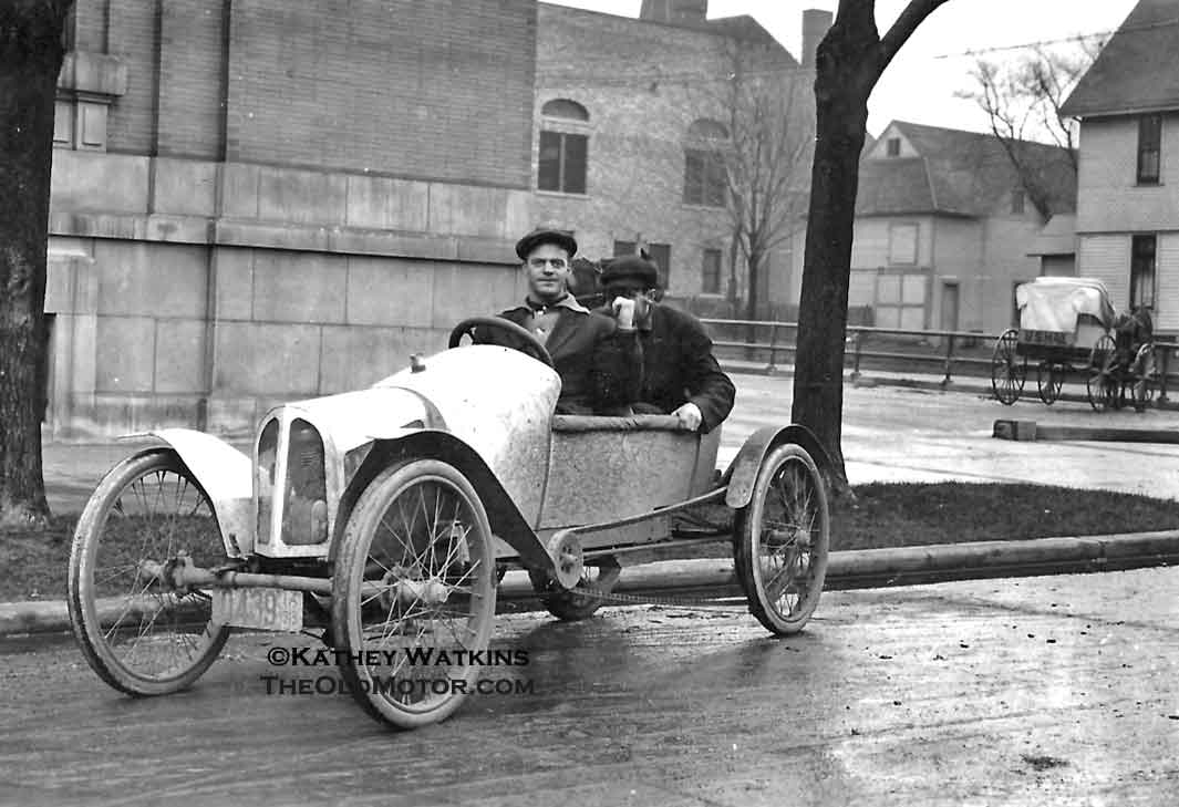

    One of two neat photos of cycle cars we have in a post filled with photos on early race driver Chester Cheney on theoldmotor.com In it you can read more and see another photo about the “Cyclecar made by yours truly and Charles Hathorn & Chet Cheney….Sixty miles per hour on dirt roads”. (Note on the back of the photo)

    Think I overlooked the fact that the radius rods (correct terminology?) are fixed top and bottom so that takes care of the brake reaction, I'd say.
    As for the "two piece" axle, dunno, but it makes me think of the M-Benz (GP cars from the 30's) de Dion tubes, which were articulated, I believe.

    Yes, the radius rods locate the axle in place and prevent wind-up when braking.
