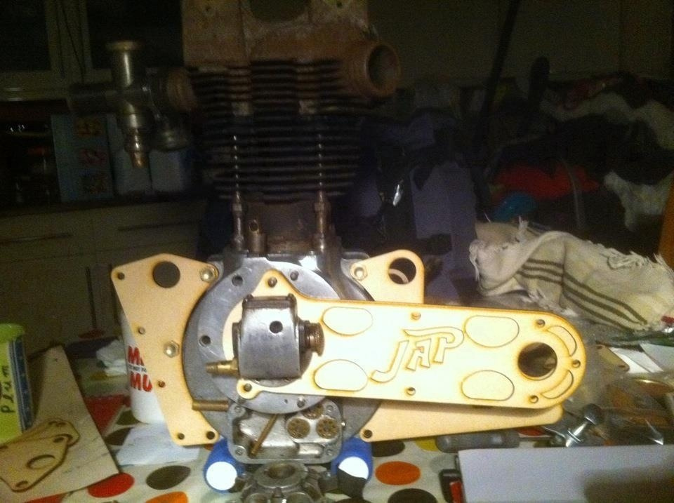

    Been making mock ups of the engine mounts and in the absence of the correct forward mount mag mount and chain case I will be making my own

    As I've just had to go through having brake bits (shoes & drums) cast for the Sizaire I'm inerested to hear of your process Ade: we took the traditional method of wooden patterns and casting. Same for you?
    I hear about "3-D printing" but have yet to be convinced it's anywhere near becoming the "normal" way to reproduce parts.

    I'm noticing that people who are into it tend to fetishize 3-D printing. I'd suggest that a sensible way to use 3-D printing would be finding fits into established techniques, e.g. printing casting patterns rather than actual parts.
    That seems to be exactly what Dzuari is doing here.

    My bits a very simple , I draw the parts up in then use a laser cutter to cut the parts out of 3 mm mdf particle board , this is just for testing if everything is good the drawing is then sent to the local water jet cutting company and then made in 3 mm steel ,
    3d printing can be used to make patterns for investment, lost wax type casting , it can also manufactor metal parts in a sintering type process , I see a m***ive future for this process , you can buy a basic machine for under £1000 but the skill is in the drawing
    http://www.3dprint-uk.co.uk/ or you can use a third party to do the work for you
