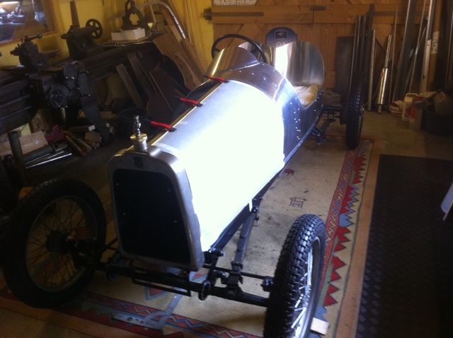

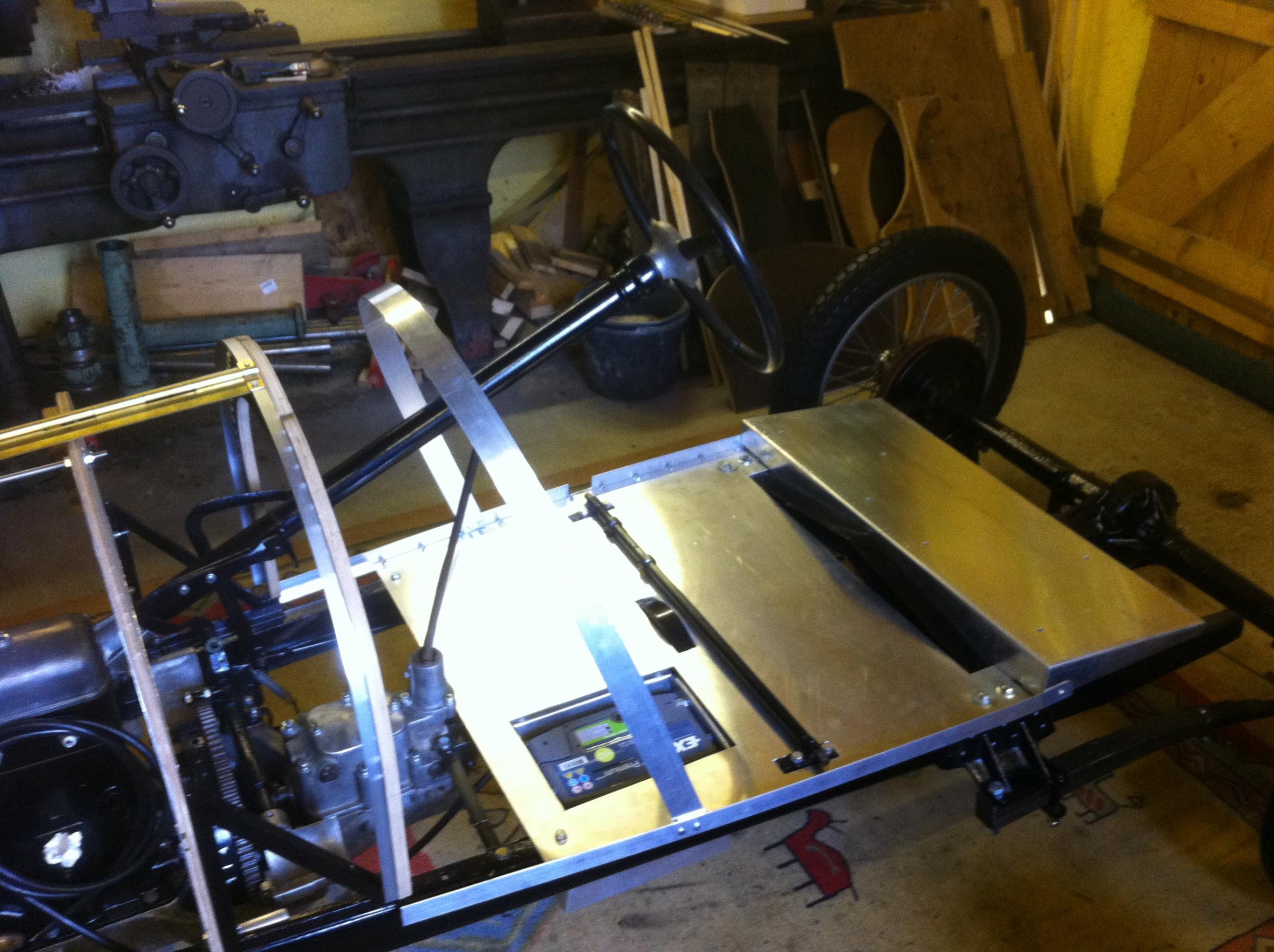

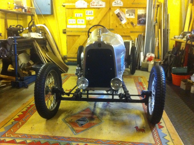

  7. Talgil
    Joined: Jan 28, 2013
    Posts: 51
    Talgil
    from Luxembourg
    As requested here are some pictures of todays state. I am currently designing and producing a handbrake. Still do do is the dashboard, fuel supply, dynamo, accelerator pedal and linkages, piping from blower to cylinderhead, wiring and upholstery. But all that will not change a lot on the overall appearance of the little car.

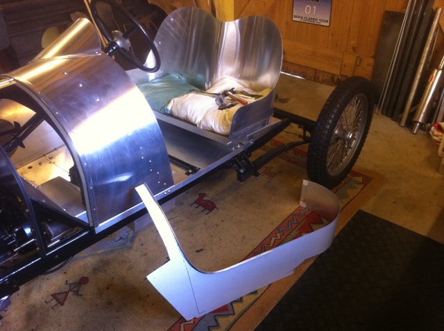

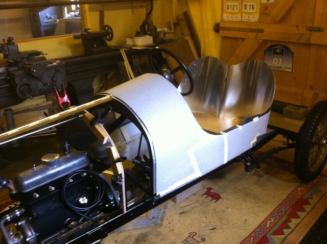

  18. Talgil
    Posts: 51
    Talgil
    from Luxembourg
    Thanks for all your warm welcomes. :):):)
    Saves the rainy week we have here. Wonder if you really all live in those exotic destinations you entered when registering. (I was therefore tempted to enter 'The moon')
    Here some pictures I took during the build.
    (I like the at***ude of 37kid that the project is all, and that he doesn't even think of finishing it. However I have to get mine finished, as there are already two other projects waiting before I get to old to tackle them)

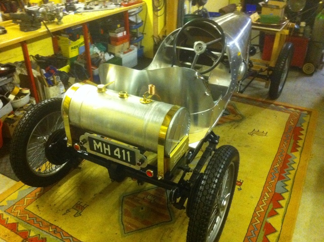

    Hey Talgil, how wide is your seat? I'm trying to decide whether I have room enough to fit a small p***enger. Your project is a beauty by the way.

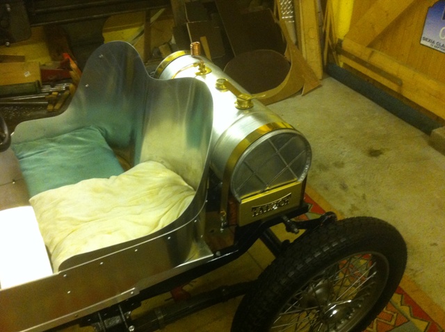

  21. Talgil
    Posts: 51
    Talgil
    from Luxembourg
    Hi bobadame, the seat is 80 cm. As the p***enger seats further back (sièges décalés in French) only his legs need space near you. The p***enger has to put his right arm around your seat and I have therefore fitted a grab handle he can hold to feel more secure in corners. As he (or hopefully 'she') will have my left shoulder hard on his/her right breast I suppose the love will have to be strong enough to travel with me!
    The picture shows the grab handle. I still have to build a small box for spares to fit between drivers seat and the fuel tank. The number plate is not the one the car will get either, and I will probably rework the rear a bit as I am not 100% satisfied with the looks of it. (might fit a spare tyre, or two? and fit the number plate further back and the lights further towards the rear wheels. As 64 wildcat says, projects always evolve!)

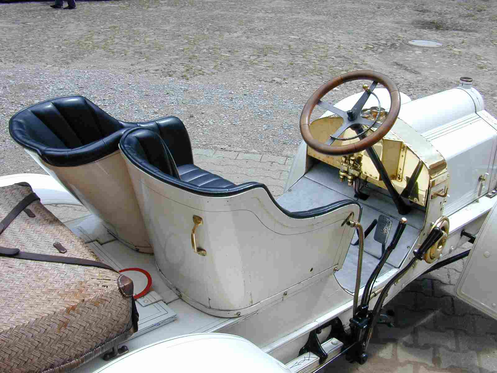

    "sièges décalés" .. here's a 1908 Sizaire - not exactly "staggered" seating, but with a grab handle for the p***enger whose seat back is in a somewhat reclined position. Some light aircraft employed staggered seating too, in order to keep the frontal area of the ****pit down...
  26. Airhead Roadster
    Joined: Sep 26, 2012
    Posts: 106
    Airhead Roadster

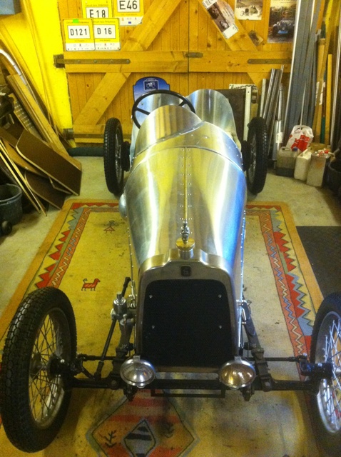

    Great pics & project Talgil. I am especially studying the ones of the body forming. Did you do your own shaping? I've never done any body panel shaping and I'm both excited and scared at the thought of tackling this part of my build.
    Any tips or tricks you'd care to share?
    What tools were needed?
    Thinking I might take a cl*** or two to get the basics down when the time comes.

  28. Talgil
    Posts: 51
    Talgil
    from Luxembourg
    Glad to see my project seems to appeal. I have done everything myself to the car so far, except turning the double pulleys for the supercharger drive. You can see my old lathe in the background of several pictures. I use it for easier jobs! I do not think building the body to be very difficult. The pictures explain the way I tackled it. I didn't learn any trade except from evening courses in mechanics about 25 years ago. My job consists mainly of writing French and German letters and meeting reports. So, if you are ethusiastic enough and have some imagination and determination you can do it! All panels are aluminum. First make a flexible cardboard template. Cut the aluminum with a jigsaw, bend on a table using a 2" tube as a help (or sometimes immediately in place), file to shape and fit with clamps, then 5mm screws and nuts. Remove these afterwards one by one when riveting. There is no weld in the body anywhere except for the fuel tank (I prepared the panels and had them welded, not being equiped to weld aluminum).
    Hammering the bowl to fit an accelerator pedal behind was a bit tricky. This is my first attempt using a leather bag filled with sand and a wooden mallet. It is not perfect, but I can live with it.
    Sorry, I do not have a build album, and not an internet site either. (Prefer to be in my workshop in my spare time)
