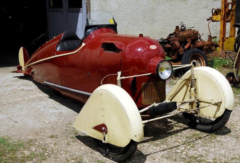

  4. Wow. They were trying for aerodynamics on this one. It looks like the trunk unlatches.
    What is the purpose of these fenders? It looks like they'll keep mud and rocks from flinging straight up, but not behind.

    The trunk could be the way to acsess the inside as there is no door this side, suspect the mudguards are there to make the car road legal , maybe it was after a road legal record of some kind

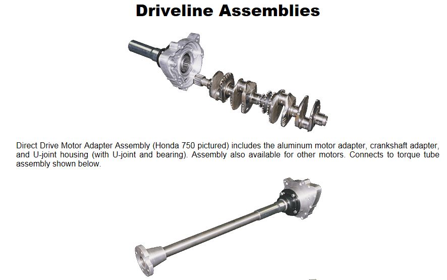

    TQ midgets use inline MC engines with the gearbox milled off and the crank adapted to a direct drive driveline. I rekon someone with plenty of machine tools, time and money could figure out a way to include a flywheel/clutch/starter/bellhousing etc.

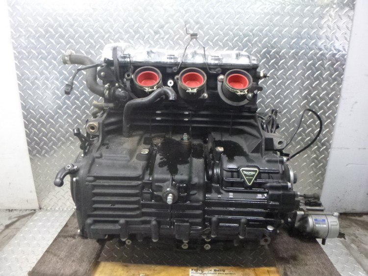

    Unless you have your heart set on a V-Max, you would probably be money ahead using a modern Triumph Rocket 3 motor (2300 c.c./140 c.i.). While the drive line turns counterclockwise, that shouldn't be much of a problem to solve for someone who wants to adapt a car ****** to a V Max. They ain't cheap but you could make your money back pulling stumps on the weekends. ;):D

    Rootie, is the crank in your photo a custom billet piece?

    Don't believe so, here's the oufit that makes the parts:
    http://www.acroracing.com/index.html
