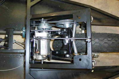

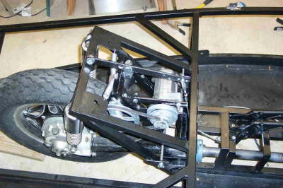

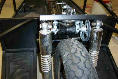

    Mike here's pics of power reverse fabbing on a 3 whlr. The back wheel looks like from a Gold or Silverwing.

    That's the type of 'reverser' Fuller has been talking about. Thanks for the pics. The roller couldn't be much better for contact area with the rear tire. Looks like it might be a piece from an industrial conveyor belt, or maybe a keel roller for a boat trailer. Neat.
    The Goldwing rear drive and suspension seems perfect for a three-wheeler project, particularly so when it has the air-adjustable option. My donor Goldwing is a two-shock model, and I think it's going to be just fine. I did go 'shopping' for a compound-arm single 'suspender' rear end because of how easy it would be to increase tire cross-section (and contact patch) for added traction.
    The one shown was new and complete and went for about $450 on eBay -- a bargain for what amounts to more than $2K if purchased a piece at a time, although I didn't buy it. I'm thinking we can do some t******* and reinforcing on the insides of a two-shock arm to get some extra tire clearance for a couple of bucks worth of material, cover gas and wire if we need it . . . but that mono-shock piece is sure neat.:D
