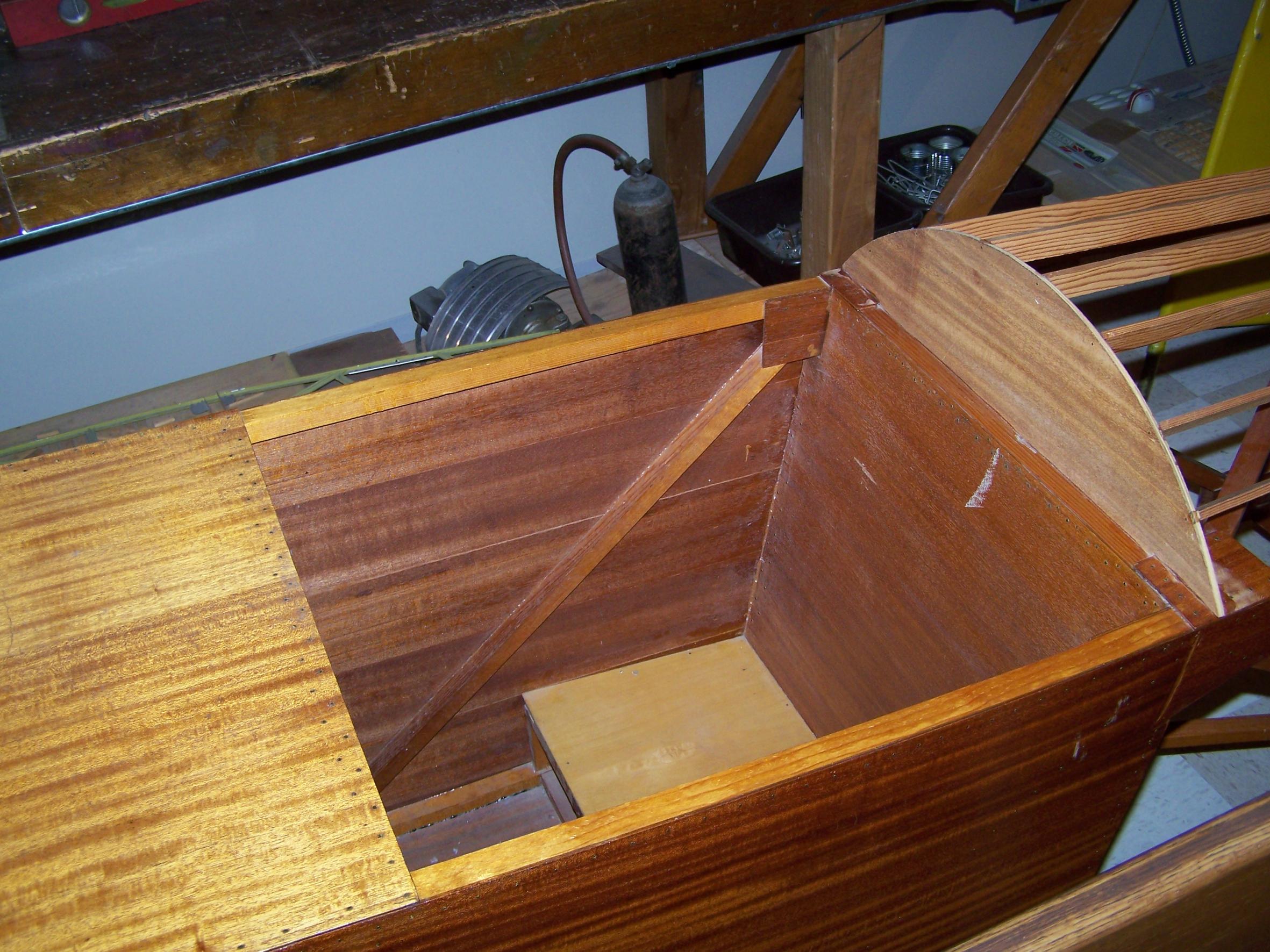

    Hey jade great car didn't know the car had history, until I was talking about it the other day to a fellow vscc member ,
    I would be interested to chat to you about your dealings with the esc as I will have to submit the jappic recreation in the near future
    I have just put a video of the current jappic recreation progress on my Facebook page ,
    Search for jappic recreation , or maybe someone could put it on here

    Your Jappic replica is starting to seriously look like a cyclecar Ade.
    Progress so far is a great testament to your skills and workmanship.

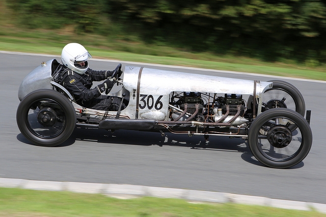

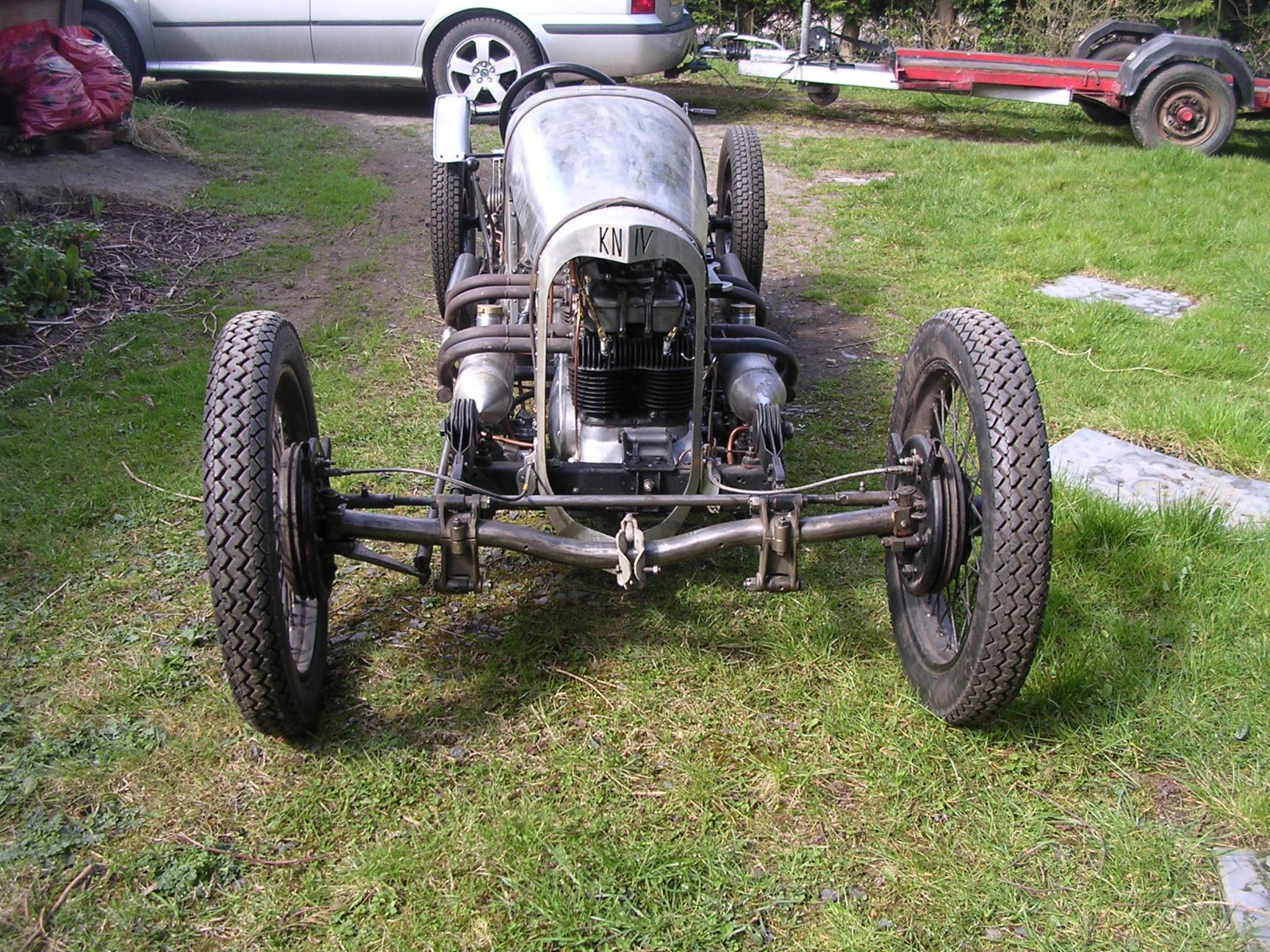

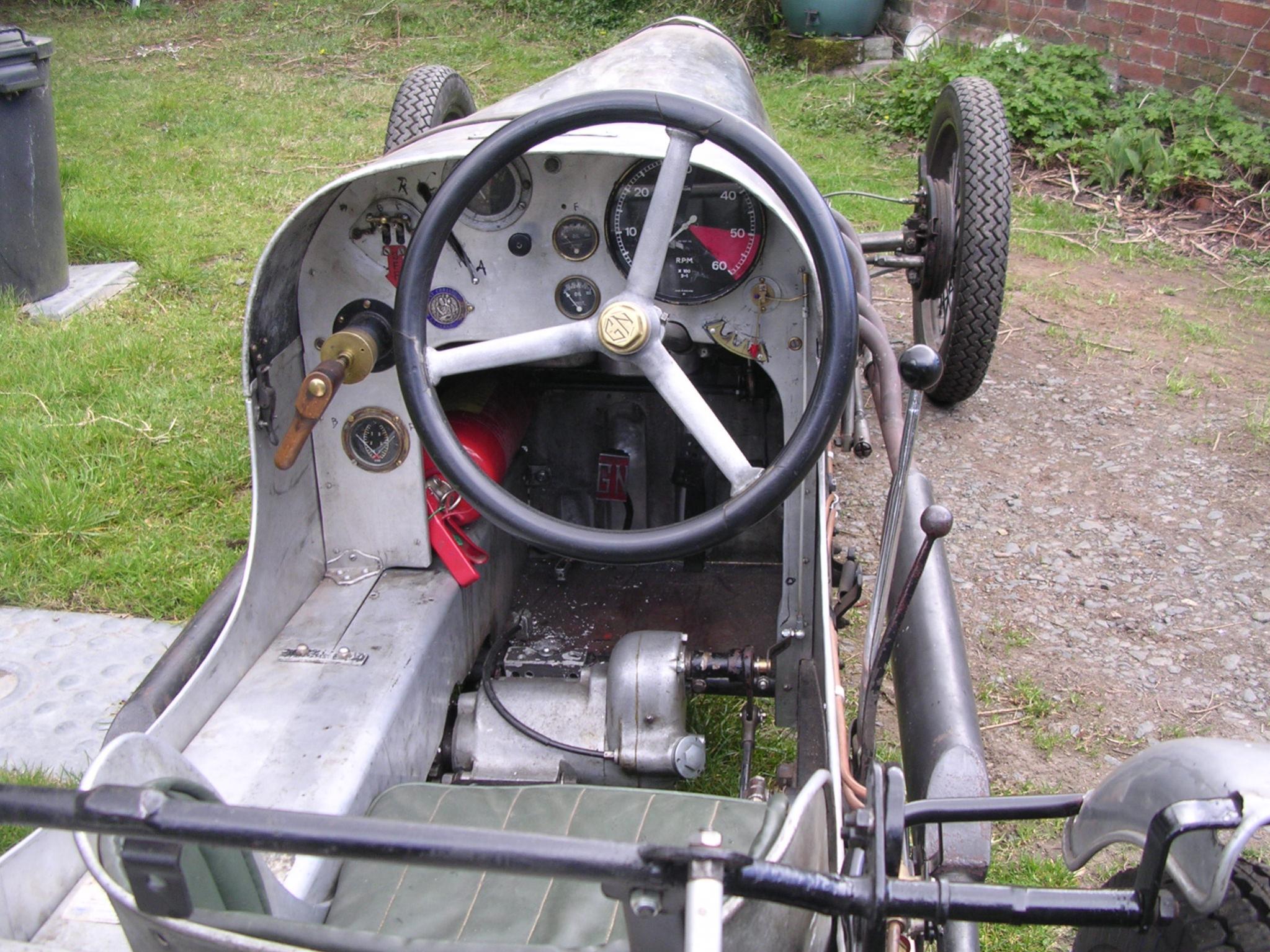

    [FONT=Arial, sans-serif]Thankyou, It's good to feel welcome.[/FONT]
    [FONT=Arial, sans-serif]The Gnariel was the 4th compe***ion special built by Kenneth Neve hence it's ***le KN IV, his first three were made pre-war and used Douglas and Ariel engines. He had a habit of adding another engine if he wanted more power, as he was at school with John Bolster who built ****** Mary and with his brother the 4 Rudge engined special perhaps you could blame the school![/FONT]
    [FONT=Arial, sans-serif]He campaigned KN IV through the 50's then sold it and the car p***ed through many hands without much success, it got re-bodied and there were many changes made to it before it briefly reappeared on the VSCC scene in the 1990s. I had been after it for a long time and finally caught it 5 years ago, I have rebuilt it retaining as much as possible of Neve's original and abandoning or altering back much of the subsequent changes.[/FONT]
    [FONT=Arial, sans-serif]The ch***is is from a 1921 or 1922 GN cyclecar, Neve writes in his book 'A Bit Behind The Times' that he thought this a retrograde step as he had used wood for his earlier ch***is which were lighter, he installed the 2 Squariel engines connecting them by a chain, the primary drive being another chain to a much abused Burman gearbox with a hand operated lever outside the ****pit, the next chain is to a layshaft at the rear suspension pivot point and a final chain to the solid GN axle, that's right no differential folks so a lively rear end! Each engine has it's own oil tank and fuel is supplied from a tank in the tail which is pressurised by a hand pump.[/FONT]
    [FONT=Arial, sans-serif]I don't want to write a book here or even a chapter of one so I'll leave it at that for now but I am happy to add more information later or answer any questions if there is more interest, the car has a reputation for being 'difficult' being a bit of a handful on track and unreliable, I have had my share of adventures with it but it has now completed it's first compe***ive season this century and probably its most successful for 50 years. [/FONT]
    [FONT=Arial, sans-serif]When I first acquired the car there were several people who suggested that I was as mentally deranged as the car was mechanically, they may well have been right which is why I suspect that I will fit in very well here![/FONT]
    [FONT=Arial, sans-serif]Adrian, I'll PM you separately.
    Ah! I am having a little difficulty with posting pictures, I am not very computer literate, they are not oily and mechanical enough for me, here are 3 for now, I'll try more later.

    Now how cool is that, a cyclecar with two Ariel motors. Very neat Jade. Thanks for sharing, would love to hear/see more.

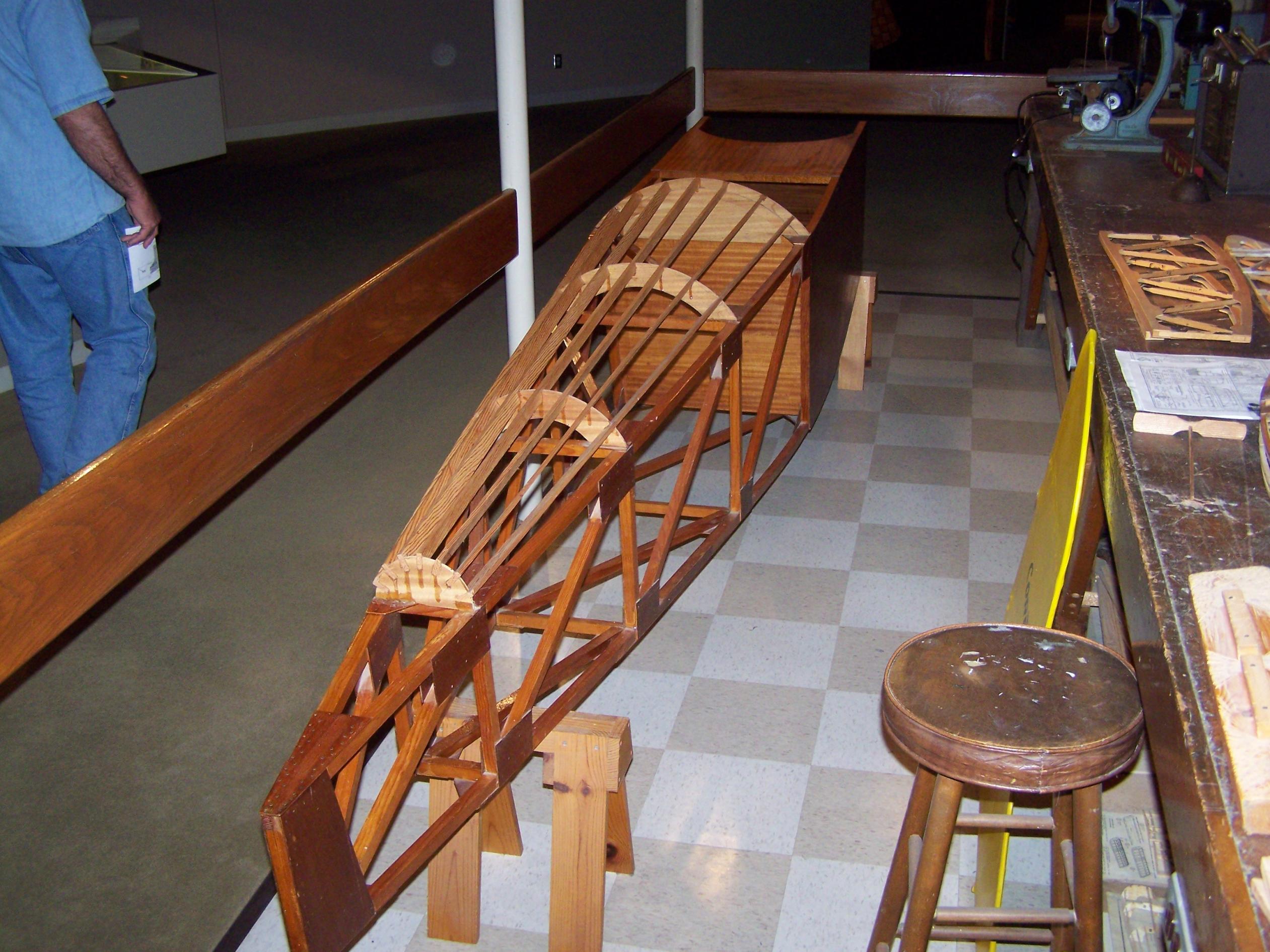

    here is a fuselage from a display at the Experimental Aircraft ***ociation museum in Oshkosh ,Wisconsin.It could easily have been used in a cyclecar.

    That aircraft fuselage is definitely food for thought and as you say it could very easily be mistaken for a cyclecar body frame.

    this is the book i worked from to build the chater lea and now the Jappic,,
    interesting how different aircraft construction is to traditional wood work in that the strength comes from glue rather than mechanical joints such as mortice and tenon also screws and nails are used but just to hold and clamp while glueing joints and often the fixing is removed after the glue is set
    http://www.amazon.com/The-Techniques-Aircraft-Building-Eaa/dp/094000044X

    As far as removing fasteners after gluing wooden members,this also a common practice in the building of certain watercraft.

    Having built many wooden aircraft structures and one complete single seat biplane of wood, I can attest to the fact that the small nails, (when used), have no purpose other than to hold the pieces together while the glue sets. Properly done the wooden parts will fail long before the glue joint.
