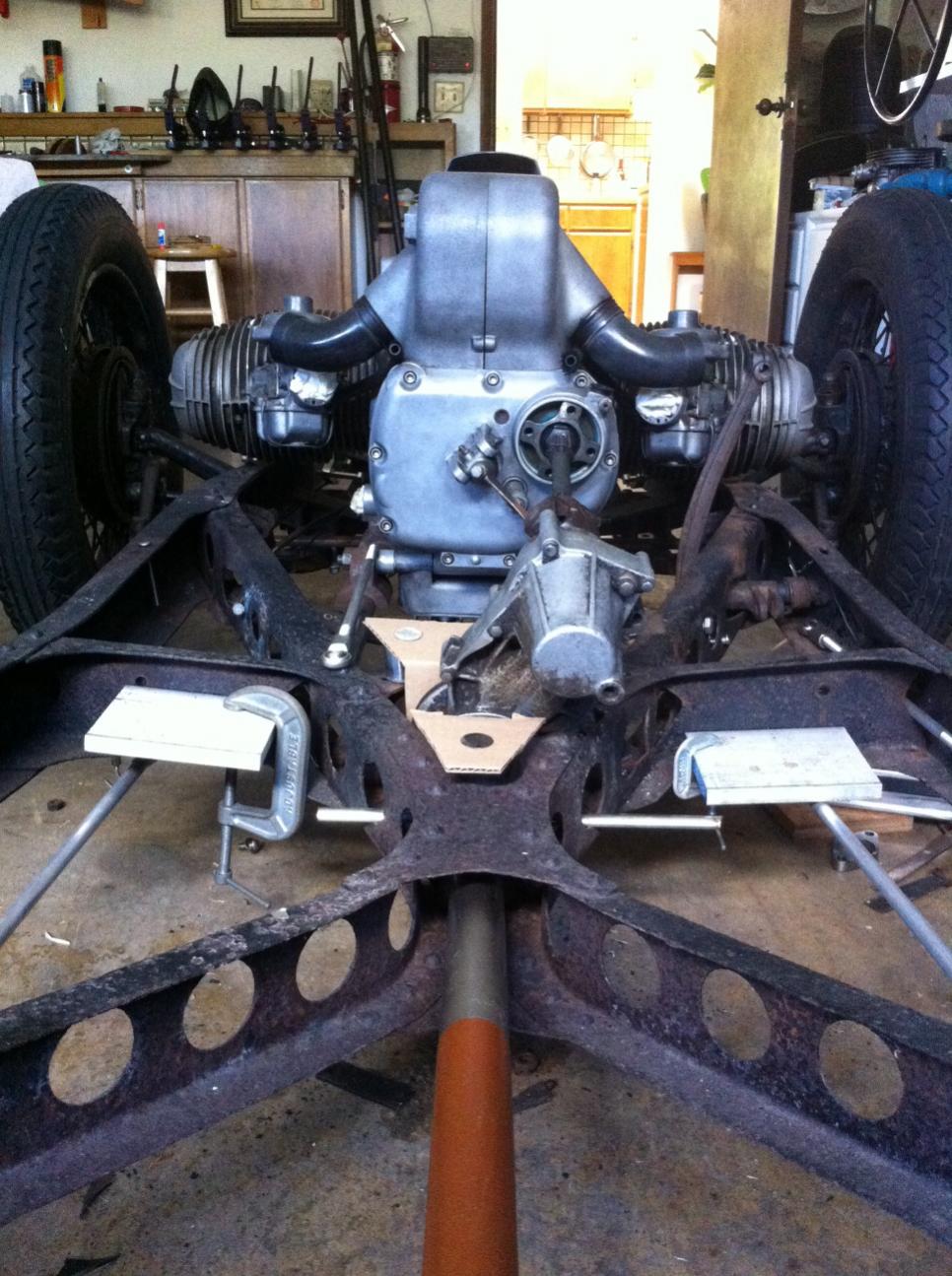

    Congrats on the ch***is Hardhatz!
    I settled on the middle gear from a Yamaha ATV. I still need to fab the mounting plates and isolators. It's been sitting in the garage mocked up since I got it and looks like it should do the trick nicely.
    Lots of stuff like that on Ebay, and often so inexpensively that it's worth taking a chance just to get your hands on it.
    Snowmobiles use some pretty neat chain driven boxes that I came across as well.

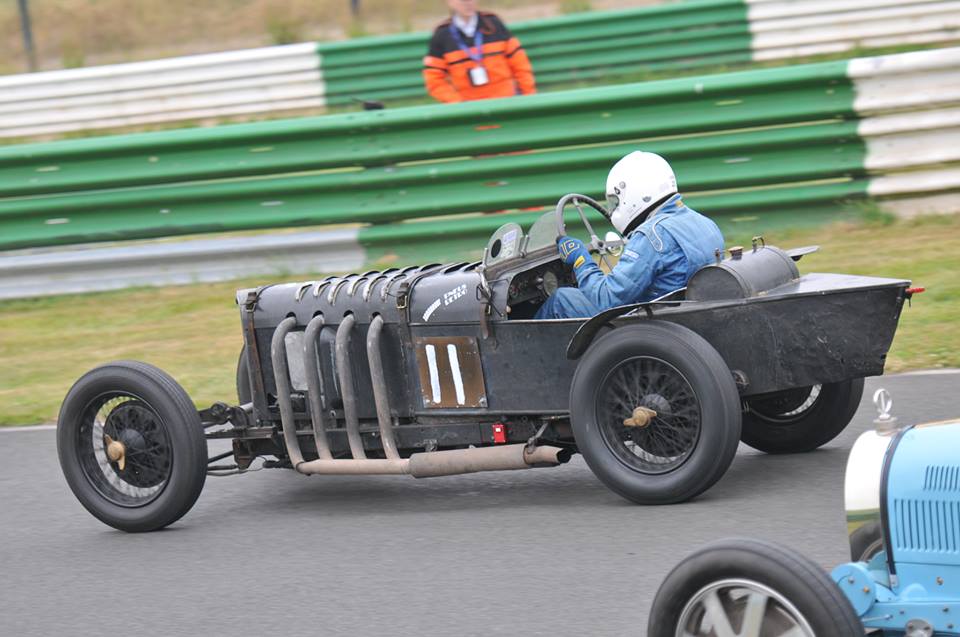

    Frazer - Nash Super Sports at the VSCC Castle Combe Autmn Cl***ic. www.vscc.co.uk

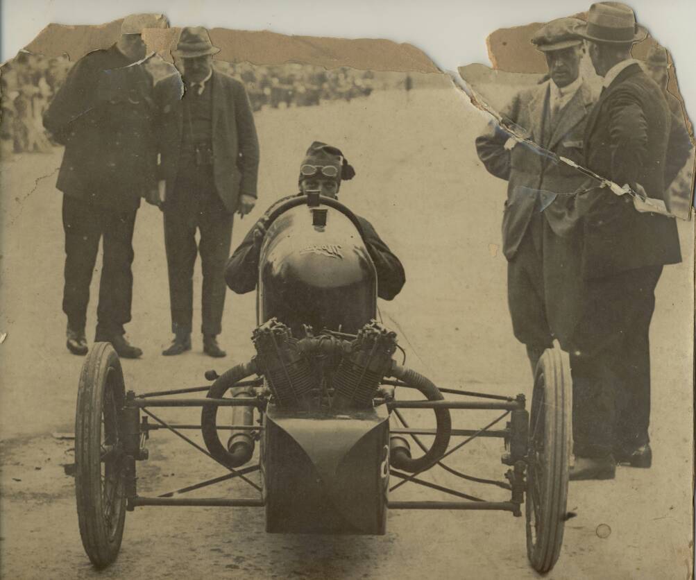

    Here's the story....The driver is Harry Martin.The engine is a Morgan Anzani designed by Hubert Hagens.
    85mm X 95mm
    4 valves per head
    twin spark plugs per head
    triple venturi Zenith carbie
    In June of 1922 it was good for 70.58 mph in a 5 lap handicap race at Brooklands.
