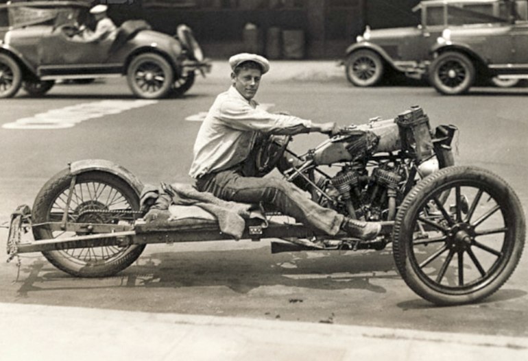

    OK, now this is my new background! That's an EARLY hotrodder right there. Thanks for posting it Cheese. :D
    It looks to be rigid front and buggy sprung rear. But what's that he's ********* strapped to the tank. Looks like a dead crow. :p
