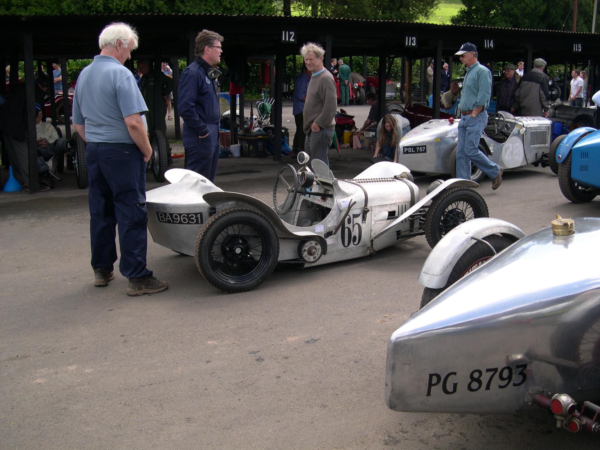

    Can anyone give me more info on this Austin7 special? I would really like more photos of it in order to build a cyclekart based on it.
    Thanks,

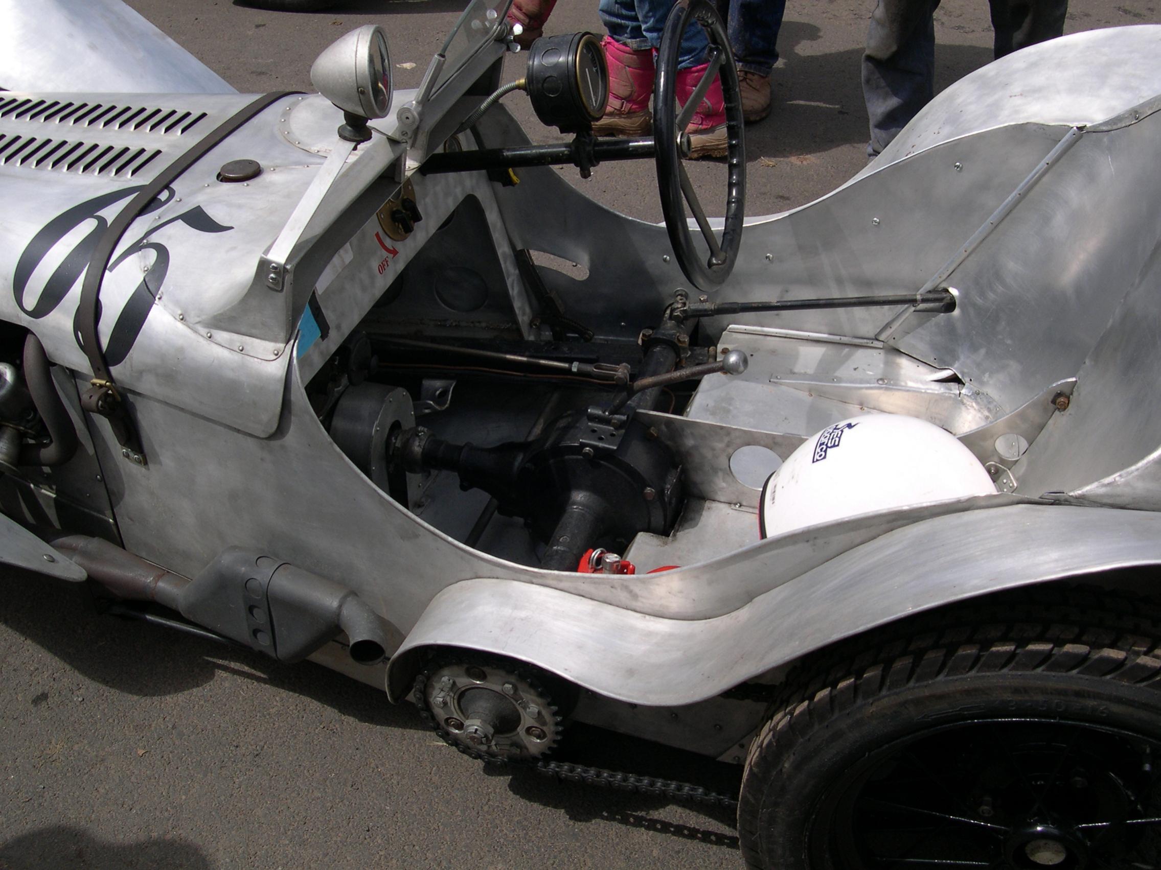

    Well, studying the pictures, its got a straight I-beam front axle with dropped kingpin ends. the axle itself is suspended from beneath (that's pretty kewl!) by a transverse buggy spring, and the frioction shocks are also mounted transversely just a bit above the axle.
    looks as thoguh the original austin rear live axle has been converted to run sprockets on the axle flanges, and then chain drive to the rear wheels on a straight beam axle. (the suspension method is not shown, but since A7 specials were limited to using the original A7 ch***is, I am ***uming that the rear suspension is the stock Austin 1/4 eliptic leafs.
    that help?
  13. fredvv44
    Joined: Dec 11, 2013
    Posts: 736
    fredvv44
    Right, it looks like he just turned the spring shackles around to put the axle above the frame mount. Still uses the stock friction shock. Center of gravity is really low. For a cyclekart it would be great; alum. body with no compound curves.

    That method of suspending an Austin Seven front axle is actually quite common on single-seat racing specials.
    Edit:
    Many axles are tubular, though, as may be seen.

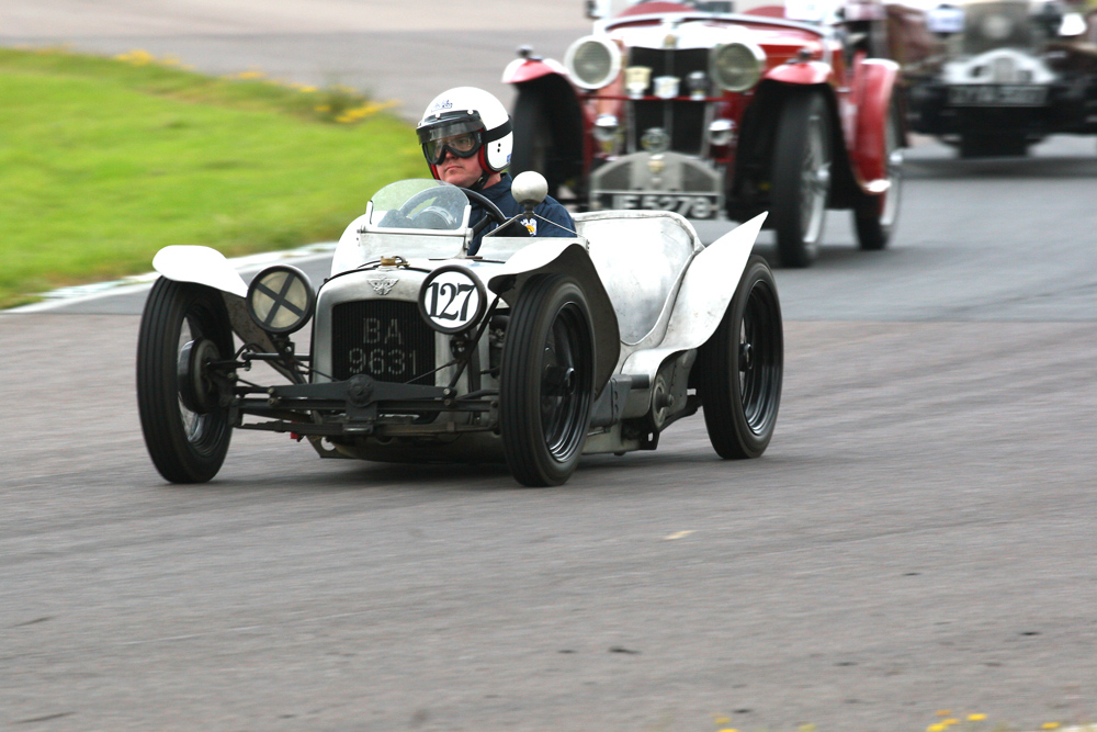

    Something I have often wondered about on construction, especially on racing vehicles is seen in the foreground of the first picture. It is the rear of another car, but the bracketry for holding the rear spring shackles seems to be a rod that p***es through the frame and out to provide a pivot point for the shackle. I've seen this on front suspensions in early Indy cars too. If it truly is a rod - is it made from steel something like 'drill rod' for strength? Anyone have knowledge about this set-up? Thanks - sorry, not trying to hi-jack thread, but saw the picture and it triggered the question - and the answer might be helpful for anyone else thinking of building their own car in the future. Jay

    If you are referring to this picture, it looks like a rear ch***is cross piece, probably of steel tube to act as the rear attach point for the spring. Just sort of a cross member that is wider than the ch***is.

    Basically a rear spreader bar for the frame horns that doubles as a outboard pivot allowing the shackels to pivot up, lowering the car and giving a wider spring base.

    the car in your attached pic is a front-drive Miller speedway car, either a 122 or 91, circa 1925-1929.

    Is the chain drive used to facilitate independent suspension under the rules requiring A7 ch***is/drivetrain? or is there some other reason?

    It's a good way to reduce unsprung weight.

    I love the mechanical tach on the steering column.

    I think also the ability to change the gearing would be good especially given the different hill climb courses we have in the uk
