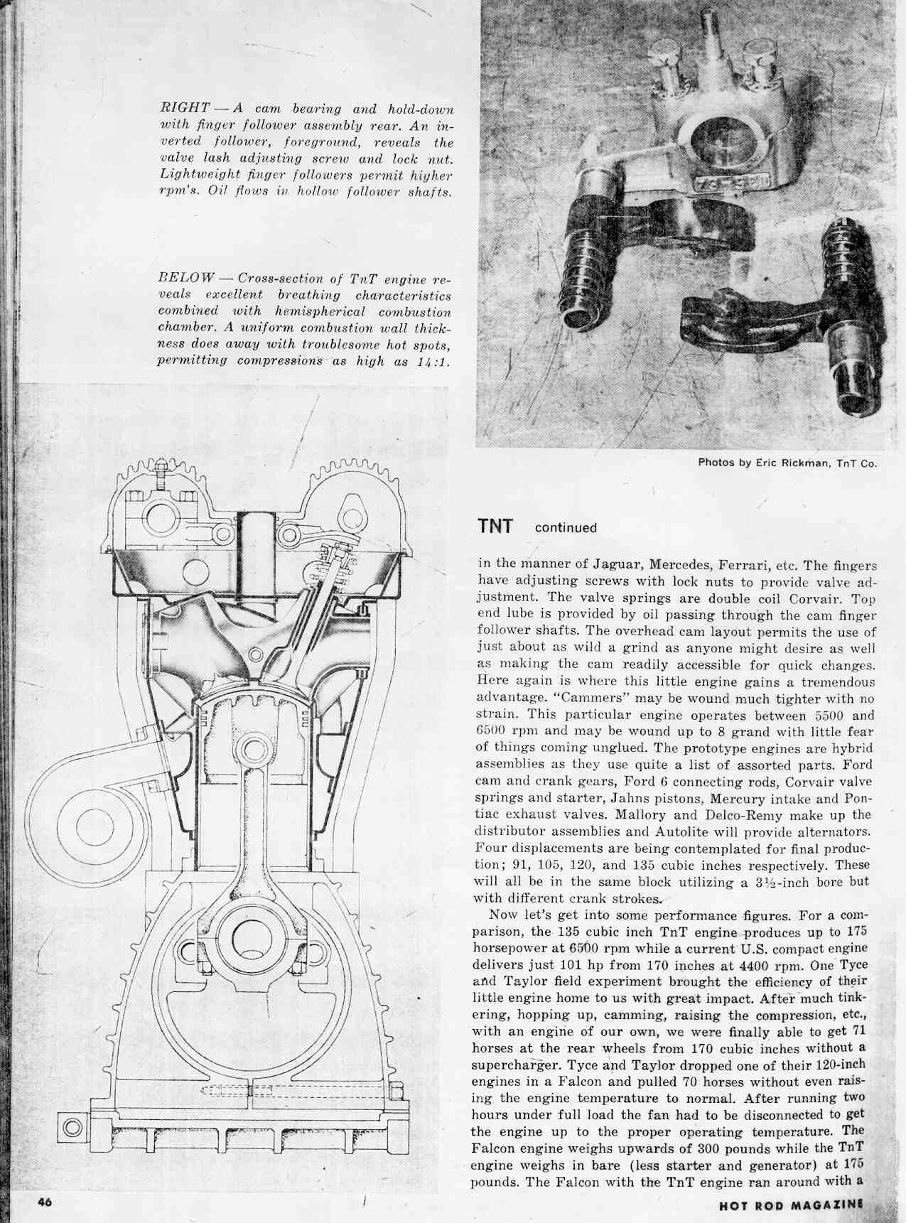

    I have some images of a Hot Rod article showing a DOHC engine he was making that way.

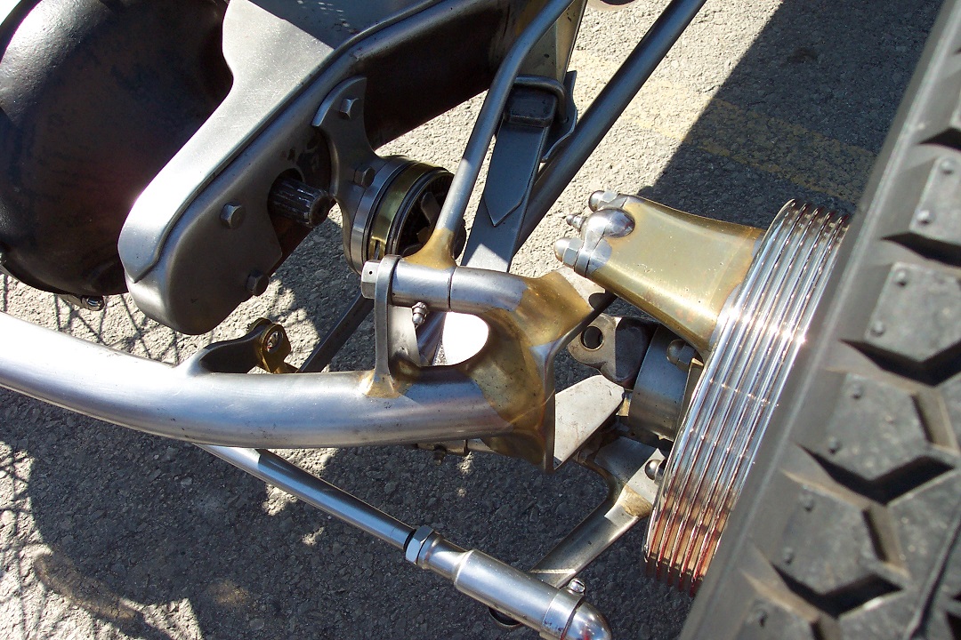

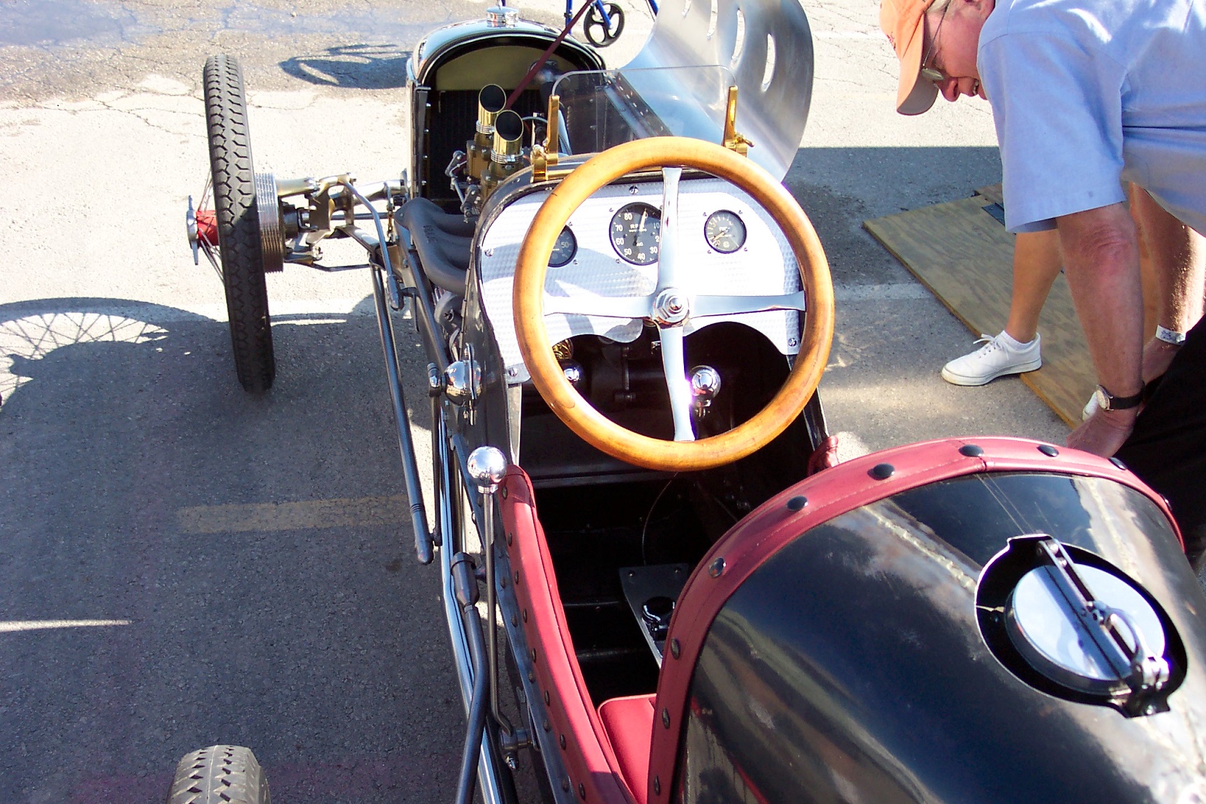

    Not sure if I've posted these already in this thread, but with the Crosley talk I'll put them here.
    Crosley powered, Miller front-drive inspired cycle car.

    That mini miller is a work of art , stunning fillet brazing on the front axle , it will be a shame if they paint the axle ,

    That Crosley Miller is GREAT.

    This car is at the time of the photo at least, a non runner. When it does get to be drivable, it should grind up tires with amazing regularity--and NOT just because it is front wheel drive. Shame for someone to put all that work into the front end, and not understand the Ackerman principal.

    Ignore the arm itself. What's important is the theoretical line from the tie rod pivot to the spindle pivot. Doesn't look too far off.
    A behind view may be better.
