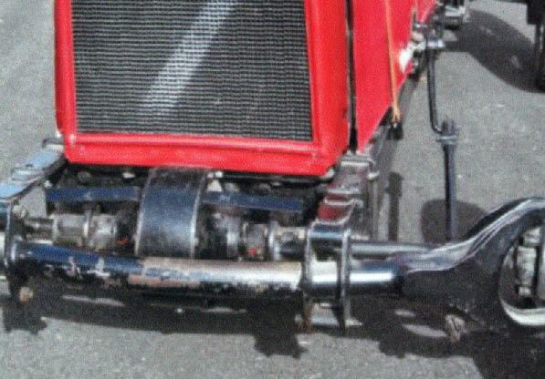

    Herb,

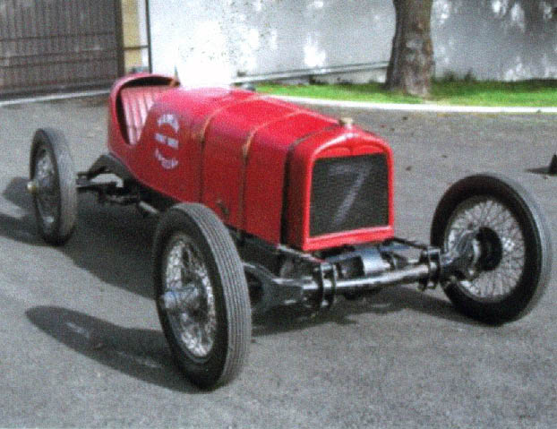

    Quite well noticed! I was blinded by magnificient design and realisation so didn't saw the obvious! Maybe, they could later improve steering system according to some of Ackerman principles?

    Looks right to me. Anyway many modern race cars are set up with anti Ackermann.

    My bad--didn't notice that the spindle point of rotation was so far inboard.
    Once again I need to remove my foot from my pie hole!
    But theoretically wouldn't it be better to have the ball joint points co-axial with the steering U joint? Looks like there would have to be a heavily loaded spline in the drive axle--
    Please understand that what has been done is beautiful and a ton of work has been put into the whole project IMHO, and I'm not trying to belittle the car in any way.

    The biggest problem I see is the scrub radius from the ball joints to the tire contact point. I'm not sure what you mean by "the steering U joint".

    Well, CV joint would probably be better from an explanation standpoint, but what I thought was something else is half of a common U joint, the cross and the other yoke being missing. So it would appear that if the joint was all there, the two pivot points probably would look to be in line.

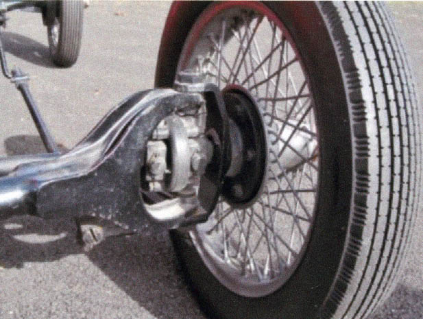

    I take it it's the outer U-joint on the drive shaft. I wonder what that is going to be. I'd be inclined to cheat and use a double-Cardan type out of a Land Rover or something. But I agree: there seems to be too little KPI, and consequently quite a large scrub radius. I'd expect to see something much like torque steer as a result, as well as squirreliness under braking.
    By the way, what are those things at the ends of the tie rod? I've seen them on early steering, especially drag links, but have never had an explanation of what they are all about.
    The outer CV can be off the steering axis. In fact, if for some reason it is outboard of the steering axis it would reduce the effective angle of the joint when steering, at the expense of a small angularity at the inner joint. As every effort is made to get the steering axis as far outboard as the parts will allow, it's more likely that the joint will be inboard of the steering axis, in which case the opposite would apply i.e. a slight increase in angularity at the outer joint plus a slight angularity in the opposite direction at the inner joint. I think this is all pretty conventional; I'd expect most cars to have CV joints slightly off the steering axis.
    In any case some sort of lengthwise movement would need to be accommodated in the drive shafts, be it splines or, as I understand is more common, "plunge" type CV joints, which have a small axial degree of freedom built in. This is due not to the position of the steering axis but to the geometry of the front suspension, in this case the DeDion axle, whose length between hubs remains constant.

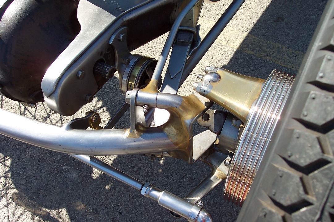

    I have a '77 GMC motorhome that uses the Toronado front wheel drive. The outer CV joint has no lateral motion it's done with the inner joint.
    This car looks to be using a conventional u-joint. You can see one end of it and it's in line with the ball joints.

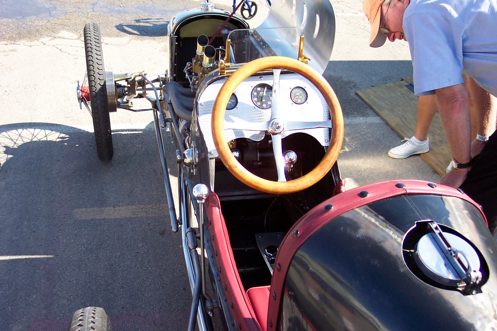

    I thought the Ackerman was probably off at first glance. But then I saw where the king pin line was and if you look the pivot on the arm and draw the line through the kindpin or spindle pivot it looks to be right on. Just the angle on the arm that made me do a double take. Very nice work.

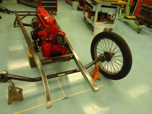

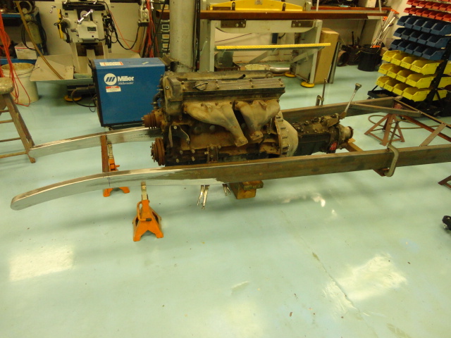

    Building some Amilcar type of Cyclecars using a Buick 8 and Jag 6s.

    I really like the idea and would love to do the same myself. The Amilcar, though, was a very light car with an alum. 4 banger. The Buick or Jag. engine would not suit this design with such skinny light weight tires. A 1 liter 4 cylinder would be much more appropriate. Those engines would be more like a Bentley than an Amilcar.

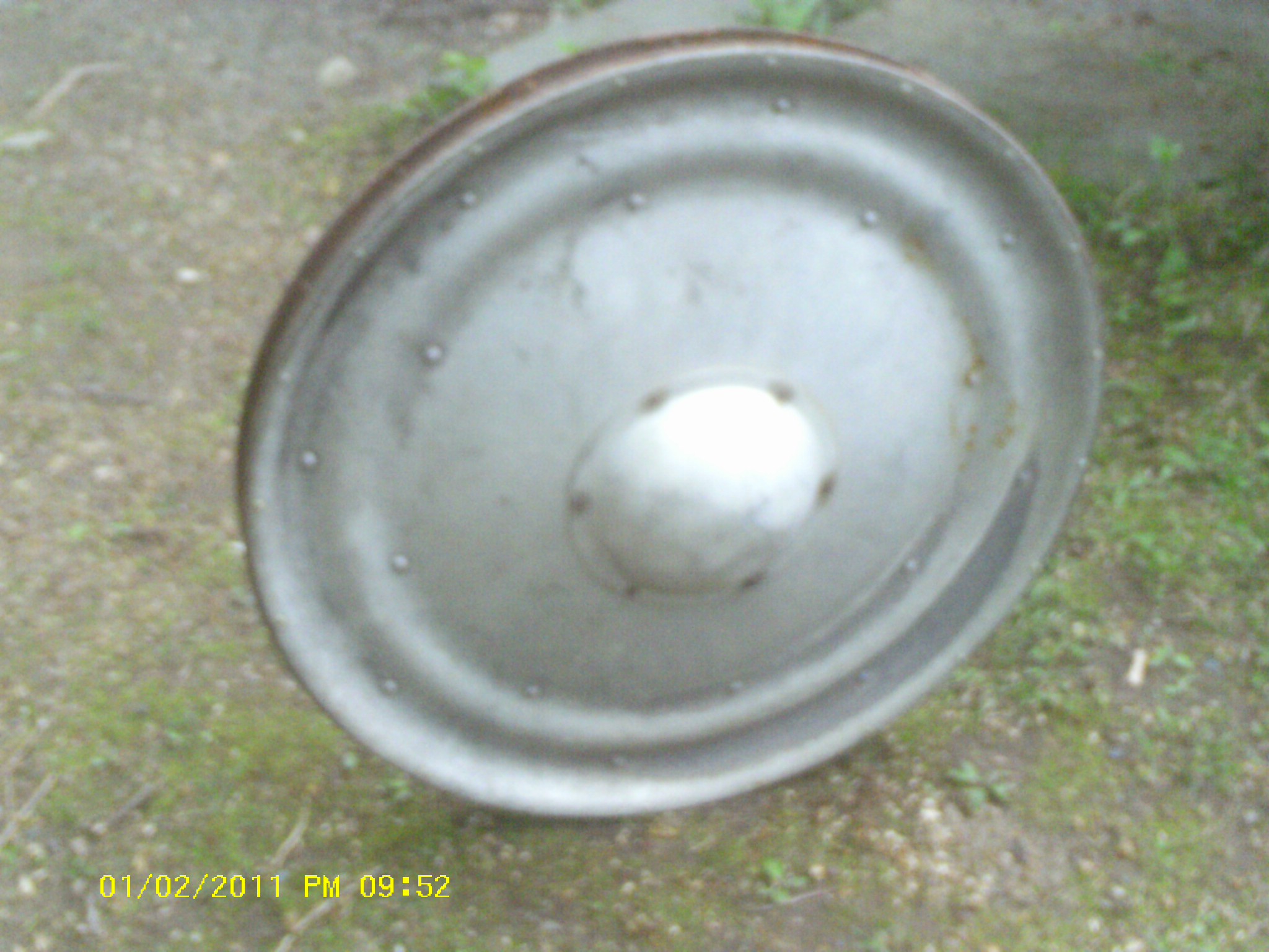

    Picked up this wheel I was told it was from an airplane, one more and you'd have the front wheels for a cyclecar. Bob

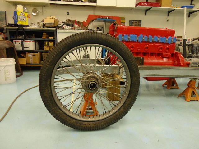

  20. Some of these used motorcycle wheels. Wondering what contemporary (Available on craigslist or in a salvage yard) wheels would be good. I have a few HD FLH wheels, just wondering about making axle stubs and what bearing to use.
