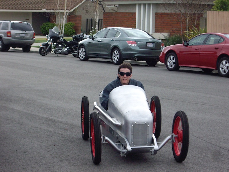

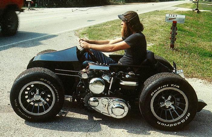

  2. I built this cyclecar in 2004. Uses a 6.5 hp Honda for power.

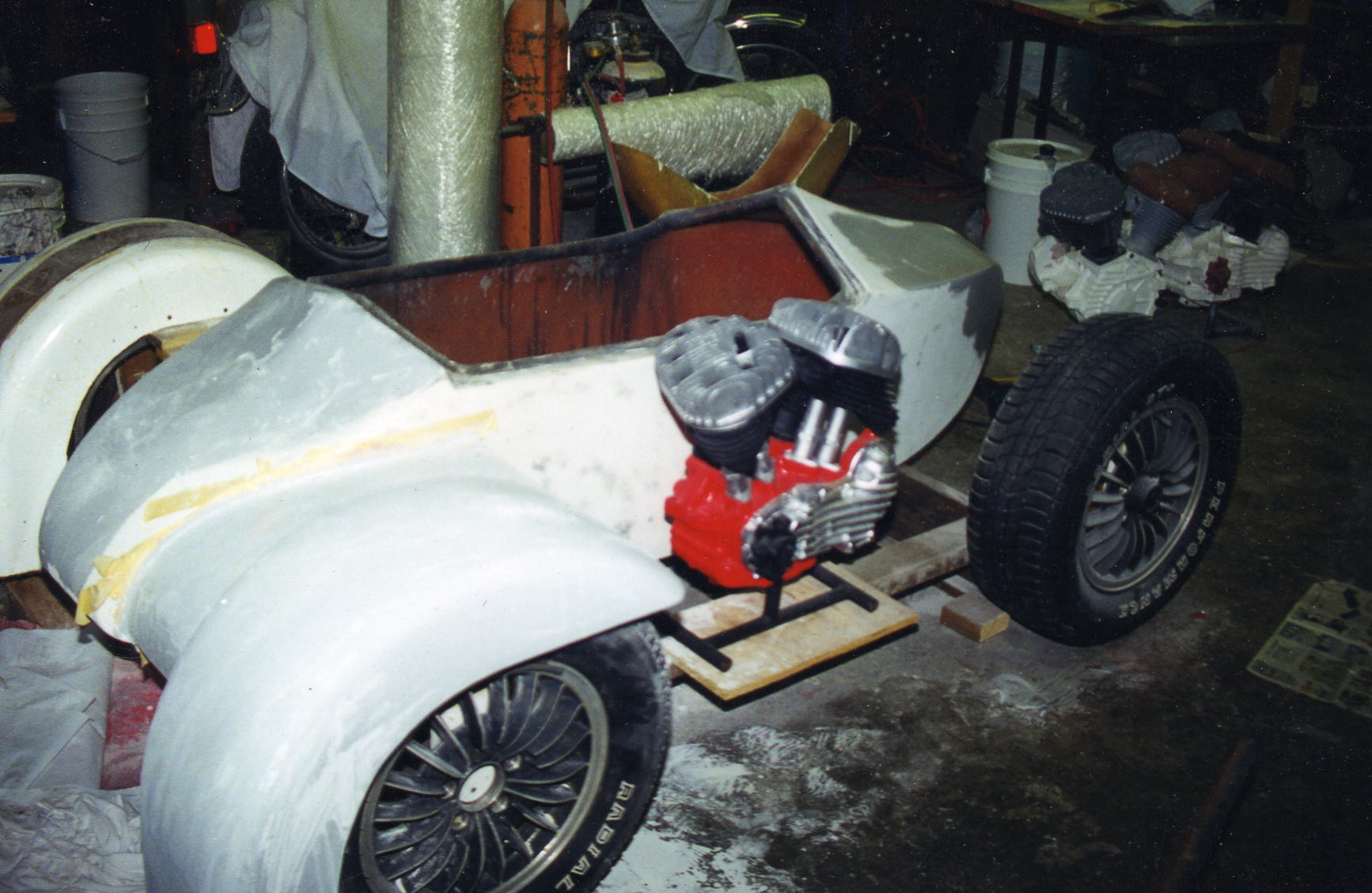

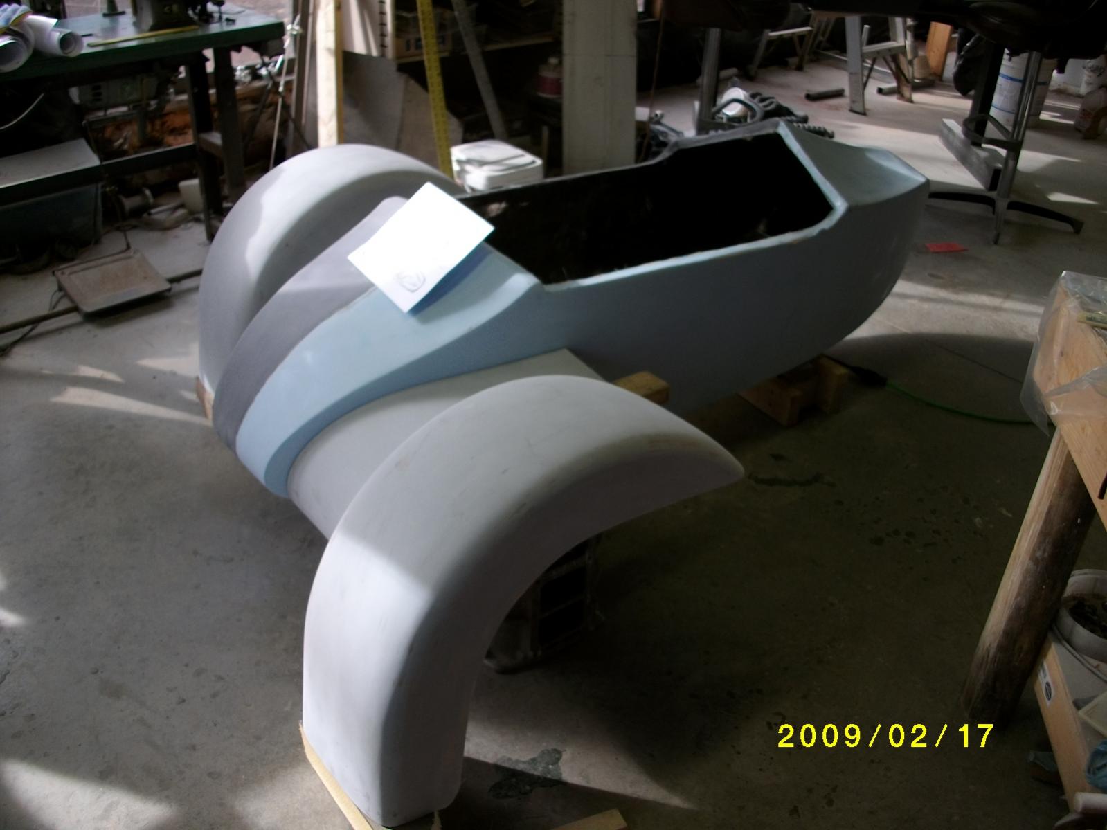

    Yes it did make us feel good. We became good friends with Larry. I was at a bike show when I met Larry. I had been manufacturing Motorcycle Sidecars for years. I built 450 units. I had the idea for his design in reverse about ten years earlier.

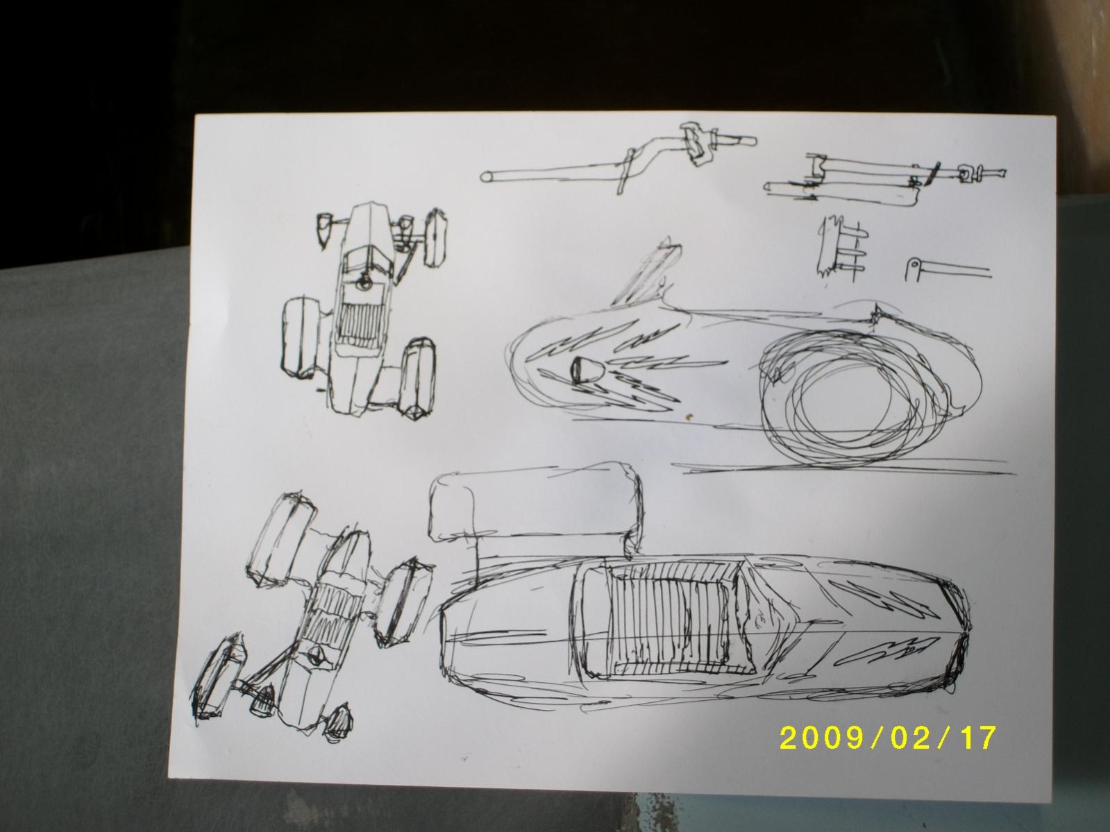

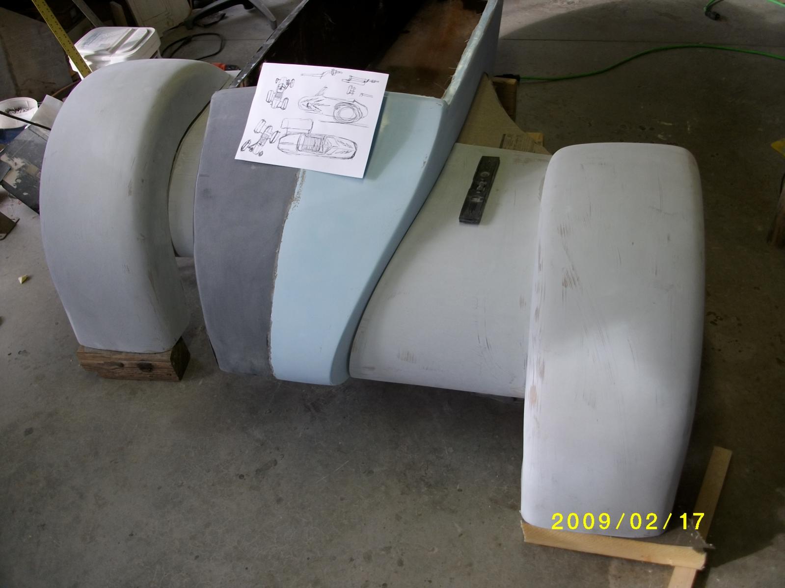

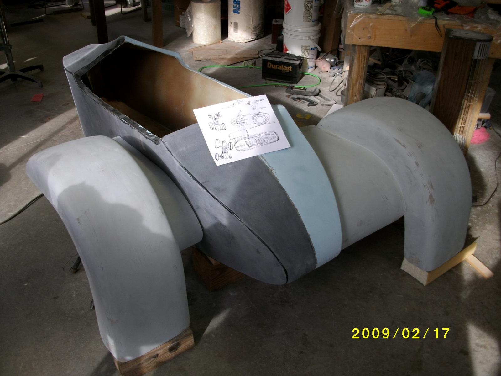

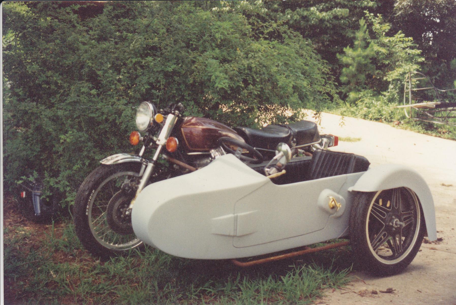

    Check out the picture. It was my idea to have a sidecar with two wheel and when I turned the handle bars a push pull rod would steer the sidecar front wheel. At the time I was living in New Hampshire. I made a trip to the Motor Vehicle Department and was told if there where 4 wheels I would have to register it as a car. I stopped working on the idea. When I moved to South Carolina in 1988 I brought the plug, or model of the body with me. Over time I ended up tossing it in the land fill, but the idea was still alive in my mind. So when Larry asked if I could build it little did he know I already had the design figured out.
    I thought that the Larry and his sidecar project would be of interest to a few of you guys.
    Thanks, Johnny Sweet

  8. This is a concept that I have had for some time. I call it Sidecar Cycle. My thinking is to remove all the **** on the motorcycle. Start by building a frame that covers both the motorcycle and sidecar frames. Suspension design, and power selection is almost unlimited. I've looked at using a 20-25 HP vertical engine. I would place a Harley engine in it, but there is so much corruption when it comes to used Harley engines. It would be my luck that what ever I picked up would be stolen and when I registered the dam thing the law would show up and take the engine.
    The design is different, but in reality it's the same as any bike and sidecar, as far as the wheel stance is concerned.

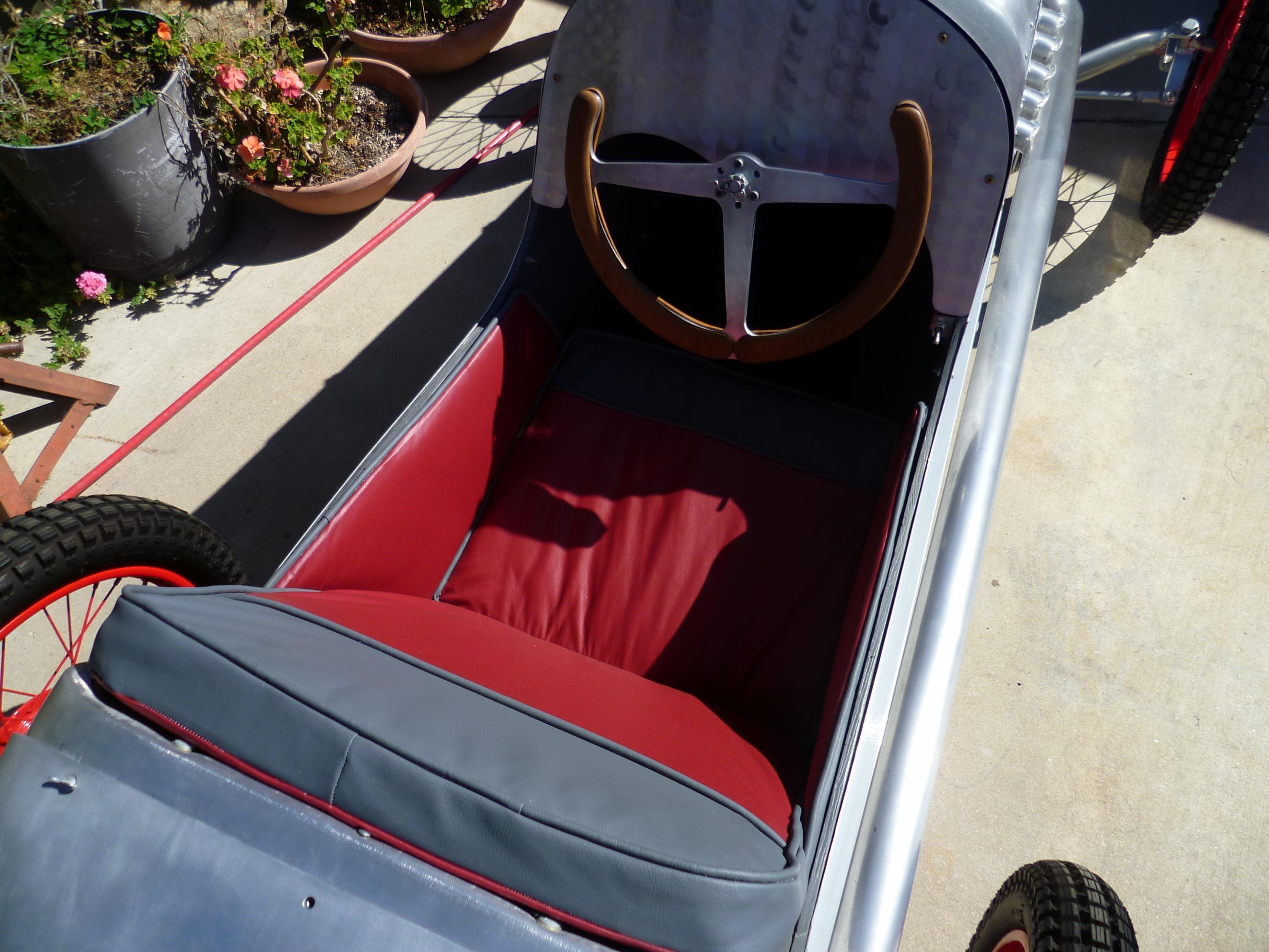

  12. I started the build in 2002 and finished in 2004. It has a Honda 6.5 hp engine that’s popular on water pumps to lawnmowers. Pull start. It’s more go-cart than anything and I use a Comet Industries Torq-A-Verter to put the power to the axle. Wheels are of a 60’s Honda Trail 90. It will run 50 mph with the current chain sprocket. Here’s a link to a local Saturday car show I took it to.
