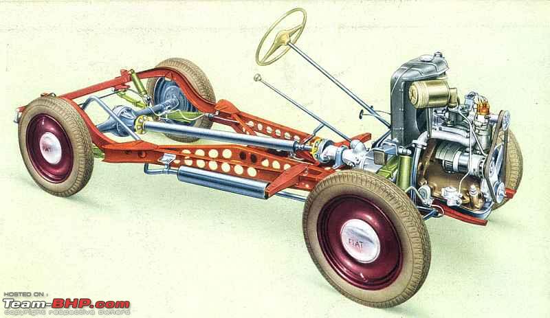

    Chris,
    I think that all Simca-5 had so-called quarter-elliptic leaf-springs, the same as the first series of Topolino Model-A. That means that half of the leaf spring goes from ch***is back up to rear axle and there is cut. Something that had Peugeot quadricycle and Citroen 5CV ...
    Some photos are attached as illustration (mentioned LeMans Berlinetta)
    Zoran

    ... later production of Topolino Model-A, B and C had half-elliptic leaf-springs with rear axle at the middle of leaf bow. Something heavier (more expensive too), but better keeps axle at place if there are not additional rods.
    Some photos are attached as illustration.
    Zoran

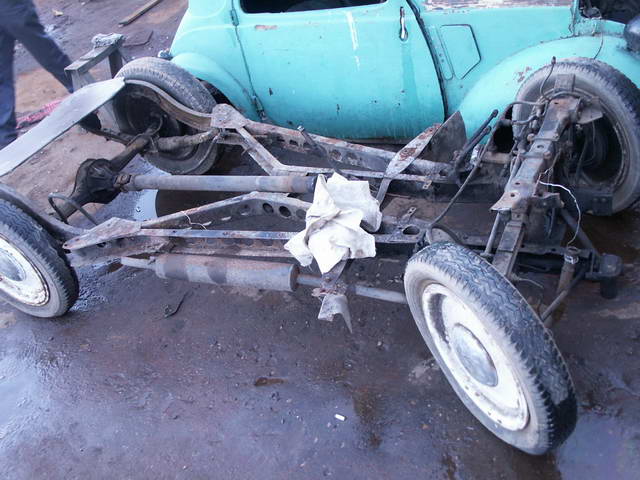

    Just one short, this time personal, story about FIAT 500 Topolino... As I mentioned before, with my modest help (saved pocket money), my brother bought FIAT 500 c Topolino Belvedere – just to have “wheels” for graduation year in Belgrade's Secondary Mechanical-technical School. That was in 1967/68... Our father didn't want to give him our FIAT 600 d – professor could be jealous, minority had any auto at all! So, we repair it and he often went to school driving that car – not usual in those times at all. Just one more student between hundreds of them, practiced that, driving his father's FIAT 1300 – making jealous warden of school. Then he crashed one day in the centre of Belgrade – into city bus (brakes failed). So, I suggested to him that we could make something special of it, with new body and more powerful engine and so on... We didn't know for hot-rods, street-rods, customs – but, something like that in mini-scale... he wasn't interested- rushing to repair ti for the end of school and graduation! So, he did it in great scale, in spite that auto was old and small, but was his – painted in nice red-black combination after repair. Later, we couldn't registered it again and it finished with some gypsies and probably on junk-yard...
    Many year later, my paths were crossed with another Topolino! This time with one reconstructed by my great friend Maslacak, both were members of Serbian Society of Motoring Historians... He found and later got or bought ruined and abounded Topolino Model-C, up to half in mud. I saw it a few times from the bus, laying in mud beside periphery road – and later reconstructed. He spent a few years a lot of work and money, with a lot of help from friends from back-yard garages and machine-shops. He didn't managed to finish everything inside, but was present at few old-timers-shows. As he became seriously ill and money-less (that often goes together), he gave Topolino to Belgrade Automobile Museum, where it is still... Photos are attached.
    When he recovered (for short time), we made plans to build some special on Topolino basis, in a style of small Bugatti T-68, that Ettore designed and built in Paris during occupation of France. Topolino ch***is would be wonderful for that goal – and, I had one! He had all literature, experience, a lot of components and parts, some helpful friends - and I had big back-yard for work... Unfortunately, his illness returned and he died. Everything that he collect – simply disappeared after his death. So, I stay with ch***is and good engine and gear-box, that collected in meantime, and with a few friends that could help to build one modest special... Replica of Bugatti T-68 was put on a side, without my friend I didn't have anymore power to do that. Then, I moved here to Swiss and forgot on such plans... Everything that I had, maybe is still in my old back-yard. Maybe waiting for next time...

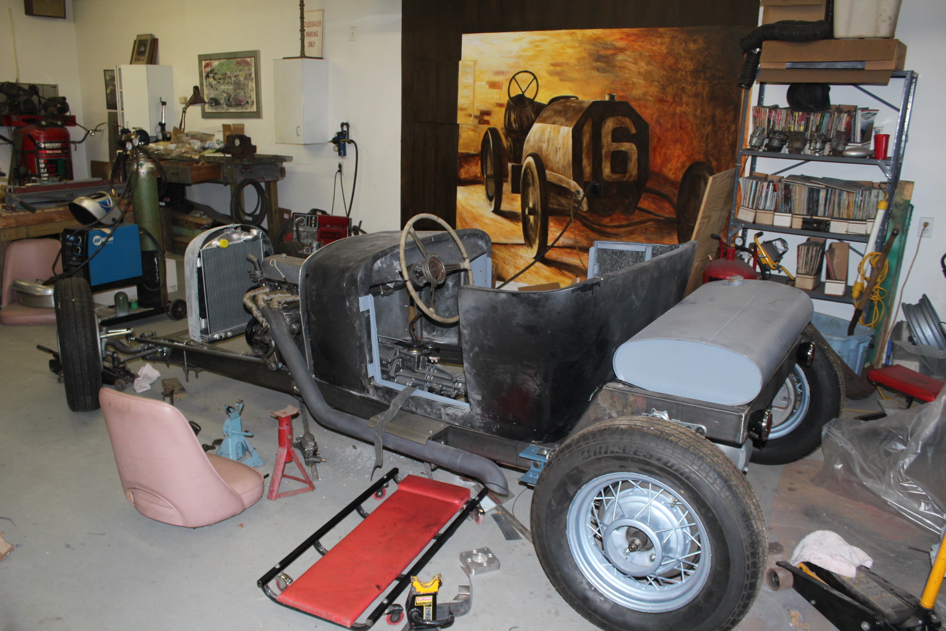

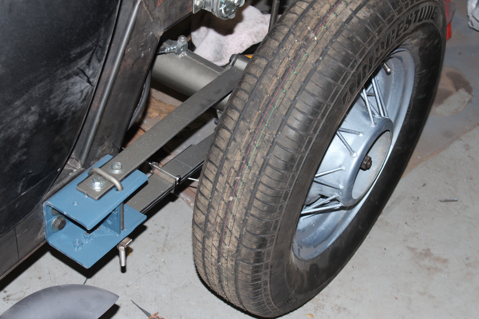

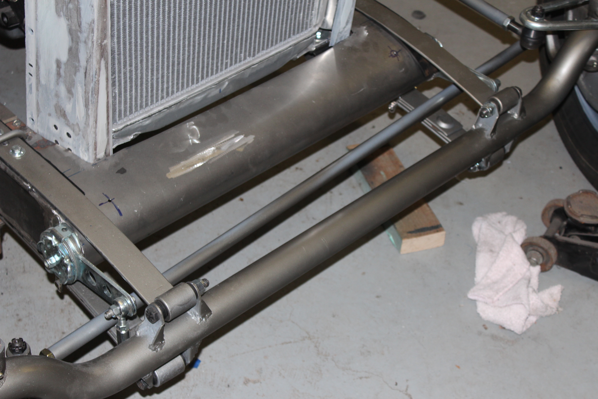

    My modified project is certainly not a cycle car, but is inspired by GN, FN, HRG, and Harry Miller. Note the eight spring suspension. IMG_3929.JPG IMG_3930.JPG IMG_3924.JPG

    Charles,
    Making replica of cycle-car is quite rare opportunity to follow!
    Ade's Jappic is above anything I saw, the same as Graftom and Charter-Lea as recreations of originals...
    I am sure that most of us will be glad to follow your excellent work on personal inspiration of more "serious" automobiles than cyclecars are!
    Please, keep us inform!
