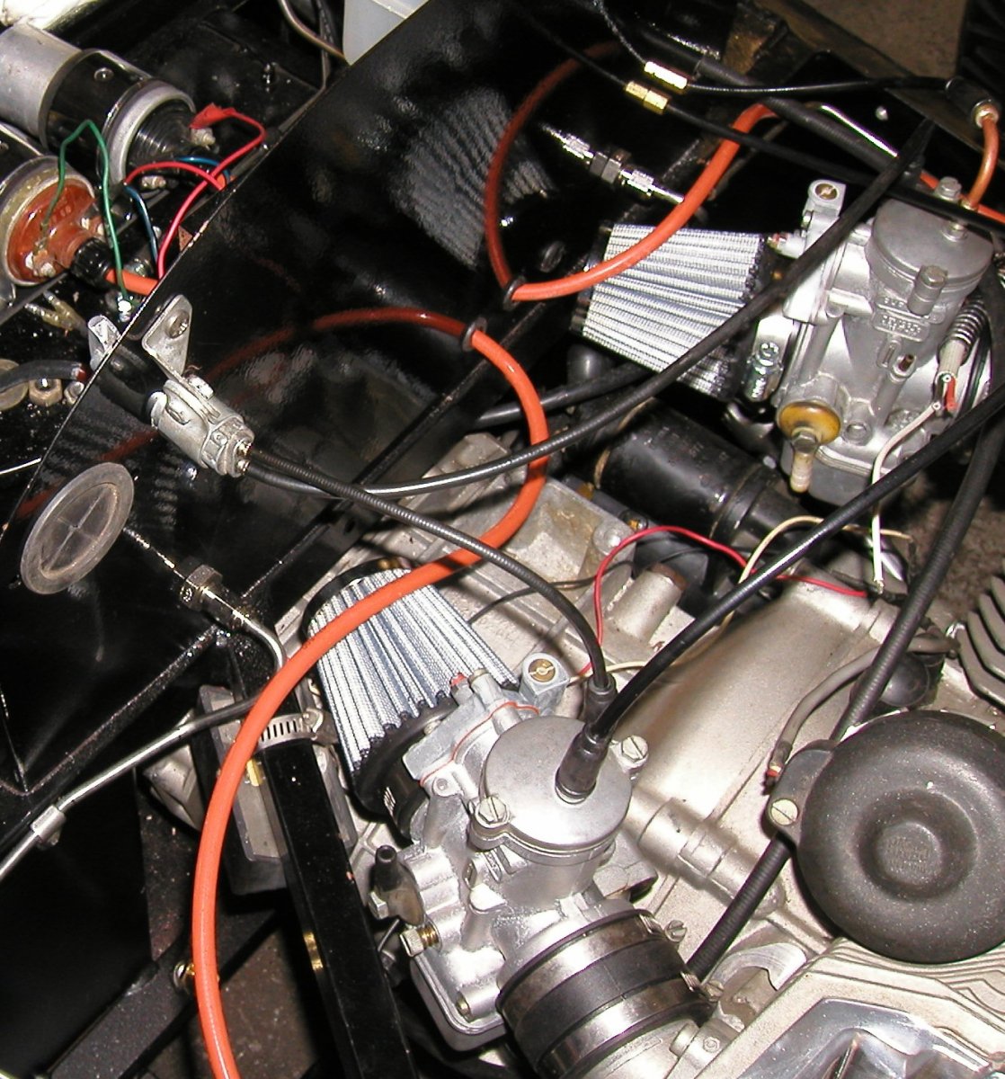

    Have you dropped a bowl and looked to see if you can verify your theory by looking at the wet level mark left by the fuel? I imagine you've already verified the float levels are set correctly?
    What intake setup are you running? Are you running a stock elbow setup, velocity stacks, straight? The carbs angles are important and sometimes they need to be twisted to compensate for hard riding/leaning on airheads. You'll notice on performance Guzzi bikes the intakes allow for the carbs to be tilted in and up so that as the bike is put in a hard lean the float bowl stays perpendicular to the ground and fuel can flow down into the head. Depending on your intake setup you might be able to twist the carbs a bit to achieve this affect. Also don't know the specifics of your motor, but PHF-30's seem on the small side for a 1000cc Guzzi in a vehicle as heavy as a Cyclecar. How do they perform otherwise?

    My error, they are 36mm carbs (30's were original for the bike). I have set the floats and double checked them. I don't see how the fuel would leave any kind of line in the float chamber as this happens so fast. I thought about twisting the carbs and that would work for one of them turning one way but bad for the other one. Here is a pic of the carb setup.
    Thanks for your reply. I hope you see something that might help.

    If you are turning both ways, angle both carbs and re jet as needed. Merry Christmas, Gary:)

    Angle how? Do you mean rotate the carb on it's manifold? What about swapping the manifolds from side to side so that they angle outward rather than pointing inward? That would change the angle of the float pivot. Not sure what that would do.

    I am not sure if changing angle of carburetors could have any good impact on your problem?
    If you angled them either inwards or outwards - one carburetor should have better results only in left corners/curves and the other carburetor in right corners/curves, but each of them should have even worse results in opposite...
    Therefore, should be the best position as it is (neutral)? Without a few experiments with changing types and models of carburetors (too complicated and expensive project) – it should be better just to change driving in such special cir***stances? (or to accept all that issues as they are)

    I think turning the carbs some on both manifolds might help with minimal side affects and costs nothing. Gary

    Worth a try Gary; easy to do.

    About fuel surge:
    I have seen one center much large remote float chamber from a GP carb placed in the middle between the two carbs
    You could also use a "pumper carb"
    The other thing I have done is dry sump the carbs ..... remove the floats and use a scavenge pump at the desired upper level. I have used Jaguar SU choke pumps ..... you must turn on the scavenge pump before the feeder pump

    Thanks Bluto. The Dellorto carbs are called pumpers due to the accelerator pump built into them. That may not be what you mean. They have the float chamber built into the bottom of the carb casting and it feeds the main jet. I don't know if that could be changed easily. If I tilted the top of the carb to the outside that would make the fuel surge away from the vent and may solve the problem as Gary suggested.
