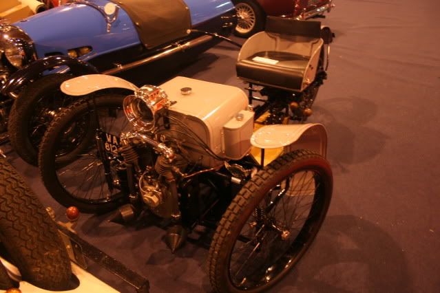

    Those Morgans are just plain cool! Gotta build something like that when I get done with the HA/GR.

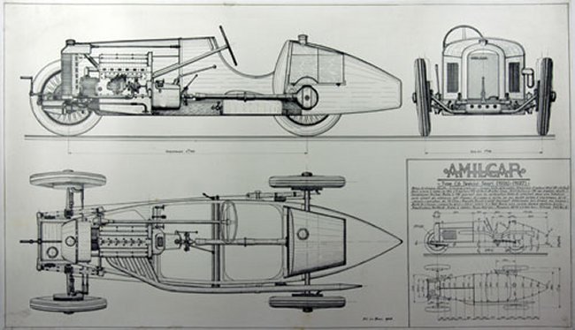

  16. Bob,
    Thanks for the pics of the Panhard! Here's a neat Amilcar drawing with a wooden body:

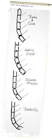

    Bob, Thanks for the great series of "how-to" pictures on that body.
    That's really important information to have in a thread like this!
    I've worked with some wood. I bent the 5/8" sides of my truck bed with just hot water sprayed on the outside of the bend and I've made a wood kayak and making another with the same hot water spray to bend 1/2" or larger boards "easy" radii.
    That looks like it's about 1/4"/8mm and probably wouldn't need steaming.
    Here are several ways of joining the edges of the boards. [​IMG]
    http://www.diy-wood-boat.com/Strip-Planking.html
    That looks like it is probably the last and most time consuming way to get to look right. Lots of small craft are using the bead and cove method lately.
    Companies are selling cutters for easily making the bead and cove cuts.
    Yes, It's boat stuff, but it is a "boat tail" car body so the techniques apply. :cool:

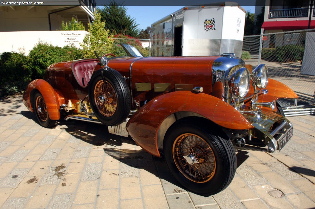

    HS 'tulip wood torpedo' car

    Not the HS I was thinking of, but yours is perhaps even more lovely. My mind boggles at the craftsmanship in those rear fenders.
    Again, not a cyclecar. But of the era and showing construction techniques, so I'm going to nod sagely and look forward to more like it. :)
    You people are going to drive up the cost of this project considerably, I can see it now. Luckily I'm going to first attempt to build it for half my maximum budget, which should give me some breathing room as far as finding the wood strips I'm now adding to my 'parts needed' list.
    EDIT:
    I thought I'd finally found a pic of that HS I saw on the TV, but this one says it's mahogany (plus aluminium and copper rivets). It's a 1921 Duquesne-bodied H-S H6B Torpedo Skiff.
