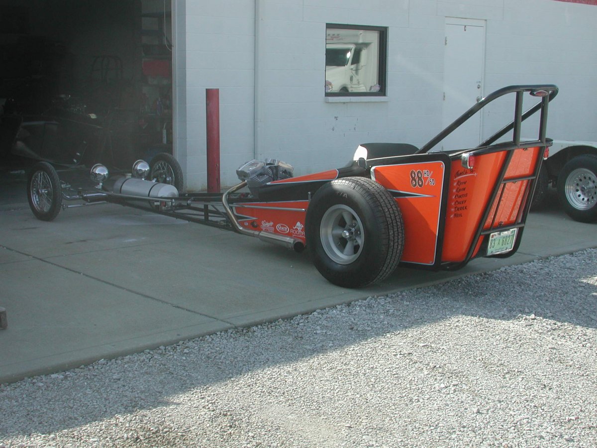

  12. I really like a BSA FW32 so I would follow those lines but it would have to rear wheel drive. Suzuki rear is a good option. They are very popular for off roading here so should have a good variety of ratios available. Aiming towards air cooling if for no other reason than simplicity but the Honda engine is definitely worth considering. Beautiful trike, btw.

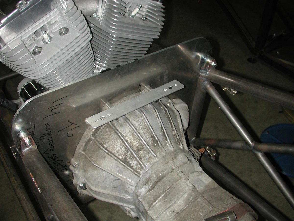

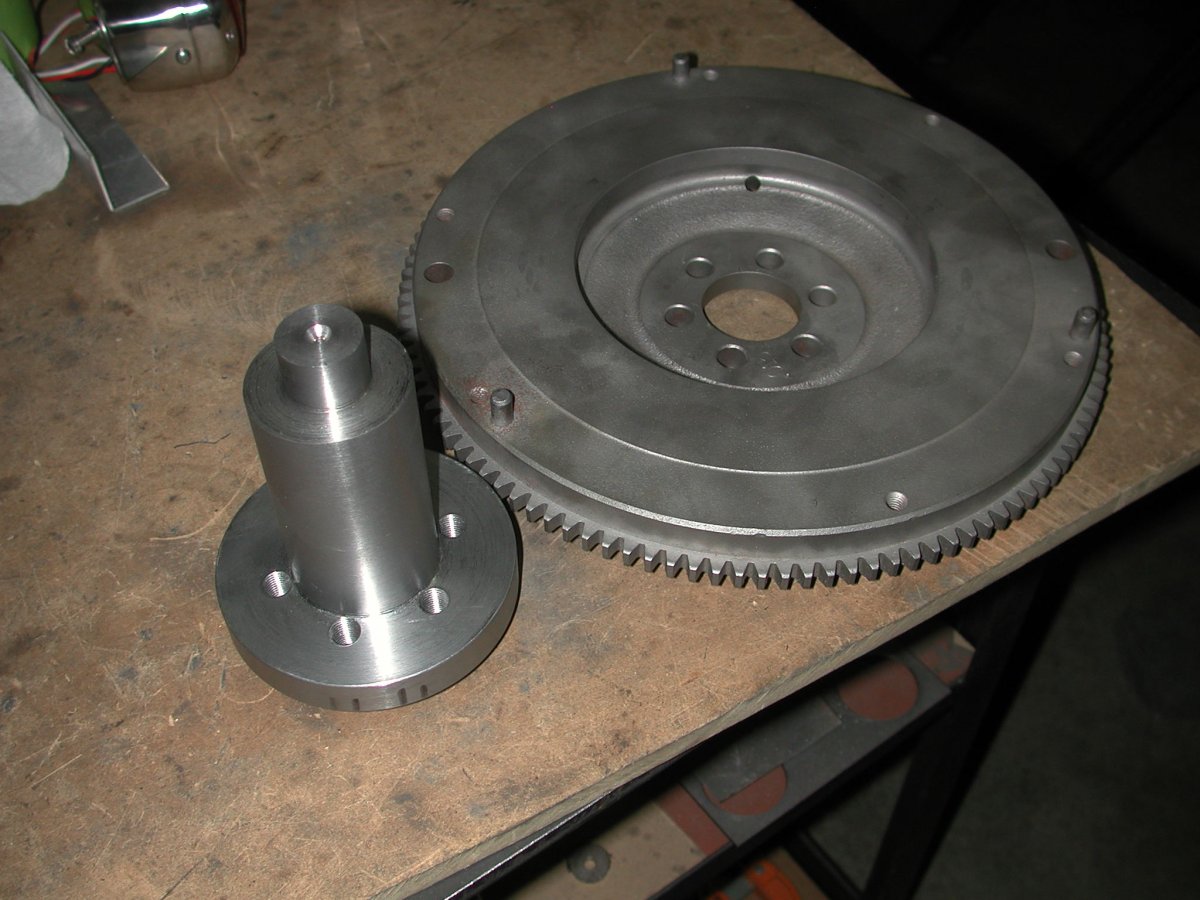

    Regarding adapting motorcycle engines to rear wheel drive here are a some shots of a project that I did for a customer several years ago. We used a new H-D 88" Twin Cam B and an adapter that was originally intended to put a V-twin motor on a VW style trike. I used a Toyota five speed transmission (and the rear end) from a small pick up by making a hub to put the Toyota clutch on the H-D crank. I guess that is a cycle car in a funky sort of way.
    Here is the start of the flywheel adapter. I used an outboard bearing to give it a bit more support once it was fitted to the crank.
    This one shows the adapter which was a pretty rough casting before I cleaned it up in the lathe

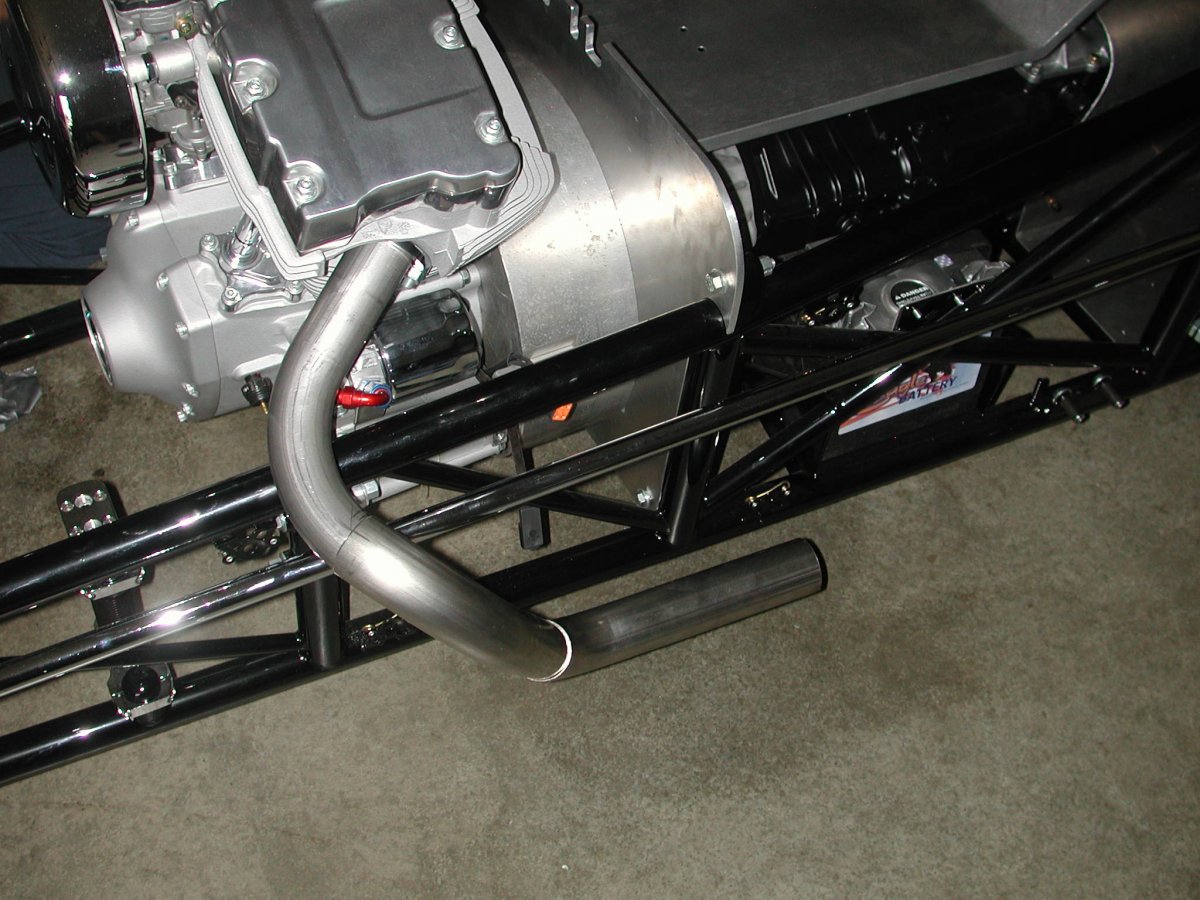

    Here is the other side of the engine/transmission installation. The angle aluminum bracket was to mount a tray where all of the electrical components were mounted. In the photo above you can see the tray and the notches in the mid plate for the engine wiring harness

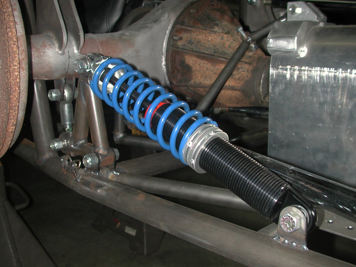

    The rear suspension had a triangulated four link and the shocks were operated by this rising rate linkage which made the car ride nicely over small bumps but not bottom out on big ones.

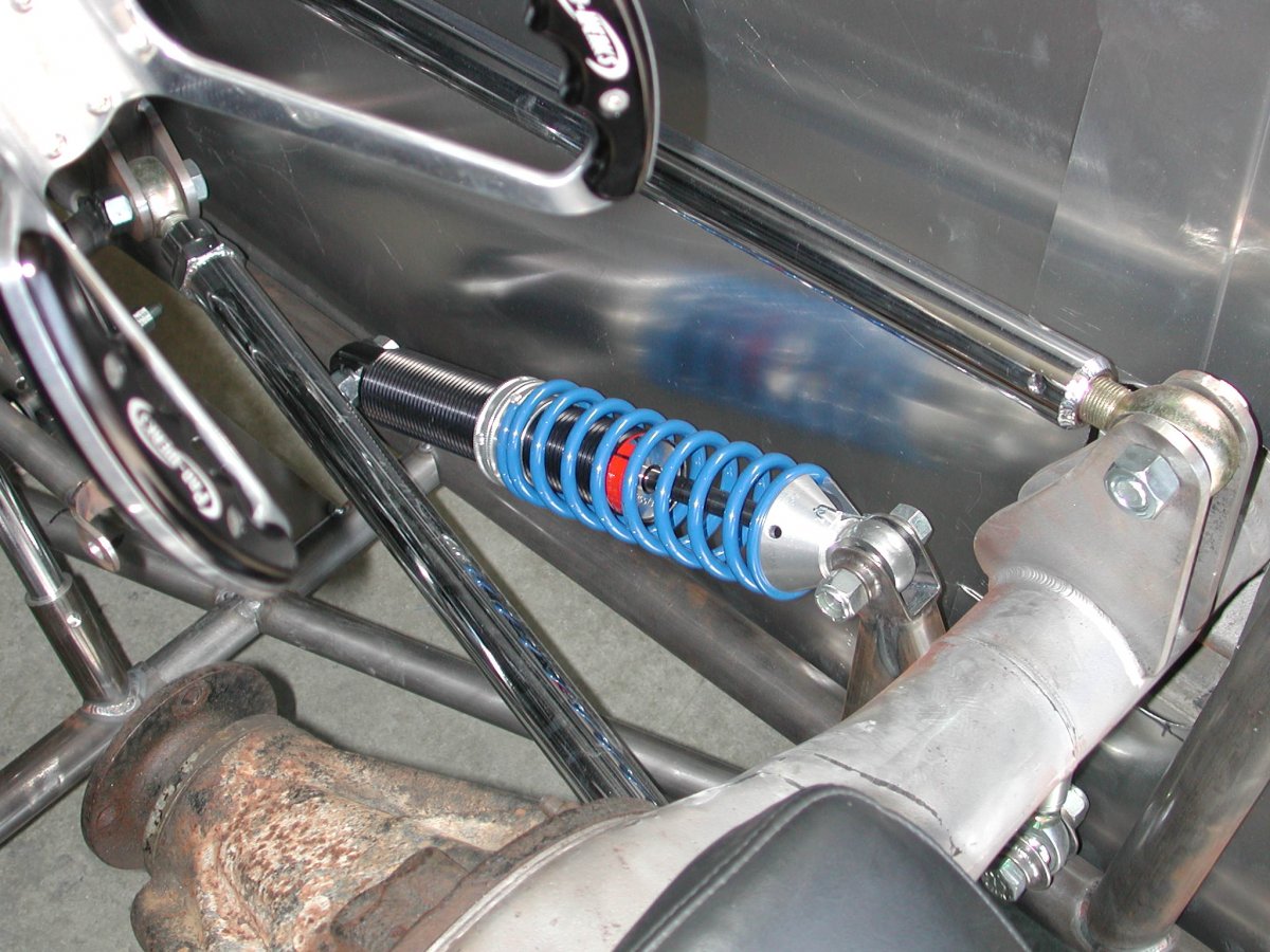

    This photo gives a better picture of how the rear end is located.

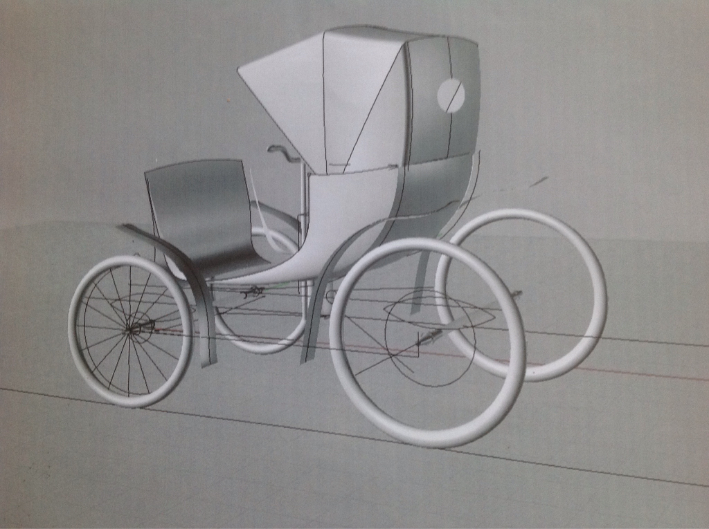

    Hello, Eric!
    Excellent sketch of beautiful voiturette from the last decade of the XIX century!
    Should be nice to build one as a replica? A problem could be to find so big and light wire-spoked wheels...
    At the rear, or under a seat, there is a lot of space for a gasoline engine, and transmission, or electric-motor and batteries? Electric power is more legally and socially acceptable here in Europe. According to European Union Directives, so-called "light quadricycles" could have:
    1. gasoline engine up to 50 ccs (not enough), or
    2. diesel engine up to 4 KW (good power and torque, with a lot of weight and vibration), or
    3. electric-power up to 4 Killowats (good, but batteries are heavy, expensive, controllers too)...
    I was thinking about hybrid power as was mentioned later in posting with photos of a few wonderful cl***ic ch***is. Only, I am not sure if Swiss officials should accept such power as electric power?
    However, if it is diesel aggregate up to 4 kilowatt - maybe that could be a solution?

    Hi Motoklas
    The spindles that I have with the axle are nearly 200 mm long and I think we're meant foe wooden spoke wheel with a big hub. Those are still being made here in USA by the Amish craftsmen and are very reasonably priced.
    I also have access to some very talented electronics engineers in the electric vehicle field so that would be the easiest path for me. Controllers were very simple stepped style designs or I could cheat a bit and use a modern forklift controller and hide it in a wooden box.
