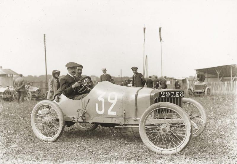

  2. I guess the registration number is only visible when the engine is shut off?

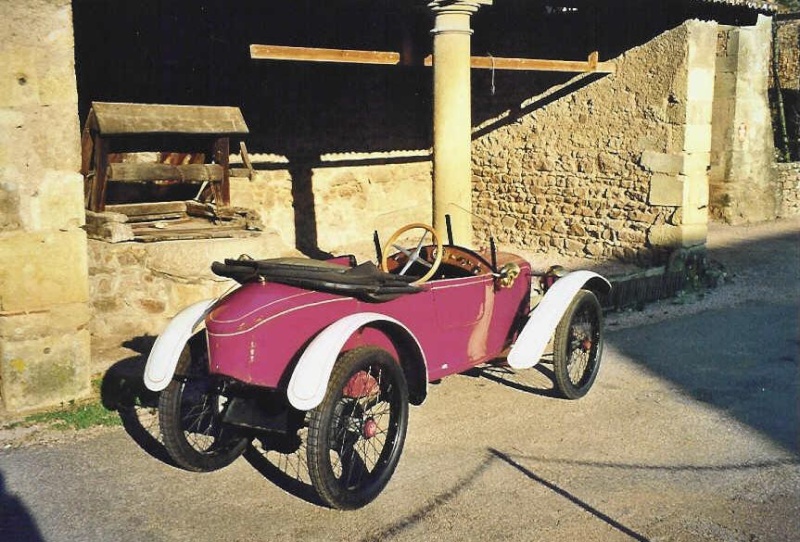

    I love the look of this.................
  12. pipopak
    Joined: Oct 23, 2011
    Posts: 146
    pipopak
    from florida
    In a "car" with so many "safety features" any extra padding is probably an improvement (doing my share for safety also).
