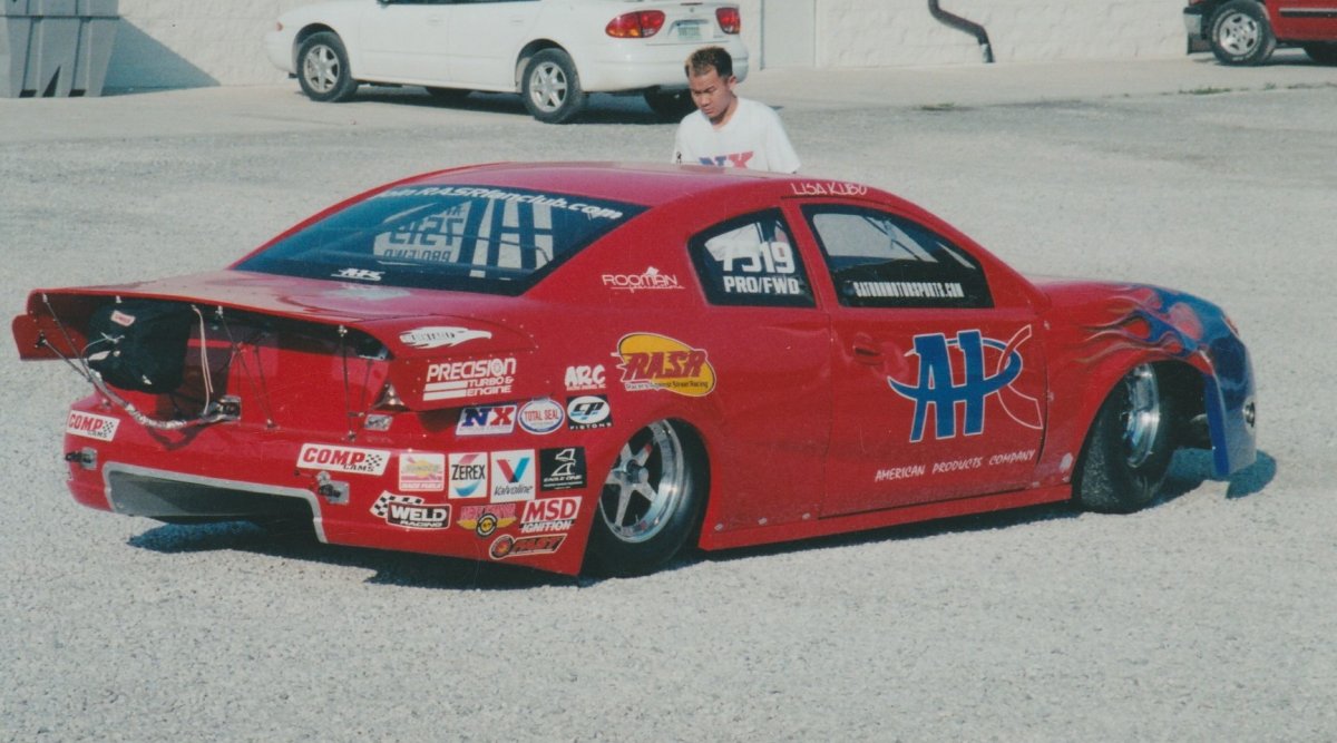

    I came to get away from some **** in my life in Oz and to do a season with a professional drag race team, ended up working for Paul Smith at Chuck Etchells' operation and stayed. It has been a pretty good ride as I have been in the winner's circle at the US Nationals (crewing for Robert Hight and as the builder of Jerry Savoie's bike), restored some cool cars, built the first seven second FWD drag race car, qualified for nostalgia top fuel at Bakersfield in a car that I built myself and through all that I have got to see a lot of a great country and have become friends with a lot of my heros.

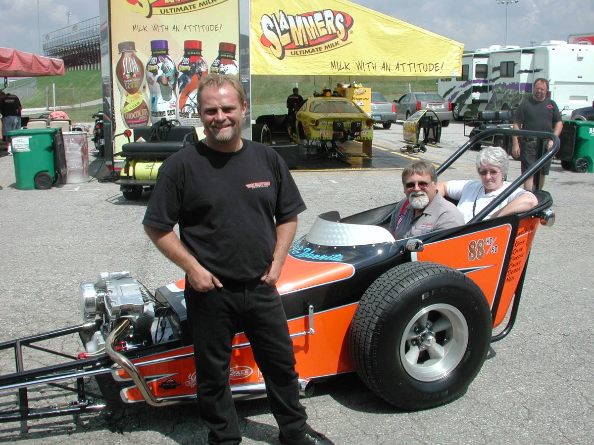

    This one is somewhere back in the thread somewhere and was my solution to putting two people in a street legal dragster.

    Roo, that's too cool. Will it wheelie?

    Roo, what state was that street legal in?

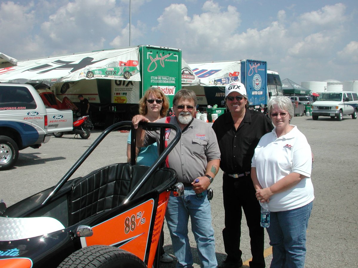

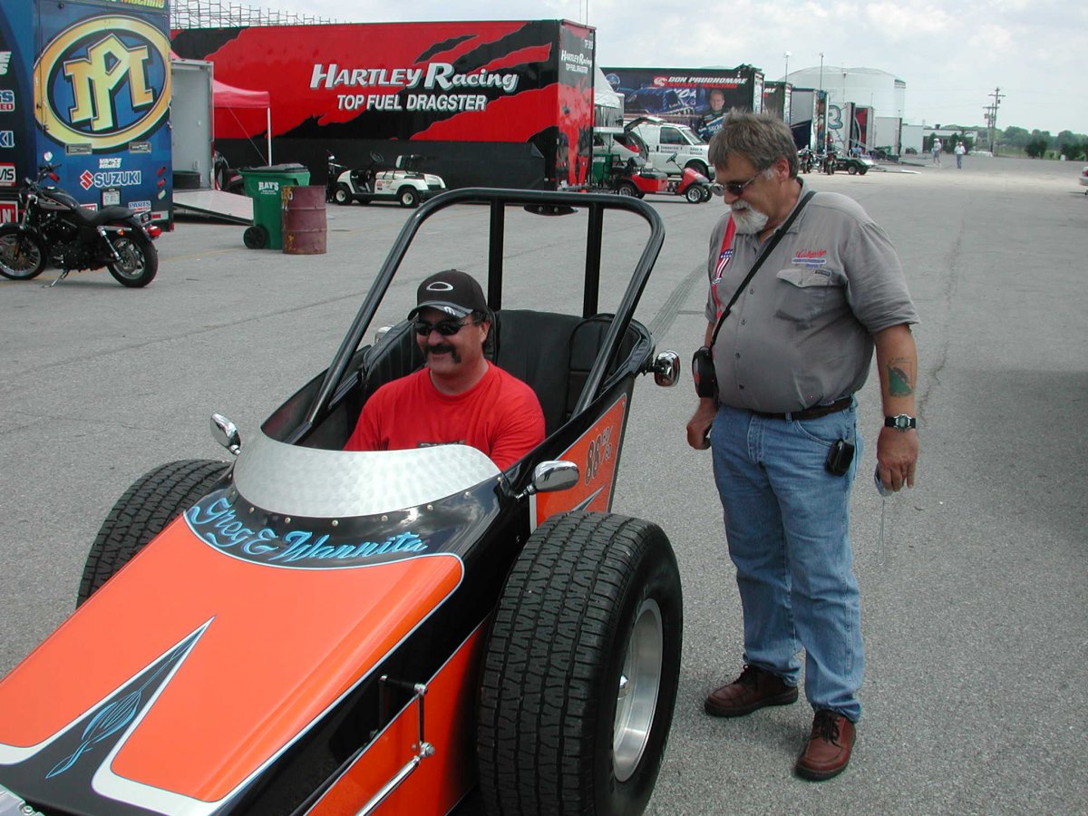

    It is not bad with one up but with a p***enger it was easy to keep the wheels up . The front suspension is a dragster torsion bar deal and at the back there is a triangulated four link with coil overs on a rising rate linkage. Transmission and rear end are Toyota pick up. The guy that I built it for was a Vietnam vet who spent his time over there dreaming about a street legal dragster and I was the first one that did not tell him that it could not be done. Sadly the big C took him out about a year after I finished it. He did have some fun with it in that time as evidenced by the day we took it out to Indianapolis Raceway Park while the fuel cars were testing. Gary Scelzi loved it, as did Force.

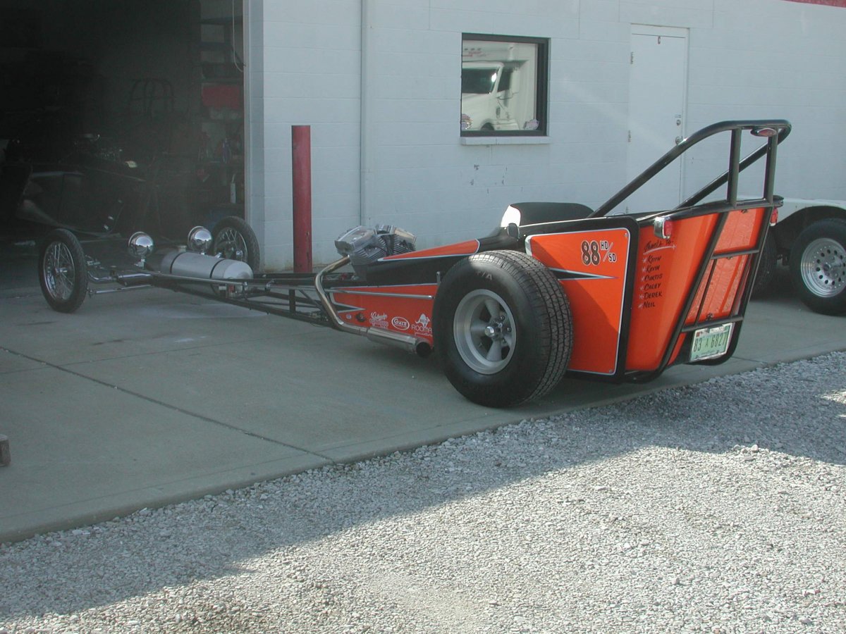

    Indiana. The owner's wife ran a BMV licence branch so to avoid any suggestion of working the system we submitted photos for approval. The only thing that they did not like was the aluminum windshield as they told us that it had to have a clear one (with a wiper). I mocked it up with a piece of s**** Lexan and taped the cut down wiper off my brother's 6"chopped 49 Ford to a cleco that was holding the Lexan in place. We sent them a photo and they signed off on it. It was still that way when the local cop came to do the final sign off and I told him the story and he said "Works for me".
    In this shot you can see all the street stuff--headlights, tail lights, even a third brake light, mirrors etc. The car was never stopped by the police for a closer look.

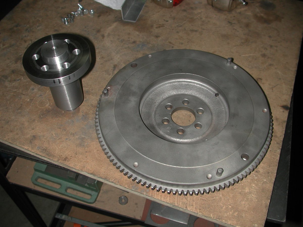

    Did you use a torque compensator on the output shaft?

    I made an adaptor the mounted the Toyota flywheel on the H-D crank along with an outboard bearing for support

    Roo- Nice work. I'm using a 2 liter S&S motor and have to use a torque compensator to smooth out the torque spikes when the piston fires. Using 2 bearings on a floating splined shaft to get to the transmission. About 10" to the trans from the back of the motor.
