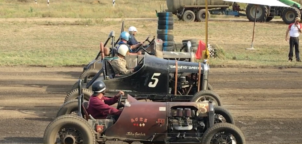

    ^^^^^^^^^^^^^ Bob is that the John Gerber clone with an A rear in in? Bob

    Bob, I do not know. The image was posted without any caption or attribution.

    Ok, looked a lot like it with some parts swapped around. Bob

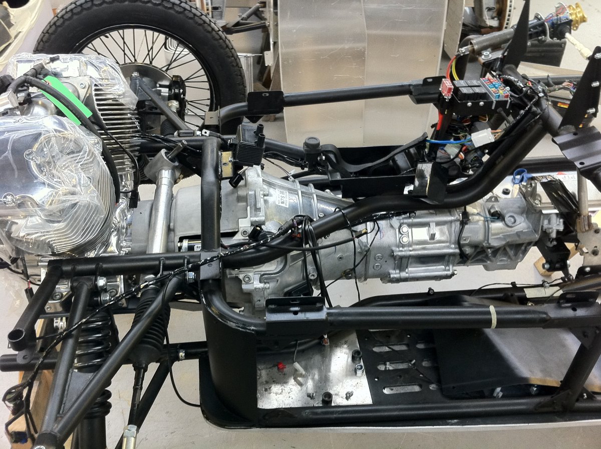

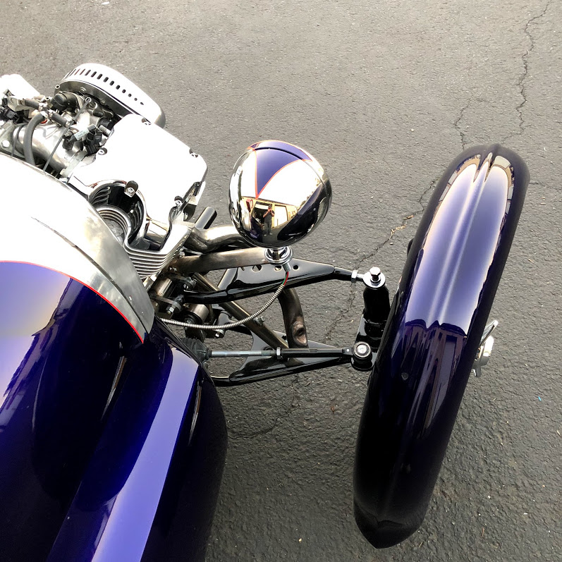

    The new Morgan had the front shock mounted on the lower a-arm way inboard and had bad problems with bent a-arms. Learn from their experience. Machine looks very nice.
  8. Erik B
    Joined: Sep 4, 2006
    Posts: 2,118
    Erik B
    Morgans have lots of problems with poor engineering. The bump steer problem was so bad that 2 companies made replacement A-arms to fix it. Also, they use ball joints with no adjustability for alignment. And the bevel box and belt drive are noisy and have lots of issues. I could go on and on.

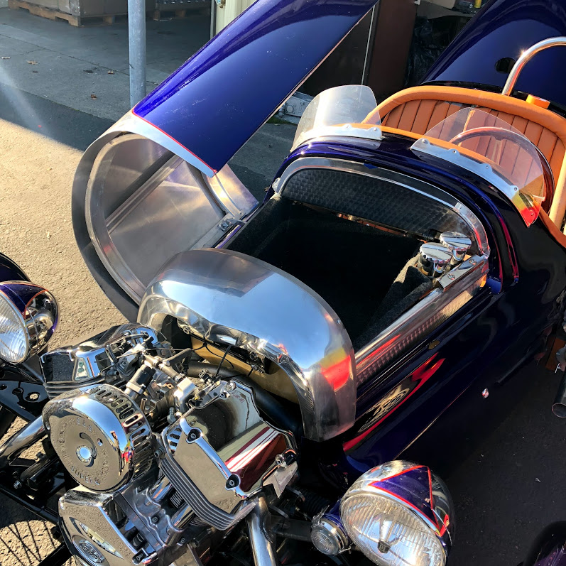

    Here is a better shot to see the body. If anyone wants more info they can PM me. OttO Cycles, named after Nicholas OttO and his invention.

    yep John Gerber copy but without the chev 4 engine

    I found an adapter to put a H-D engine on a VW transaxle on e-bay (I guess it was made for anyone who felt bad about running a VW trike) and modified it to mate with the Toyota bellhousing.

    I am making a steel weldment to mount to the back of the motor and clear the steering rack. It will have additional torque reaction bushings to insulate the motor. Then there is a aluminum casting that mounts to that and houses the compensator and bolts to the transmission. The splined shaft mounts in bearings to the trans input. Lots of things to consider.

    ErikB, Roo & anyone else with applicable knowledge:
    I've been rounding up parts for a couple of Harley powered projects --
    1) c1947, 3/4 midget, to use rear engine & transaxle. (Presently has first-year, 1938 500cc BSA GoldStar & transmission, that would be best used by someone in a BSA restoration, rather than in my fairly crude home-made racer.)
    2) c1948 full midget, front-engined, originally built with two knuckleheads in tandem, to make essentially a V4 (fore-and-aft "crank" centerline). Knew nothing about Harleys when I bought this, figured I'd pick up a couple of knuckleheads, found out they sell well into 5 figures, so gave up on that. I did buy a nice, rebuilt Shovel-Head, and am looking for a duplicate.
    My questions revolve around adapting Harleys to automobile trannies:
    I'd ***ume the Harley crank/bearings do not have the capability to absorb clutch throw out bearing thrust. The description of the adaptor for the Toyota mentions the addition of a bearing, which is presumably for this purpose. I'd love to see a sketch showing the conceptual arrangement of the coupling components. It seems to me that the flywheel must in effect be mounted on the transmission, with a slip joint between the the engine and flywheel. I have given some thought to an Alfa Romeo transaxle, which, although front engine/rear drive, had the flywheel mounted on the rear located transaxle. But, this would be a bulky overkill, and would deviate too much from "period correctness".
    Is the Harley-to-VW adapter commercially available? Website? Does it include provisions to absorb the throw out bearing thrust?
    Hadn't thought about it before one of you mentioned it; I intend to "soft-mount" the engine, but is vibration from Harley firing impulses apt to be a problem, such that an elastomeric drive coupling would be recommended?
    Maybe the expedient solution would be to forego the convenience of a clutch & transmission, and go with an in/out box and push starts!
    Any comments/suggestions would be appreciated!

  15. Erik B
    Joined: Sep 4, 2006
    Posts: 2,118
    Erik B
    Hi Desmo- Sorry I can't be of much help but be diligent on your Google searches. Someone has probably done it before.

    I was wondering how you addressed the issue of isolating your engine's crank from the thrust from the throwout bearing. I've ***umed you are using a standard shift transmission with clutch. I'd guess you'ld need to provide an added thrust bearing between the flywheel and clutch, and a splined slip joint between the crank and flywheel. Or maybe you're using a set-up like an Alfa Romeo Milano sedan, which has a front engine, and a rear mounted trans-axle, having the clutch and flywheel integral with the trans-axle. One could be made from a VW trans-axle, which would be more compact, with the gears located aft of the differential.

    Here is what Morgan did and they still have problems. the Compensator is now failing. The layout is engine, Compensator, thrust/support bearing, flywheel, clutch, gearbox. Maybe another bearing next to the engine. They tore up gearboxes without the Compensator. The engine torque pulses are horrendous.

    I have several parts to accomplish what isolation and integration with the trans and engine. I'm using a steel weldment to mount to the back of the motor and that connects to an aluminum casting that flares out to the transmission flange. Miata 5 speed trans being used. There is 2 splined shafts that fits the crank output that is supported by a bearing at the front and back of the casting. That isolates clutch input from the motor output. Cush drive is also in line and 4 motor mounts help isolate the motor and the trans has a rubber mount at the back. It's all custom made so there is no source for parts.

    Erik, what are you using for the cush drive?
  22. Erik B
    Joined: Sep 4, 2006
    Posts: 2,118
    Erik B
    Making my own.

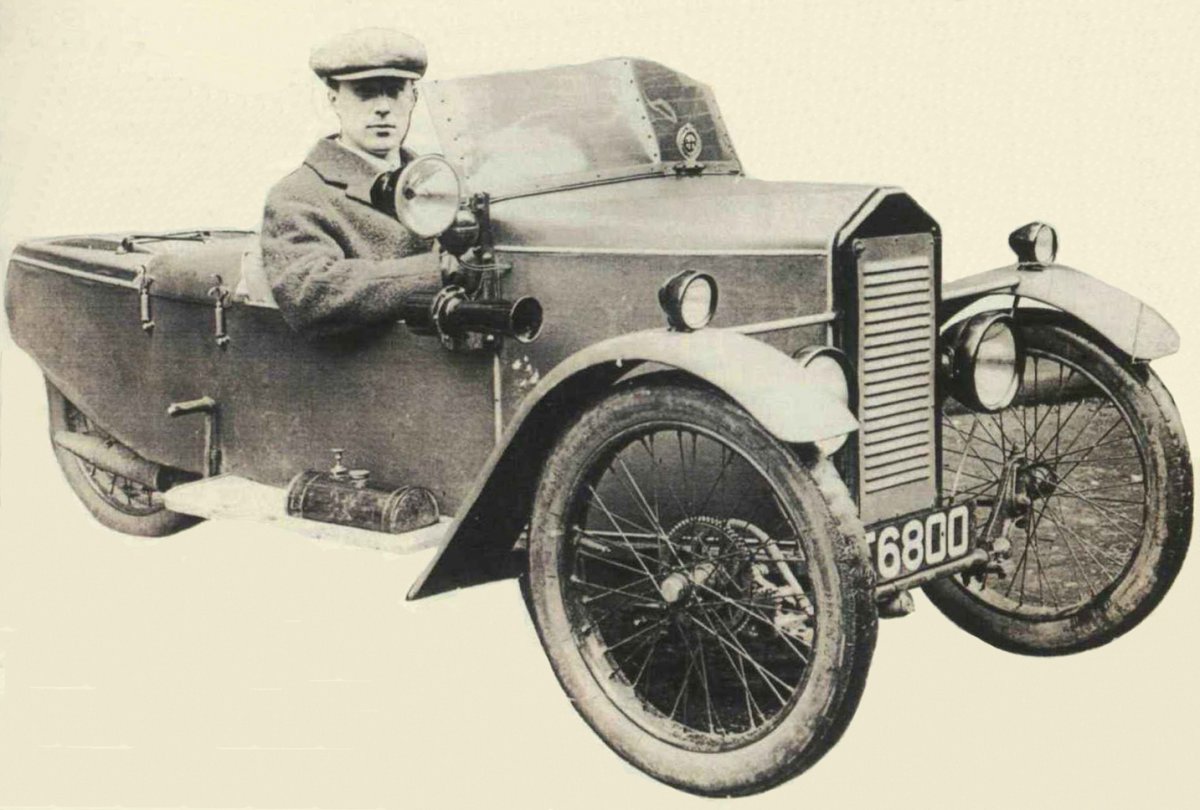

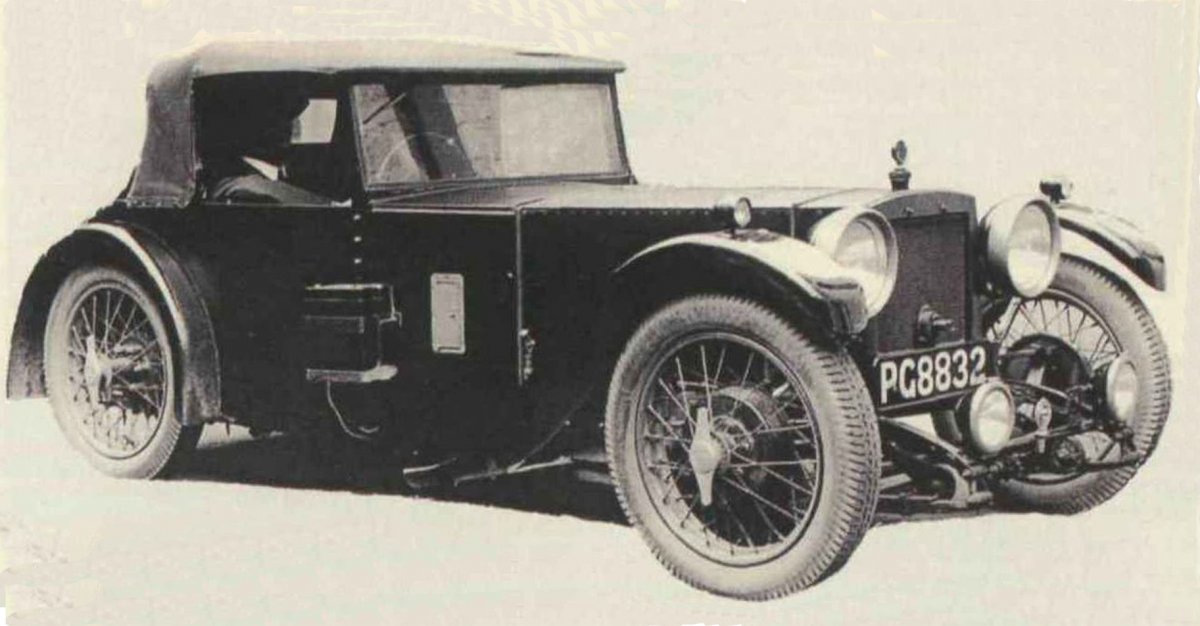

    This looks a lot like a trike I came across recently:
    Despite the Morgan-like look, the Hudl***-Jap had a 600cc JAP single behind the driver. It was built around 1924-6 by a young man whose father had built horseless carriages. The engine and transmission sat in a cradle that pivoted with the rear wheel so that the chain tension remained constant. Front suspension was by quarter-elliptic springs. It was set up for front brakes, but they weren't installed. In 1929, he started another special, which he completed in 1931, a this time a four-wheeler:
    Its 1100cc JAP twin drove through a Riley gearbox. The body was leathercloth covered plywood. In 1939 he began to stretch it to a four-seater. It ended up with a Riley engine and a pre-selector gearbox. That version was found in the mid-nineties minus the Riley engine and running IFS, which might not be part of the conversion to four-seater.
