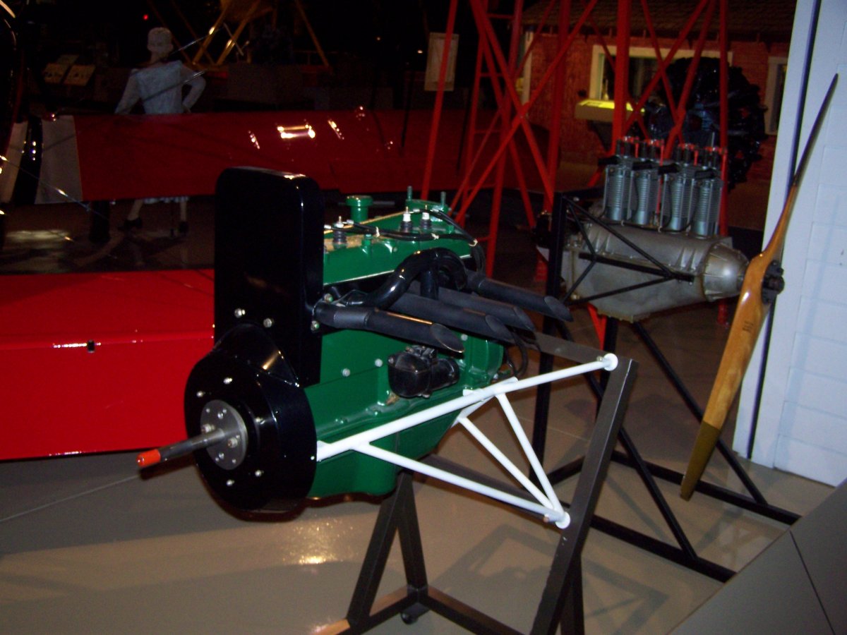

    Yes, it is at the WACO Museum.I guess I should not have been surprised to learn someone here knew what a WACO was or the anything about the museum itself.As for FUNK....there was a gent here who was able to collect a large amount of automotive iron from around Alaska and Yukon Territory. He was also an airplane pilot. So, his collecting wasn't limited to just early automotive "stuff". When the final cleanup was made an NOS Model A Ford engine surfaced that had been modified by FUNK.It now lives in a Model A pickup and runs rather well.These images are from the Experimental Aircraft ***ociation Museum(https://www.eaa.org/eaa-museum) in Oshkosh ,Wisconsin of a Model A engine that has been modified for an aero application. I don't recall if it was FUNK or other....

    Not to get too far off topic, but the Funk Brothers converted their Ford engines to run inverted. That looks perhaps more like a Pietenpol conversion.

    Although Jim posted quite bit on this thread I don't think it was his greatest area of interest.To me one indicator was a question he asked me over the phone once..."what are you trying to accomplish on the cyclecar thready?".

    I have never seen the front cowl on a Model A engine used in anything that I am familiar with. I have seen some pics of early airplanes with a similar cowl and that looks factory. Of course there have been about as many airplane manufacturers as auto in the US. Auto manufacturers seems like about 2500 different makes. Problem is we are losing all those guys that might have know what some of that stuff was. I am talking with people via Facebook to help them with solving problems these days that my mentors helped me with years ago. Oh, year. I am building an Amilcar knockoff cyclecar with a straight 8 engine. So I am still in the cyclecar thread.<grin>

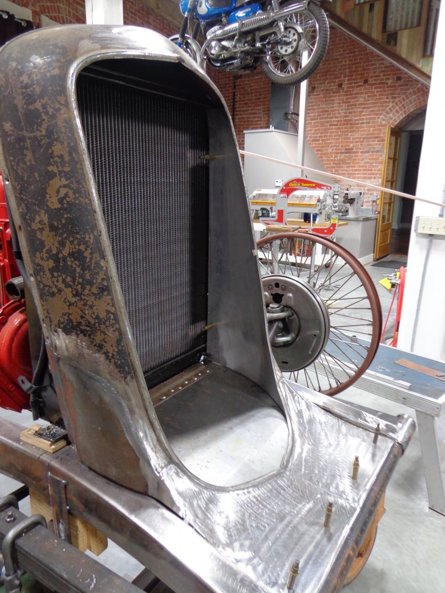

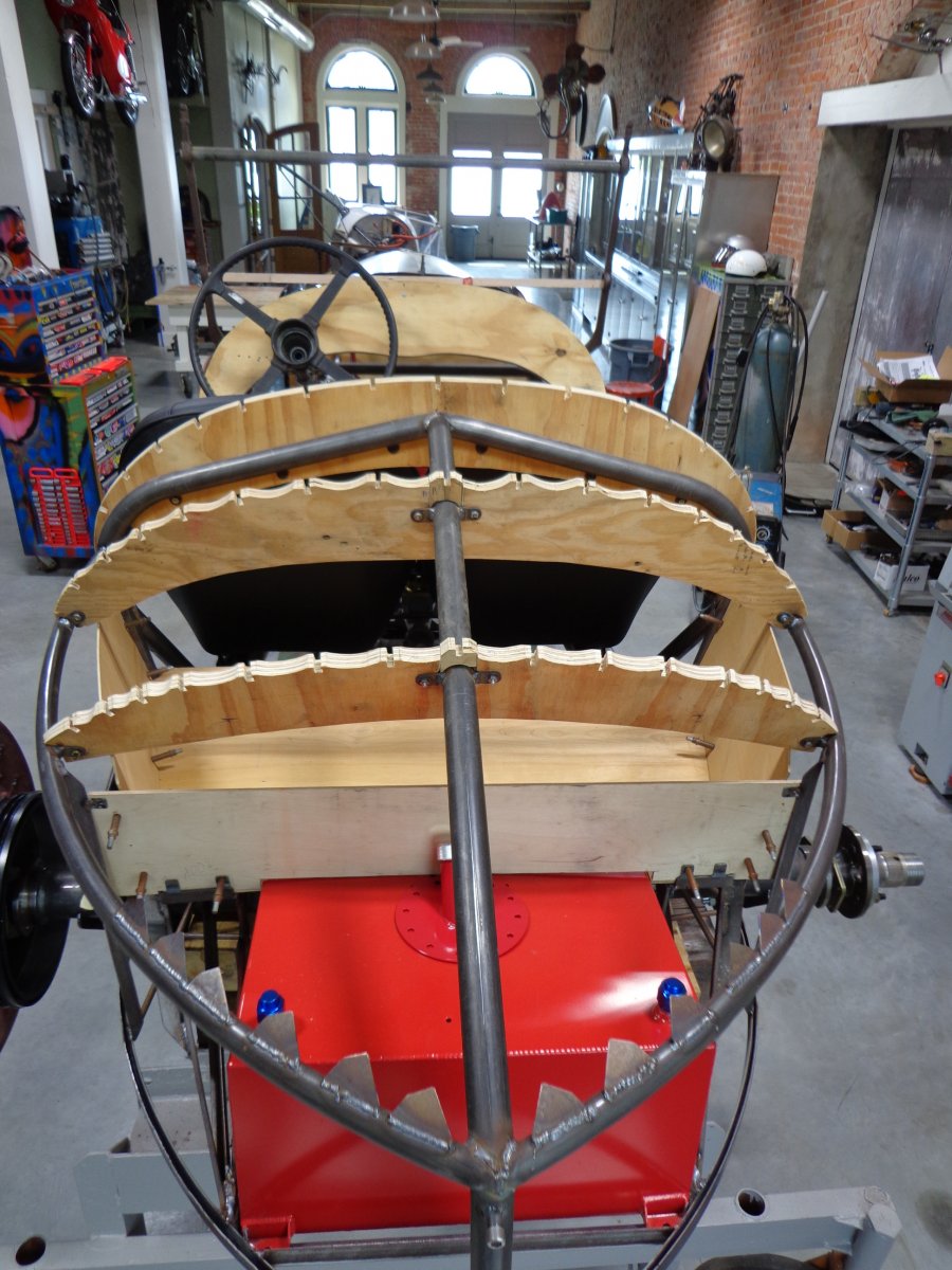

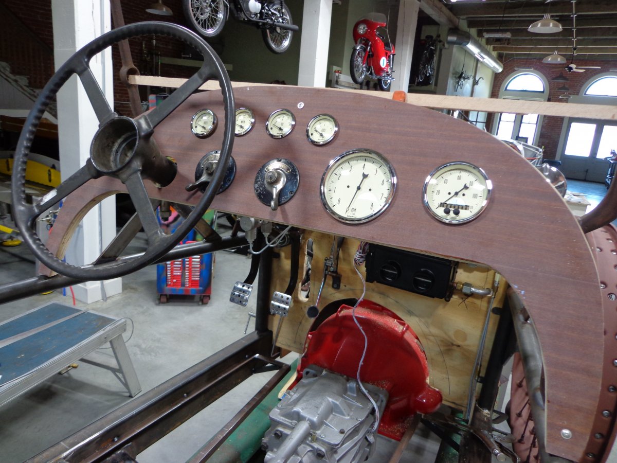

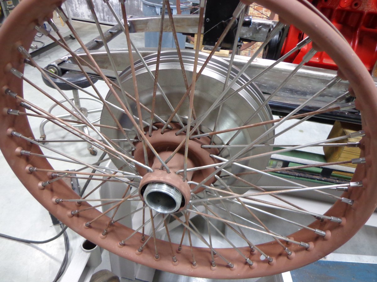

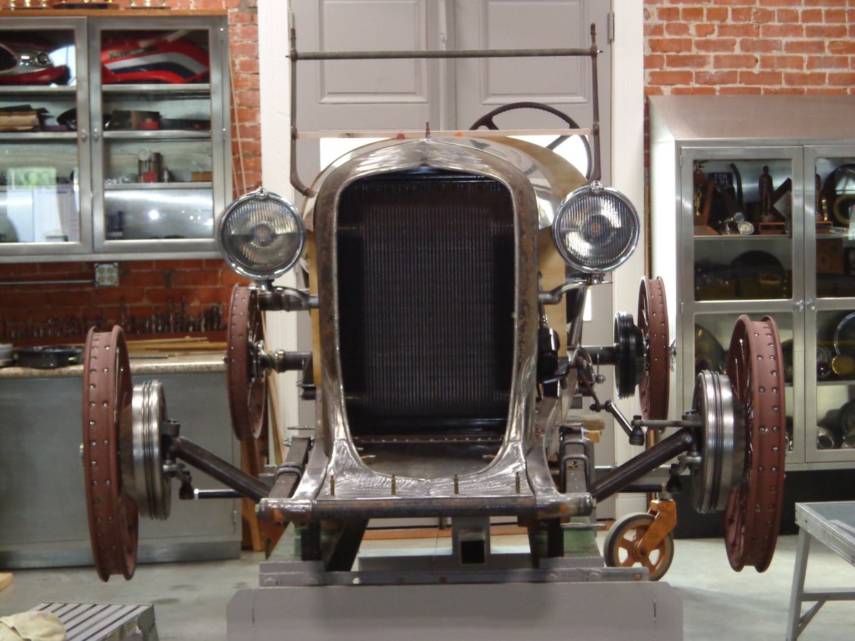

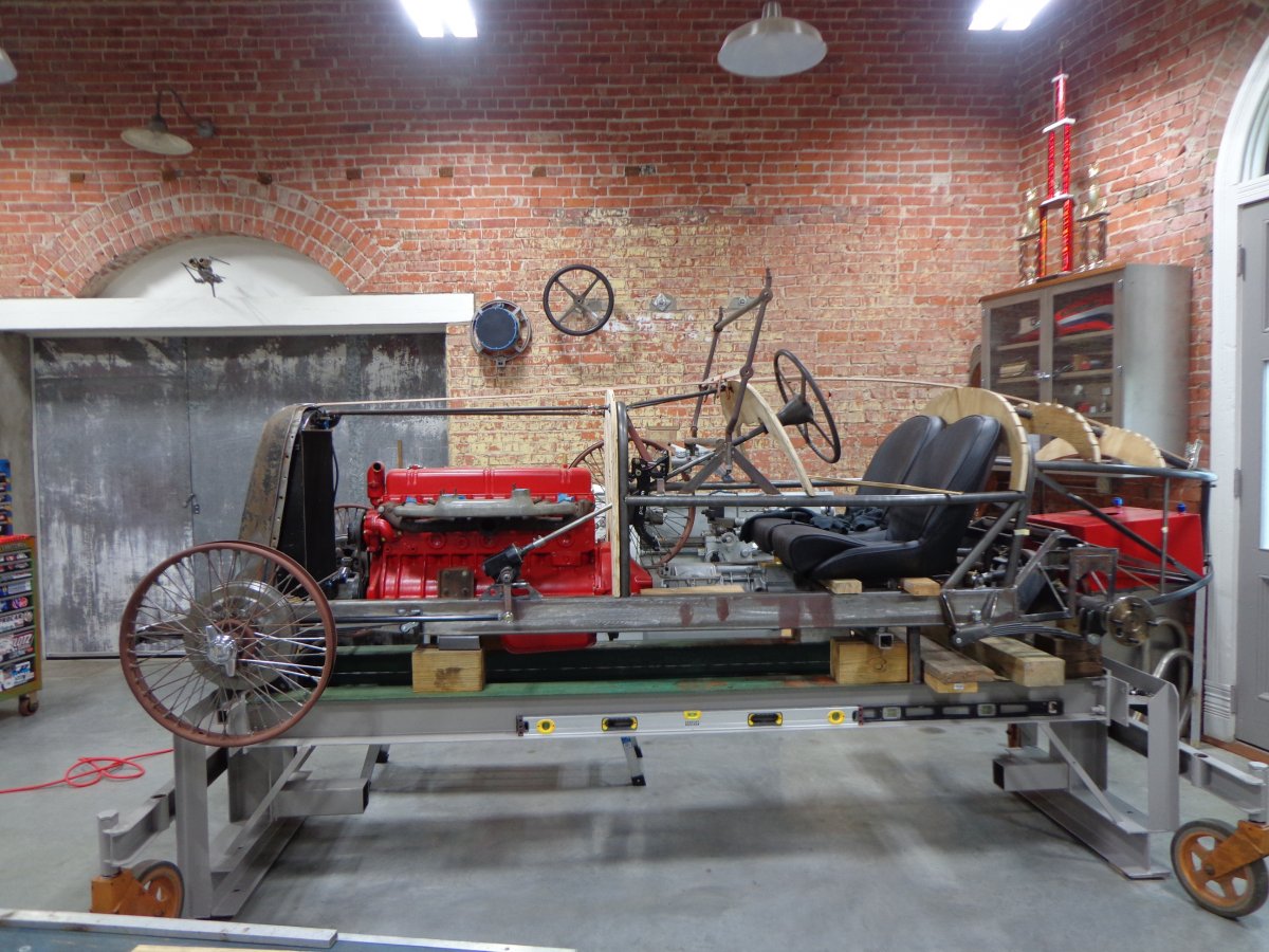

    Here are a few pics. I have the wiring harness done and getting ready to finish the body. All systems are run. Except for the ones I missed! <grin>

    That looks great. Those skinny beaded edge rims should ensure an interesting ride with all those horses up front:)

    Well, yeah! Makes an interesting ride with less horsepower! Hahahaha Thank you. Oh, and there really are not a lot of horses up front. About 150. It is a 263 but it should have some torque. And it is really smooth!

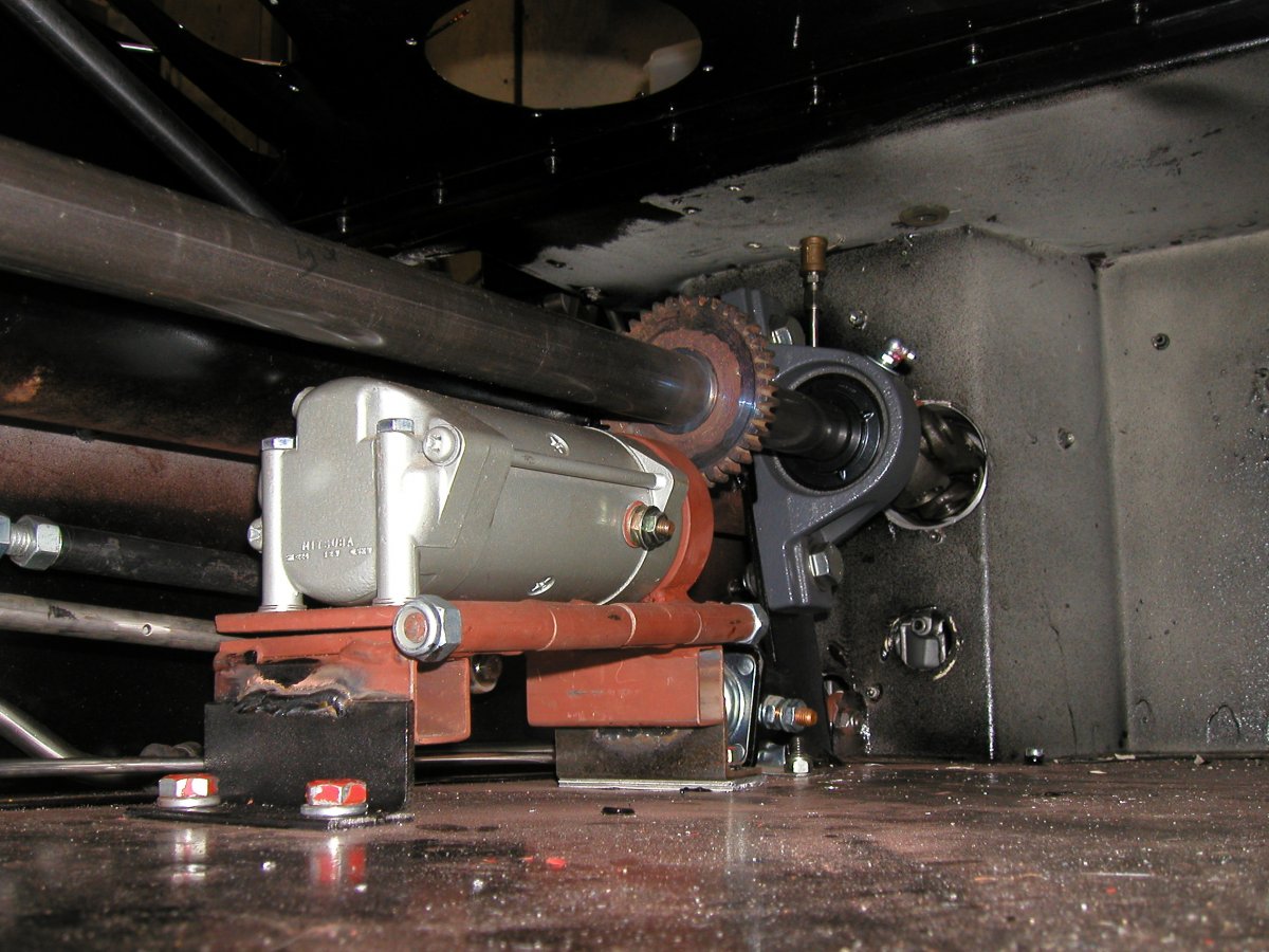

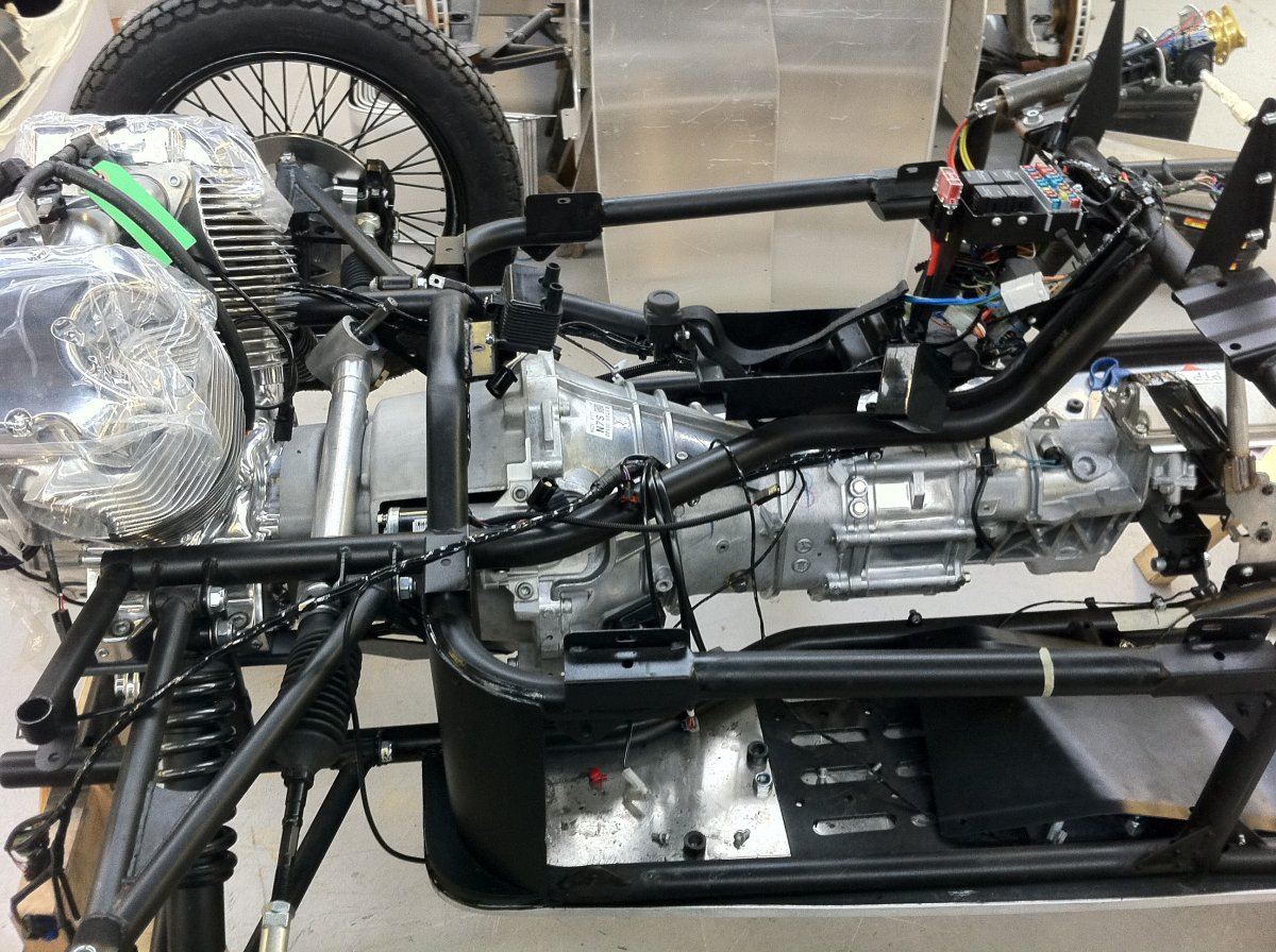

    Bike powered race cars are required to have a rev. box so a lot of work has been done in that area. There was one that had a shifting overdrive.
    My experience with my JZR, with Guzzi engine, is that first gear is quite a high ratio and I have to slip the clutch a bit to get it going. Top end is about 95 MPH. The bike would do 110, so there is your weight difference. I haven't been able to get anybody to ride with me at full speed to see what the p***enger weight difference is; LOL.
    My JZR has an electric reverse. There is a tilt plate next to the driveshaft that has a bike starter motor mounted. There is a gear welded to the driveshaft. The plate is tilted by a lever to mesh the starter gear to the driveshaft. It works quite well on level ground and is intended to just get me out of a parking spot.
